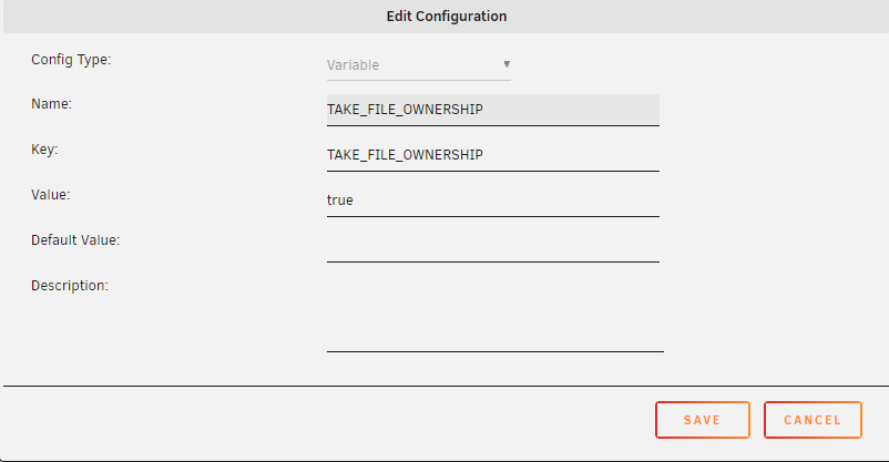

  • I fixed this by adding a variable for "TAKE_FILE_OWNERSHIP" with a value of "true":

On 8/6/2022 at 10:23 PM, j1philli said:
@wolfNZ Can you explain how you added this variable to your elastic search container?

I am using unraid 6.12.1, elasticsearch:8.8.1;
Followed @lucahammer, @buyenne suggestions, added `TAKE_FILE_OWNERSHIP` and `xpack.security.enabled`; But it don't work for me ...
  "@timestamp": "2023-08-22T08:52:24.691Z",
  "log.level": "ERROR",
  "message": "fatal exception while booting Elasticsearch",
  "ecs.version": "1.2.0",
  "service.name": "ES_ECS",
  "event.dataset": "elasticsearch.server",
  "process.thread.name": "main",
  "log.logger": "org.elasticsearch.bootstrap.Elasticsearch",
  "elasticsearch.node.name": "0c2a2d6fb5b6",
  "elasticsearch.cluster.name": "docker-cluster",
  "error.type": "java.lang.IllegalStateException",
  "error.message": "failed to obtain node locks, tried [/usr/share/elasticsearch/data]; maybe these locations are not writable or multiple nodes were started on the same data path?",
  "error.stack_trace": "java.lang.IllegalStateException: failed to obtain node locks, tried [/usr/share/elasticsearch/data]; maybe these locations are not writable or multiple nodes were started on the same data path?\n\tat [email protected]/org.elasticsearch.env.NodeEnvironment.<init>(NodeEnvironment.java:291)\n\tat [email protected]/org.elasticsearch.node.Node.<init>(Node.java:483)\n\tat [email protected]/org.elasticsearch.node.Node.<init>(Node.java:327)\n\tat [email protected]/org.elasticsearch.bootstrap.Elasticsearch$2.<init>(Elasticsearch.java:216)\n\tat [email protected]/org.elasticsearch.bootstrap.Elasticsearch.initPhase3(Elasticsearch.java:216)\n\tat [email protected]/org.elasticsearch.bootstrap.Elasticsearch.main(Elasticsearch.java:67)\nCaused by: java.io.IOException: failed to obtain lock on /usr/share/elasticsearch/data\n\tat [email protected]/org.elasticsearch.env.NodeEnvironment$NodeLock.<init>(NodeEnvironment.java:236)\n\tat [email protected]/org.elasticsearch.env.NodeEnvironment$NodeLock.<init>(NodeEnvironment.java:204)\n\tat [email protected]/org.elasticsearch.env.NodeEnvironment.<init>(NodeEnvironment.java:283)\n\t... 5 more\nCaused by: java.nio.file.NoSuchFileException: /usr/share/elasticsearch/data/node.lock\n\tat java.base/sun.nio.fs.UnixException.translateToIOException(UnixException.java:92)\n\tat java.base/sun.nio.fs.UnixException.rethrowAsIOException(UnixException.java:106)\n\tat java.base/sun.nio.fs.UnixException.rethrowAsIOException(UnixException.java:111)\n\tat java.base/sun.nio.fs.UnixPath.toRealPath(UnixPath.java:833)\n\tat [email protected]/org.apache.lucene.store.NativeFSLockFactory.obtainFSLock(NativeFSLockFactory.java:94)\n\tat [email protected]/org.apache.lucene.store.FSLockFactory.obtainLock(FSLockFactory.java:43)\n\tat [email protected]/org.apache.lucene.store.BaseDirectory.obtainLock(BaseDirectory.java:44)\n\tat [email protected]/org.elasticsearch.env.NodeEnvironment$NodeLock.<init>(NodeEnvironment.java:229)\n\t... 7 more\n\tSuppressed: java.nio.file.AccessDeniedException: /usr/share/elasticsearch/data/node.lock\n\t\tat java.base/sun.nio.fs.UnixException.translateToIOException(UnixException.java:90)\n\t\tat java.base/sun.nio.fs.UnixException.rethrowAsIOException(UnixException.java:106)\n\t\tat java.base/sun.nio.fs.UnixException.rethrowAsIOException(UnixException.java:111)\n\t\tat java.base/sun.nio.fs.UnixFileSystemProvider.newByteChannel(UnixFileSystemProvider.java:261)\n\t\tat java.base/java.nio.file.Files.newByteChannel(Files.java:379)\n\t\tat java.base/java.nio.file.Files.createFile(Files.java:657)\n\t\tat [email protected]/org.apache.lucene.store.NativeFSLockFactory.obtainFSLock(NativeFSLockFactory.java:84)\n\t\t... 10 more\n"
Error seems to suggest file permission issue.
It worked after I change the ownership and permission for the data mount
chown -R nobody:users elasticsearch/
chmod 777 -R elasticsearch/
