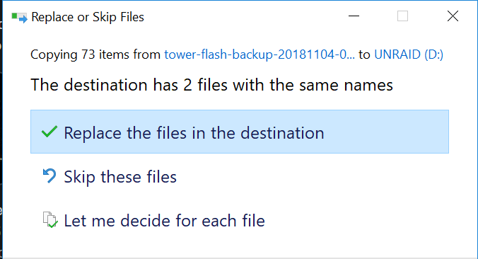

What I did is:
1) Extract the zip file (flash backup)
2) Format the USB drive in FAT32 and name it UNRAID
3) Copy/Paste the content of the extracted folder into the flash
BUT:
-) At the end of the copy/paste, I get this:
-) Then I select "Replace the files in the destination". But when I click on Makebootable, I get the following error message:

Look to see if you have a syslinux folder on the flash drive.   I have a feeling that at one point the flash backup omitted this folder.    If not extract it from the ZIP file for the releawe downloaded from the Limtech site and replace it from there.
