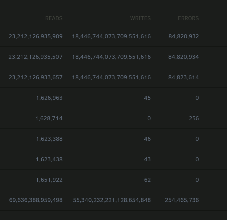

As soon as I brought the server back up after reboot from 6.6.0 upgrade I had a drive die. SMART at the time showed it had never had a failure.
I'm doing a read-check right now but some of these numbers are crazy.
I'm not sure what my next step should be.

Sep 21 22:22:31 Tower kernel: md: disk0 read error, sector=8590695320
### [PREVIOUS LINE REPEATED 1908015 TIMES] ###
Should I try rolling back to 6.5.3 for giggles and see if that does anything?
You can try rolling back but I doubt it will achieve anything.!
Whether the error reports are a side-effect of your disk4 problem I have no idea.   However Disk0 is the parity disk and the number of errors suggests it may have dropped offline for some reason.  Unraid is likely to have been trying to access it as part of the process of unmounting the ‘emulated’ disk4.

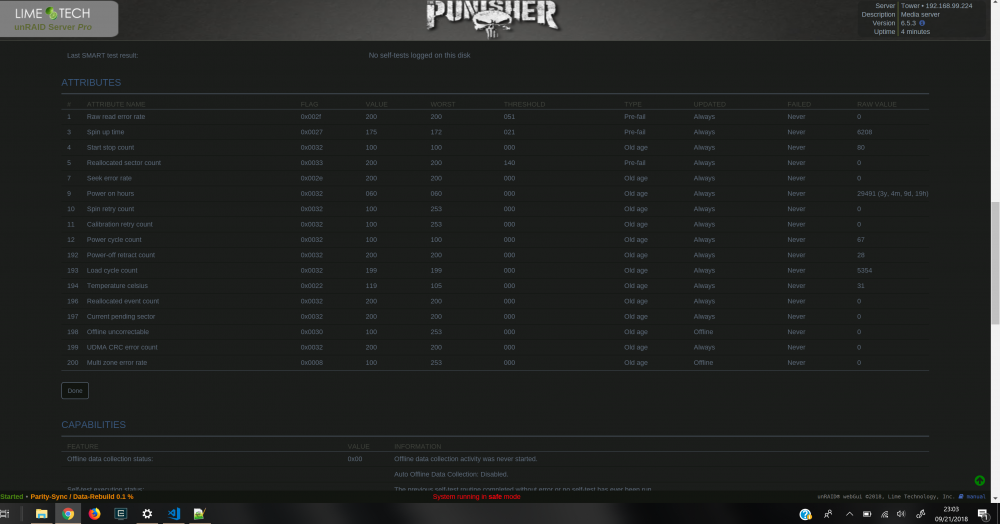

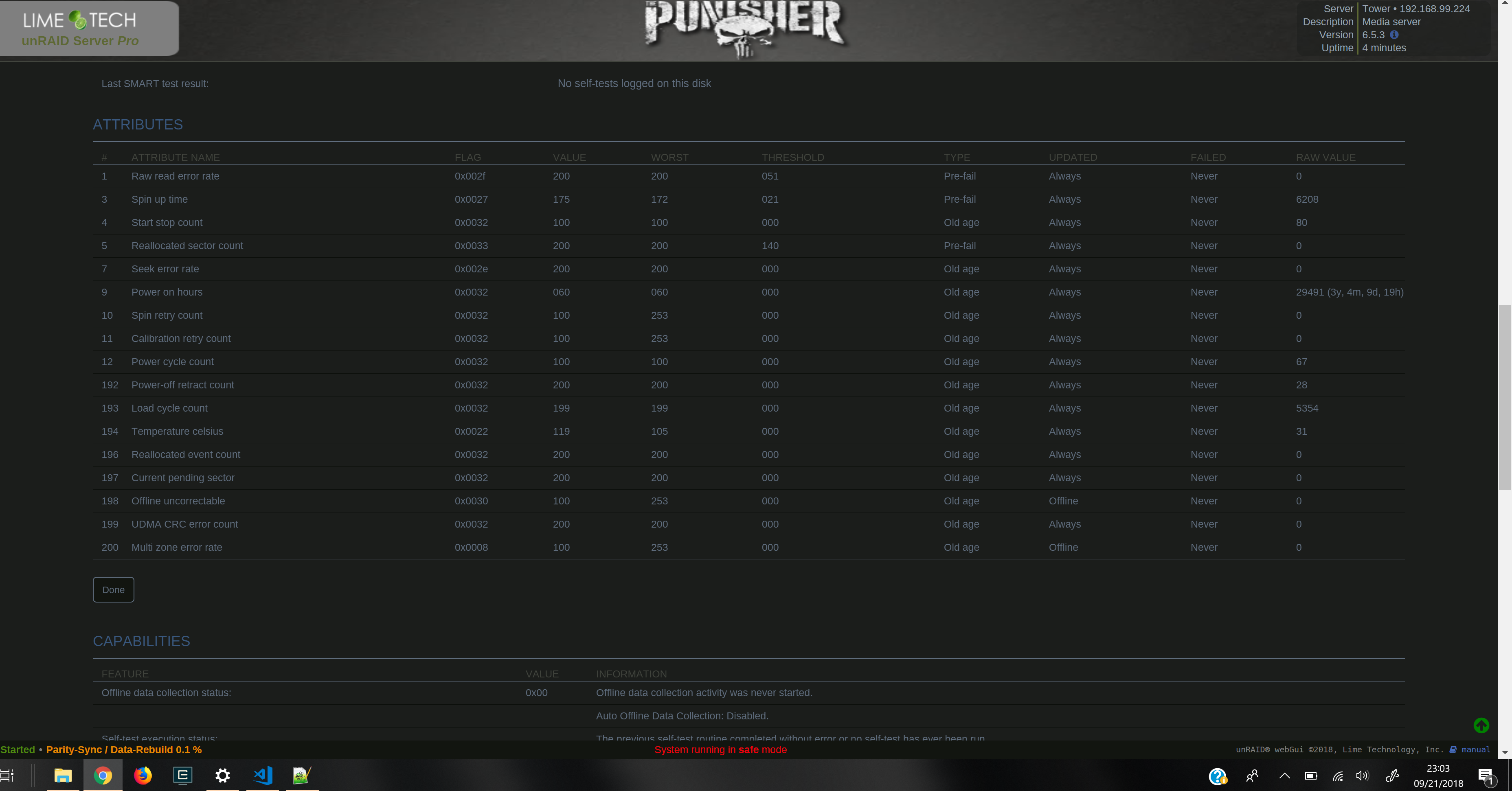

I have a SMART for old Disk4 from 15SEP?  WDC_WD30EFRX-68EUZN0_WD-WMC4N0J179UN-20180915-1502 disk4 (sdd).txt
When I tried stopping array, unmounting Disk4, starting array, stopping, then remounting.
It would run a rebuild and only get 0.5% - 2.9% of the way before erroring out and disabling the disk.
Also attached a Safe Mode snapshot of Disk4 at 2300 on 21SEP.
Starting Check Filesystem on Disk4 now.
Looks fine, doubt it's the problem.
