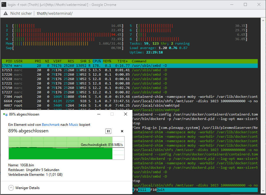

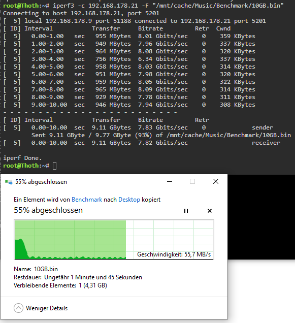

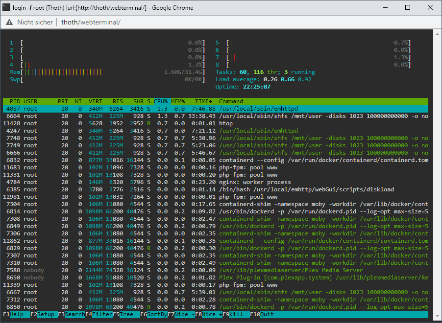

This time one of the most extreme results while downloading a file from the cache (NVME SSD). Just for fun I started a parallel iperf3 from disk (unraid, same file) to memory (windows). What is happening here?!

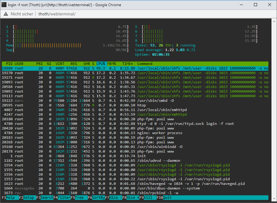

htop while transfer is running:

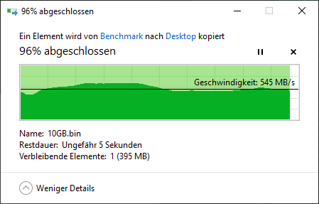

EDIT: Ok, seems to be related to "Tunable (enable Direct IO)". I reset it to "Auto" (was set to "Yes") and now the transfer is faster again:
But I'm still disappointed. As you can see iperf3 reached up to 900 MB/s. I made an additional iperf3 memory2memory test from my 10G Synolgy NAS to my windows pc:

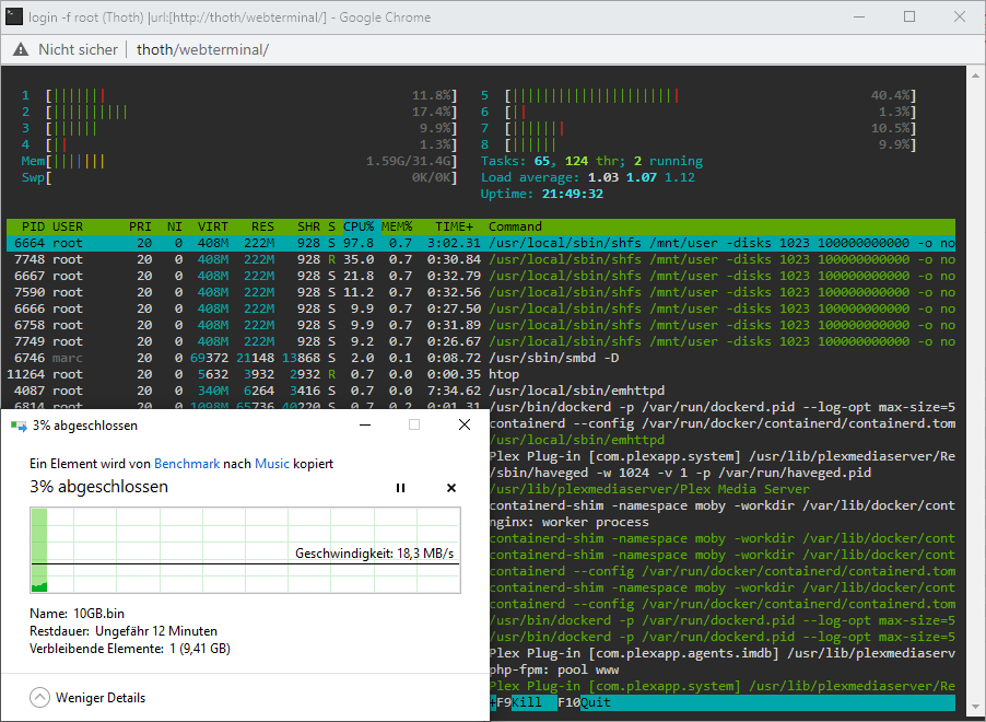

Then I started a transfer to \\tower\cache\Music

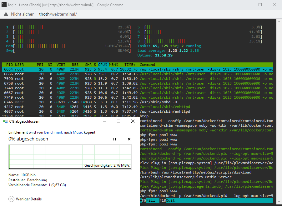

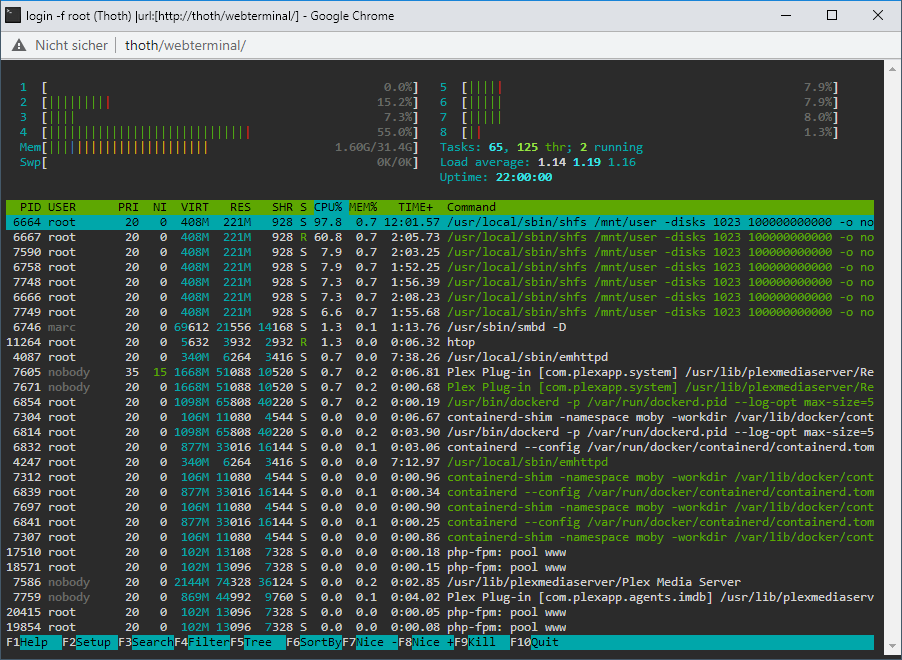

Then I realized, that the shfs processes are still producing load:
Could it be possible that enabling the disk share causes an "indexing" process or similar? I mean what is this shfs process doing? Nobody is accessing the shares and there are no IOs on the disks:
EDIT: Ok, now its becoming more interesting. After rebooting my windows pc the shfs processes are not present anymore:
Now I can re-test the direct access to the cache share. Transfer to \\tower\Music:
Transfer to \\tower\Cache\Music
So its the same as @falconexe has prooven. Writing to a share causes an extreme speeddown. Sadly I can not use this trick as enabling disk shares is a huge security breach as no user logins are needed.

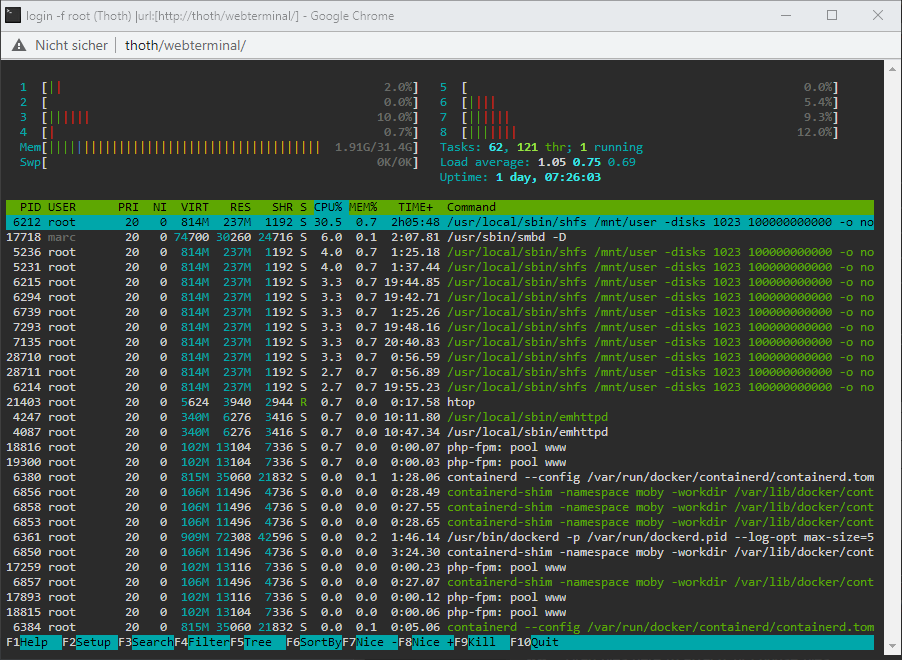

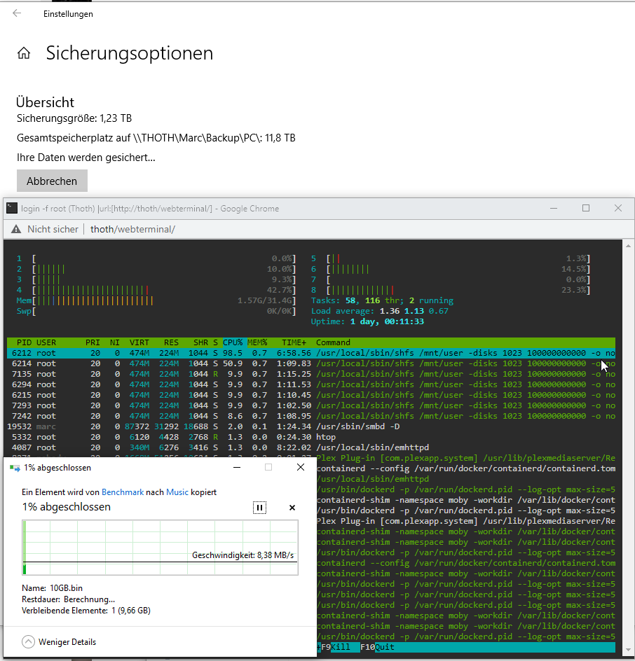

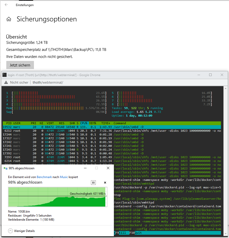

Now I need to find out why one windows pc is able to produce such a high load on the shfs processes. At the moment I guess its the Windows File History backup. Or it was the mounted NFS share. I removed today the NFS features of my windows pc. We will see if this helps.
EDIT: Ok, it must be the Windows File History. I started the backup and parallel transfering to \\tower\cache\music (to bypass the shfs process) is extremely slow:

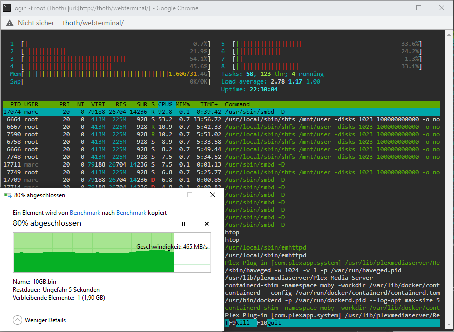

After stopping the backup:

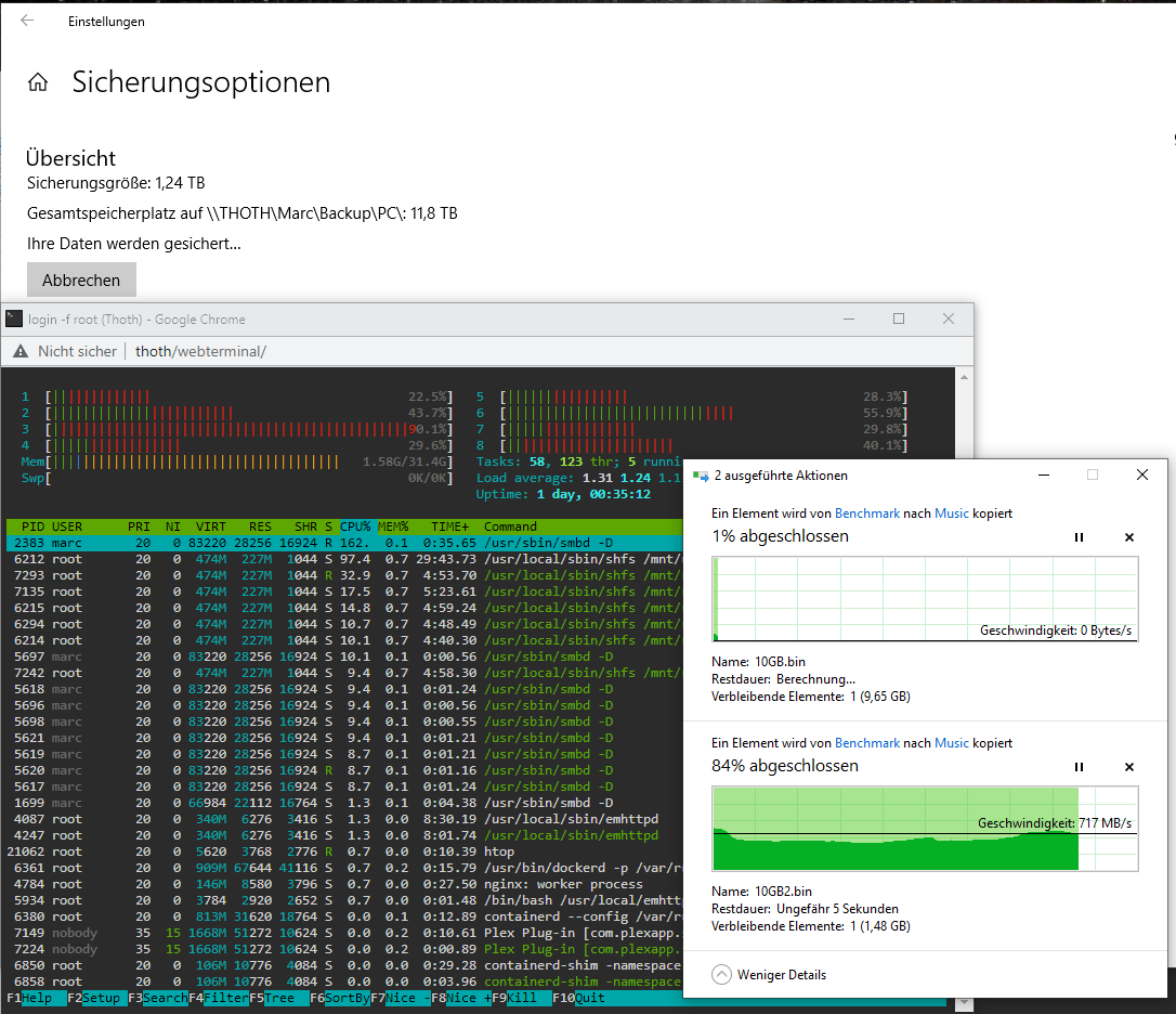

I'm using only one pc while testing. And I have new test results: Transfering to \\tower\cache\music (again bypassing shfs) is slow while backup is running, but transfer to \\192.168.178.9\cache\music with the same user credentials and same ethernet ports is fast?!
Maybe you can test this scenario as well? For me it looks like Unraid is not good at multi-threading one smb user.

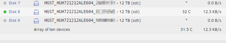

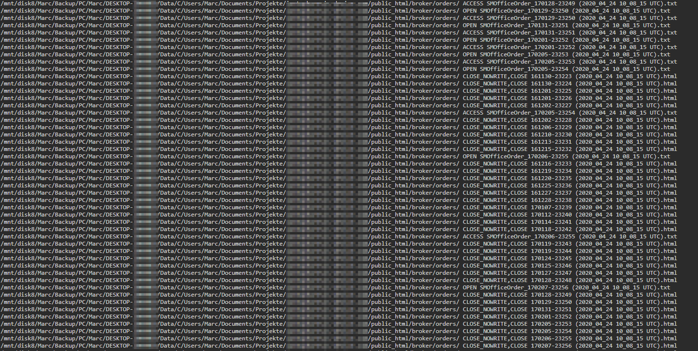

And the really bad thing is that Windows File History is active for a very long time (in my case). After copying all files it seems to compare everything as "inotifywait -mr /mnt/disk8/Marc/Backup/PC" returned an "infinite" amount of files that are accessed:
This results in very low transfer on the disk:
But it produces high CPU load on the shfs processes:
It seems Unraid has a problem with many parallel running SMB sessions (NumOpens) per SMB connection as this is the only difference between the DNS name and the IP of the server while the backup is running:

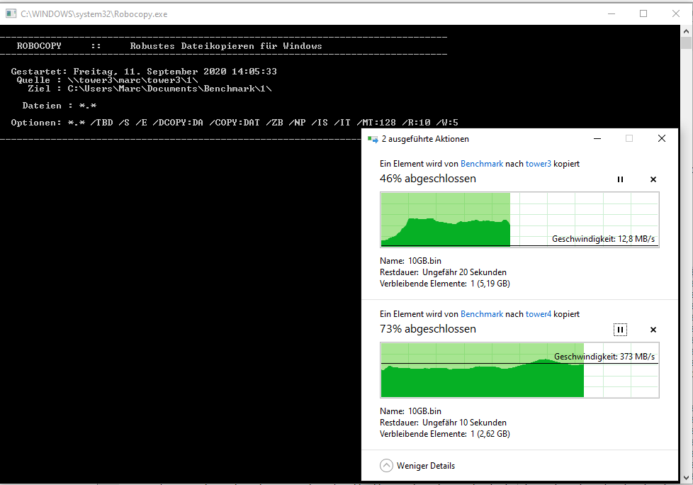

Then I copied a 10GB file to \\tower3\marc\tower3 and to \\tower4\marc\tower4 at the same time. Both parallel tranfers reached stable 300 MB/s. After 50% of the file was uploaded, I started robocopy as follows:
start robocopy \\tower3\marc\tower3\ C:\Users\Marc\Documents\Benchmark\ /E /ZB /R:10 /W:5 /TBD /IS /IT /NP /MT:128
And while the transfer to \\tower4 even rises (370 - 450 MB/s) the transfer to \\tower3 is nearly dead:
Can anyone verify my results?
