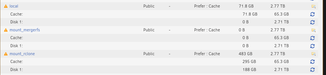

I'm having this strange issue where all the files in mount_rclone does not get deleted after upload? or am i missing something?
this are uploading, but it would seem that it doesnt get cleaned up afterwards? Maybe something someone have an answer for?
Mount: https://pastebin.com/dwKWJcuf
Upload:  https://pastebin.com/zmveVkA1
Hi all

4 minutes ago, sheldz8 said:
The txt file is corrupt
Sent from my SM-A305F using Tapatalk
I have put it on pastebin:  https://pastebin.com/wbtmhGP2
maybe it has something to do with it saying directory not empty? cannot delete
The files are being deleted after each upload so it's probably excluded files preventing it from deleting the folder.
