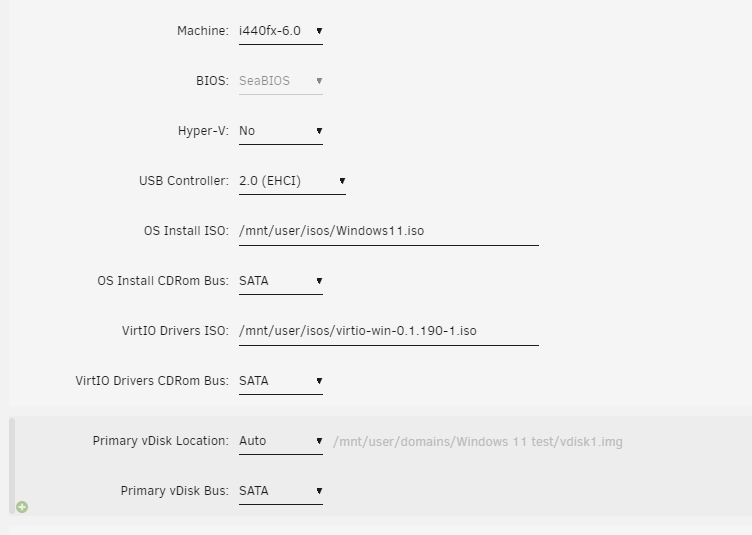

  9. Check to see if you can go there via terminal or a file manager
  10. Just try using SeaBIOS because the other day I had it on OVMF and it kept running in a loop like what is happening to you and after changing that option I managed to boot into Windows Setup for Windows 11. Typing 'exit' did nothing for me also. If that also doesn't work then it could be your CPU I tested your config on my i7 8700k and the vm loaded to Windows Setup. I have seen quite a few posts here on the forum, reddit and linustechtips where people are having issues with Ryzen 5000 series on UnRAID I keep seeing these errors with your VM's in the logs 2021-10-18 06:39:00.442+0000: 21844: warning : qemuDomainObjTaint:6075 : Domain id=1 name='Terminal One' uuid=870b08cd-bed8-e8d9-fd8d-0747c71c7acd is tainted: high-privileges 2021-10-18 06:39:00.442+0000: 21844: warning : qemuDomainObjTaint:6075 : Domain id=1 name='Terminal One' uuid=870b08cd-bed8-e8d9-fd8d-0747c71c7acd is tainted: host-cpu 2021-10-18 06:40:08.869+0000: 21842: warning : qemuDomainObjTaint:6075 : Domain id=2 name='Terminal One' uuid=870b08cd-bed8-e8d9-fd8d-0747c71c7acd is tainted: high-privileges 2021-10-18 06:40:08.869+0000: 21842: warning : qemuDomainObjTaint:6075 : Domain id=2 name='Terminal One' uuid=870b08cd-bed8-e8d9-fd8d-0747c71c7acd is tainted: host-cpu 2021-10-18 06:43:04.915+0000: 21844: warning : qemuDomainObjTaint:6075 : Domain id=3 name='Windows 10' uuid=26c75bbb-8f3d-f50f-55b6-e3ebd79e2c2f is tainted: high-privileges 2021-10-18 06:43:04.915+0000: 21844: warning : qemuDomainObjTaint:6075 : Domain id=3 name='Windows 10' uuid=26c75bbb-8f3d-f50f-55b6-e3ebd79e2c2f is tainted: host-cpu 2021-10-18 06:47:29.539+0000: 21843: warning : qemuDomainObjTaint:6075 : Domain id=4 name='Windows 10' uuid=5e95f5ec-f371-fe9a-7fb9-fdc7bdf485d4 is tainted: high-privileges 2021-10-18 06:47:29.539+0000: 21843: warning : qemuDomainObjTaint:6075 : Domain id=4 name='Windows 10' uuid=5e95f5ec-f371-fe9a-7fb9-fdc7bdf485d4 is tainted: host-cpu If I am correct then it looks like the Host CPU isn't correctly passing through to the VM's.
  11. Last time i received this error it was because of either: 1) corrupt iso file or 2) wrong bios option selected. (Try SeaBIOS) and maybe change all drives to use SATA
  12. Follow this guide you just need to edit your VM settings shown in the post. If you want me to share my modified iso link I can https://forums.unraid.net/index.php?/topic/114471-Windows-10-VM-missing-Secure-boot-and-TPM-for-Windows-11-upgrade&do=findComment&comment=1044181 It's better than messing with unraid settings Sent from my SM-A305F using Tapatalk
  13. download windows 11 https://uupdump.net/ then use dism to edit the index files for \sources\boot.wim to use LabConfig.reg create a bootable iso using ImgBurn https://download.imgburn.com/SetupImgBurn_2.5.8.0.exe to do a clean install. Make sure your VM settings are like below If you want to do a upgrade instead then use BypassTPMorCPU.ps1
