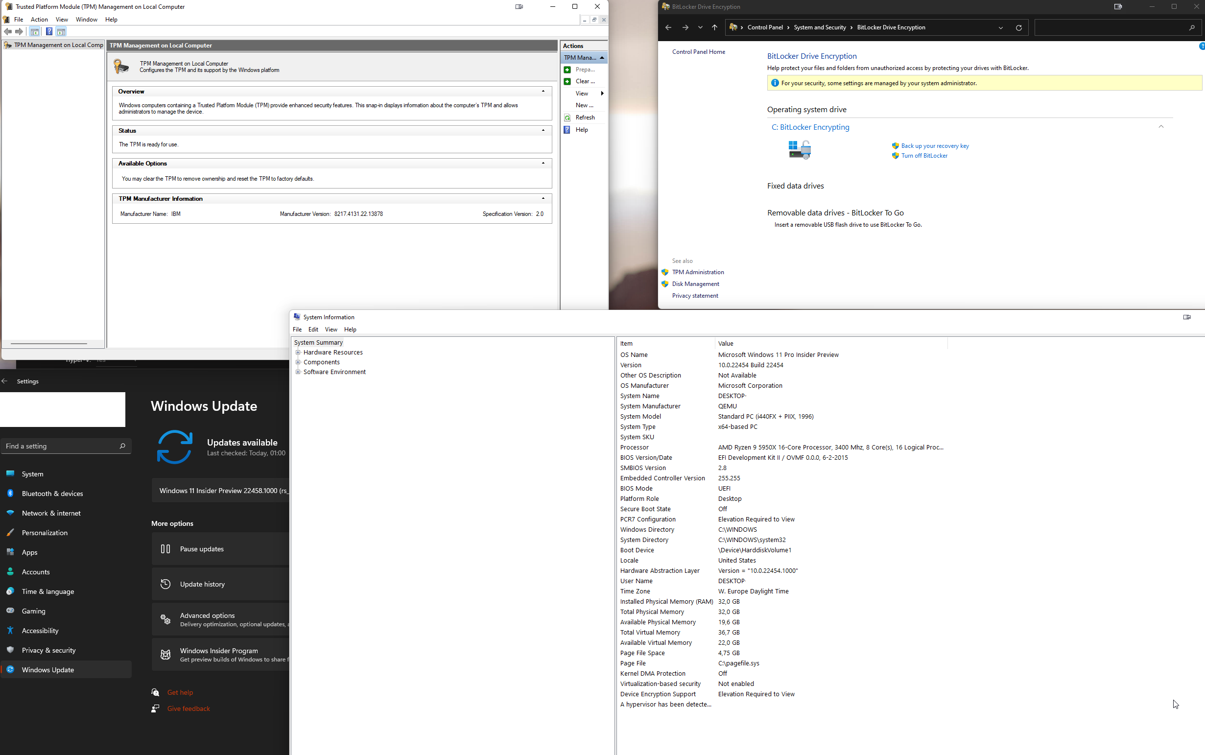

October 4, 20215 yr On 9/17/2021 at 7:28 PM, okkies said: I got TPM and secure boot working trough this guide https://www.linkedin.com/pulse/swtpm-unraid-zoltan-repasi/ TYVM. Retail ISO is out, just updated my win10 vm to win11 final no problem after getting TPM emulation working per the guide. I'm on Unraid 6.9.1.

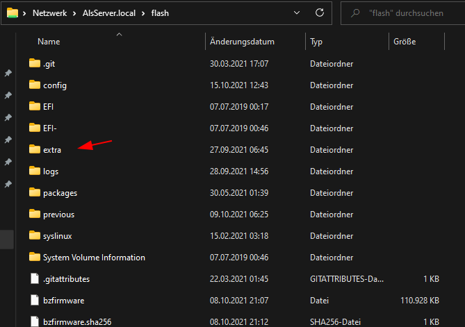

October 15, 20215 yr seems like I don't have the extra folder in /boot/ Did you guys create this folder manually? And if so, how? I am using Cloud Commander as primary file manager on my host, but seems like this container has no permissions to create a new folder in /boot/. Any advise? I am running 6.10 RC1 Thanks!
October 15, 20215 yr seems like I don't have the extra folder in /boot/ Did you guys create this folder manually? And if so, how? I am using Cloud Commander as primary file manager on my host, but seems like this container has no permissions to create a new folder in /boot/. Any advise? I am running 6.10 RC1 Thanks! Follow this guide you just need to edit your VM settings shown in the post.If you want me to share my modified iso link I canhttps://forums.unraid.net/index.php?/topic/114471-Windows-10-VM-missing-Secure-boot-and-TPM-for-Windows-11-upgrade&do=findComment&comment=1044181It's better than messing with unraid settingsSent from my SM-A305F using Tapatalk

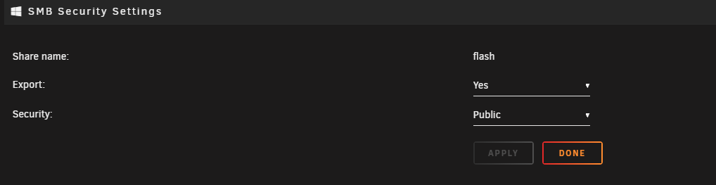

October 15, 20215 yr 21 minutes ago, doesntaffect said: Any advise? I am running 6.10 RC1 as it seems you prefer GUI etc ... in the unraid main tab, click the Flash Drive, enable as SMB share then create your folder ... but i still would suggest to wait until @limetech finally releases its RC2 including the changes ...
