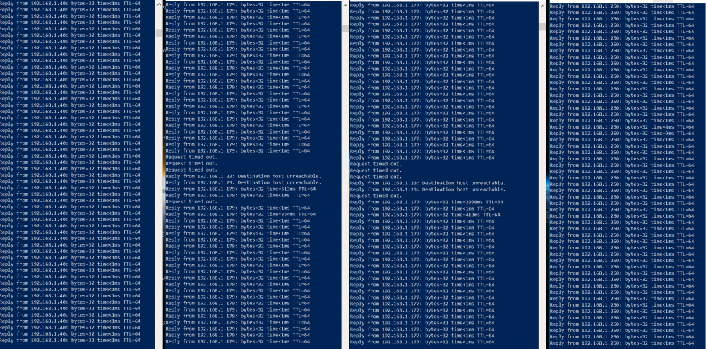

My Unraid installation seems to have a problem with its networking. I can ping any of its IP's ( has 2 onboard gb ports and 2 gb ports on an intel card)
What seems to be happening is that Unraid drops its network for a few seconds and then picks up again.
I have attached a snip of the event...1.40 is the IPMI port on the motherboard which appears unaffected, 1.250 is a separate device on the same switch as a control to prove the issue is not with the network hardware/cabling 1.179 and 177 are the connected ports to the Unraid server.
I'm at a loss as to where to go with troubleshooting this...Unraid is latest version....all been cold booted etc....
I do see this line in the log but have no idea as to its relevance...
kernel: net_ratelimit: 259 callbacks suppressed
Also I can reproduce the error if I ping a VM on the unraid box!
Hoping someone out there might be able to suggest a possible way forward!

The issue is that the pings were dropping on a single network connection to the server...I then added a dual nic in an attempt to isolate the problem...179 is the original interface, what seems to be happening is that pings drop on both interfaces to unraid but the IPMI port remains stable which suggests that the issue is within unraid rather than the server hardware. I'm pretty sure this isnt a config issue since the problem pre-dates the second Nic. I'm trying to isolate the issue and I'm reasonably sure that, given the stability of everything not connected directly to Unraid, somewhere in there is the source of the problem..Given my inexperience with Unraid is there a way to preserve my VM's/plugins/configs etc and reload the core software?
