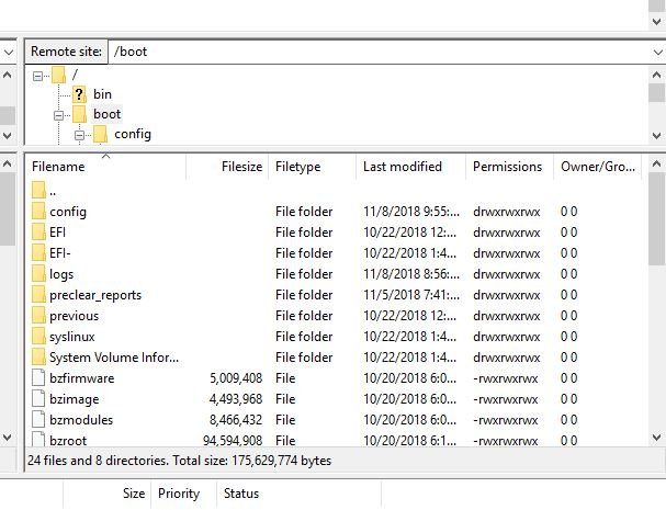

when i use filezilla  and then there is the boot folder for the flash

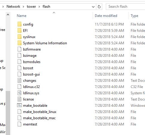

well  i only have 1 Flash share in windows  when you install Unraid.. it automaticlly gives you a flash share
and i alter the go file from the config folder that does nothing

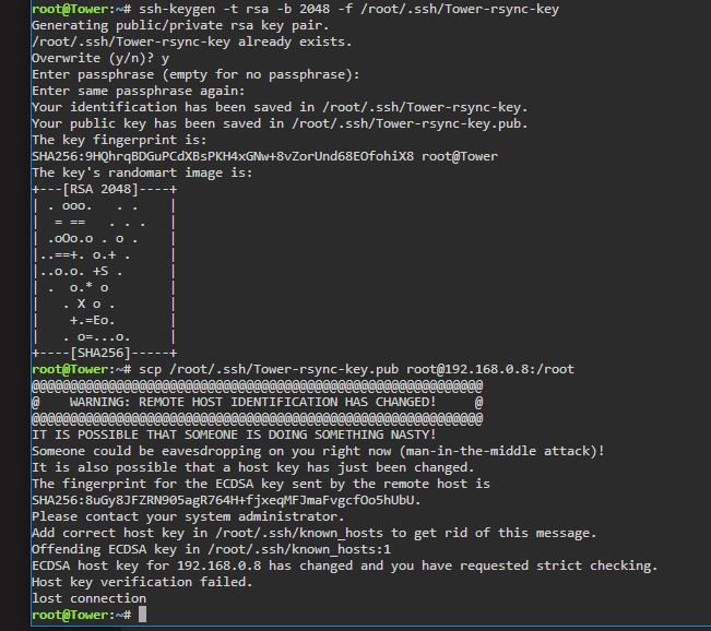

well i tried to make new ssh file  etc  and i send it and i get this error...
how do i repair this rsync
@    WARNING: REMOTE HOST IDENTIFICATION HAS CHANGED!     @
IT IS POSSIBLE THAT SOMEONE IS DOING SOMETHING NASTY!
Someone could be eavesdropping on you right now (man-in-the-middle attack)!
It is also possible that a host key has just been changed.
The fingerprint for the ECDSA key sent by the remote host is
SHA256:8uGy8JFZRN905agR764H+fjxeqMFJmaFvgcfOo5hUbU.
Please contact your system administrator.
Add correct host key in /root/.ssh/known_hosts to get rid of this message.
Offending ECDSA key in /root/.ssh/known_hosts:1
ECDSA host key for 192.168.0.8 has changed and you have requested strict checking.
Host key verification failed.

The flash share in Windows is your unRAID usb drive.  Definitely do not delete that.  If you delete the contents of the flash share, you will wipe out everything on the unRAID flash drive.  If you are working with WIndows, it sees the USB flash drive as the folder called flash.
/boot simply refers to the root of the flash drive as that is how unRAID mounts the volume.  If you are working from the command line, /boot is how you reference the flash drive.
If from the console or terminal session you type 'cd /boot' and the list the contents you will see exactly what you see when you open the flash share in Windows.
The Go file is in the /config folder at the root of the flash share.
You do not need to be using Filezilla to edit anything.  In fact, it is totally unnecessary in this process.

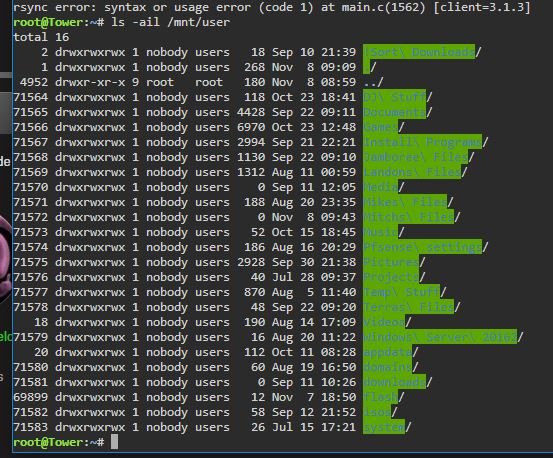

Might be best if you post the output of
ls -ail /mnt/user
This will show all your shares.  Odds on, you've somehow created a share called "Flash" which is conflicting with the unRaid share called flash.  Windows does really funky things with identically named shares and with similarily named shares only differing by upper/lowercase.

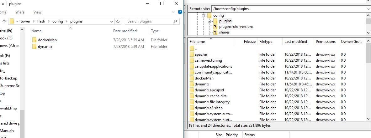

and why are all the plugins hidden  if i use filezilla  i see the plugins  and all these extra files...  i use windows goto the flash  same location no files
its like Flash folder has like 100 files and the Boot location has like 200 files
why are they soooo different???  files i make in Terminal dont show up in Flash
and here is that image squid askedunraid3.JPG.ed2abe32471ce2879889afa49950202d.JPG
see you can see why i confused  if Flash and boot the same why they different
To unconfuse the issue initially,
mv /mnt/user/flash /mnt/user/notflash
This will rename the flash share to be notflash.  This will stop Windows from continually having a hissy fit as to what's going on.  As to how it got created in the first place, it was something that you did or misconfigured a backup or something.
so like i was saying  if i make a folder called logs\cron  in windows on left side.. it doesnt show up on the right side
and user script doesnt like that  says file area doesnt exisit
but if i make the folder in the right side above  it doesnt show up on the left side (windows )  side  but the user script sees the folder logs\crons

and is there a command to fix the rsync  as i deleted the ssh folders to try to fix the password issue
soo  renamming flash didnt help  still cant get it to work i ran the make a new ssh and to copy it to backup server but its not working
