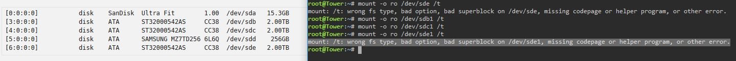

OK thank you for replying so quickly. I am not a Linux guy so can I ask a noob question?
- open terminal
- type: mkdir /x (you say replace X with the correct drive letter. What is the correct letter or can I use any? e.g. mkdir /t)
- you say then type: mount -o ro /dev/sdX1 /x (I looked at the list of drives and they are listed as sdb, sdc and sde. what is the 1 for in you example?)
So I typed the following:
mkdir /t
mount -o ro /dev/sdb /t
I got a reply saying:
mount: /t: wrong fs type, bad option, bad superblock on /dev/sde, missing codepage or helper program, or other error.
This happens when i use sdb, sdc and sde
Edited by FingerSuicide
You just need to replace the device X not the dir x, but I understand the confusion, you can use any name for the mount point.
You're missing the 1, it should be sdb1
So I added the 1 and sdb1 and sdc1 both seem to complete with no error.
Then sde1 says: mount: /t: wrong fs type, bad option, bad superblock on /dev/sde1, missing codepage or helper program, or other error.
