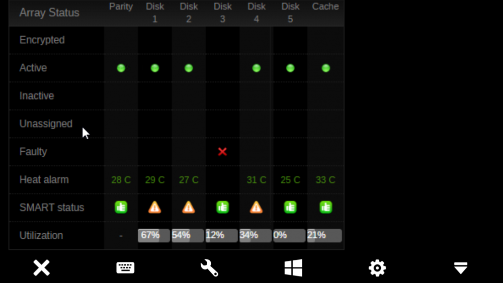

I have a drive that's being emulated because it's failing, and 3 others with smart errors. My junk is falling apart. I tried to fix that yesterday, but I think I made it so much worse.

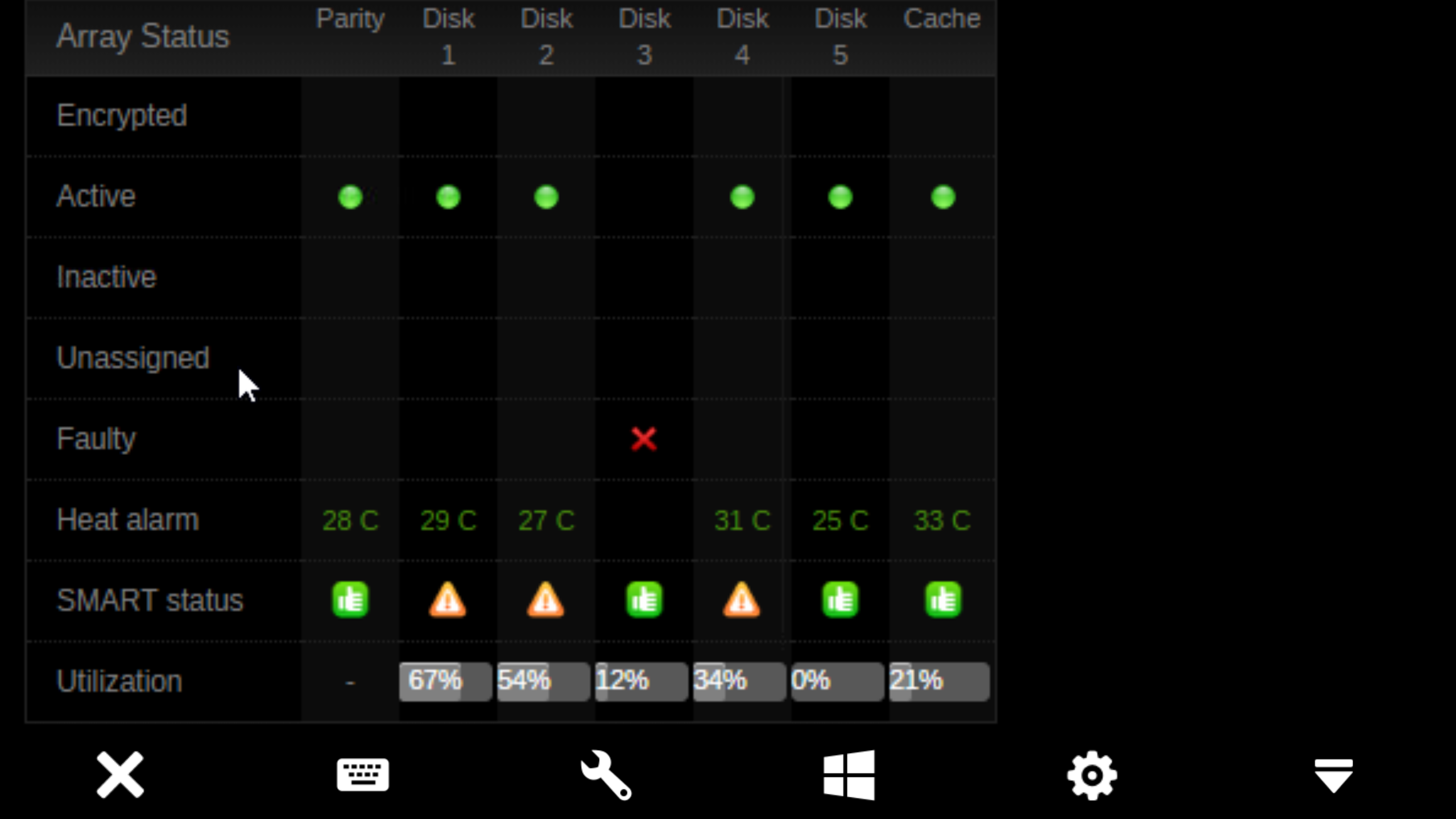

Your first screenshot is showing warning indicators on 3 additional drives besides the disabled one, so possibly many things going wrong besides just the disabled disk. None of that should prevent you from logging in though so probably some corruption on flash as well.

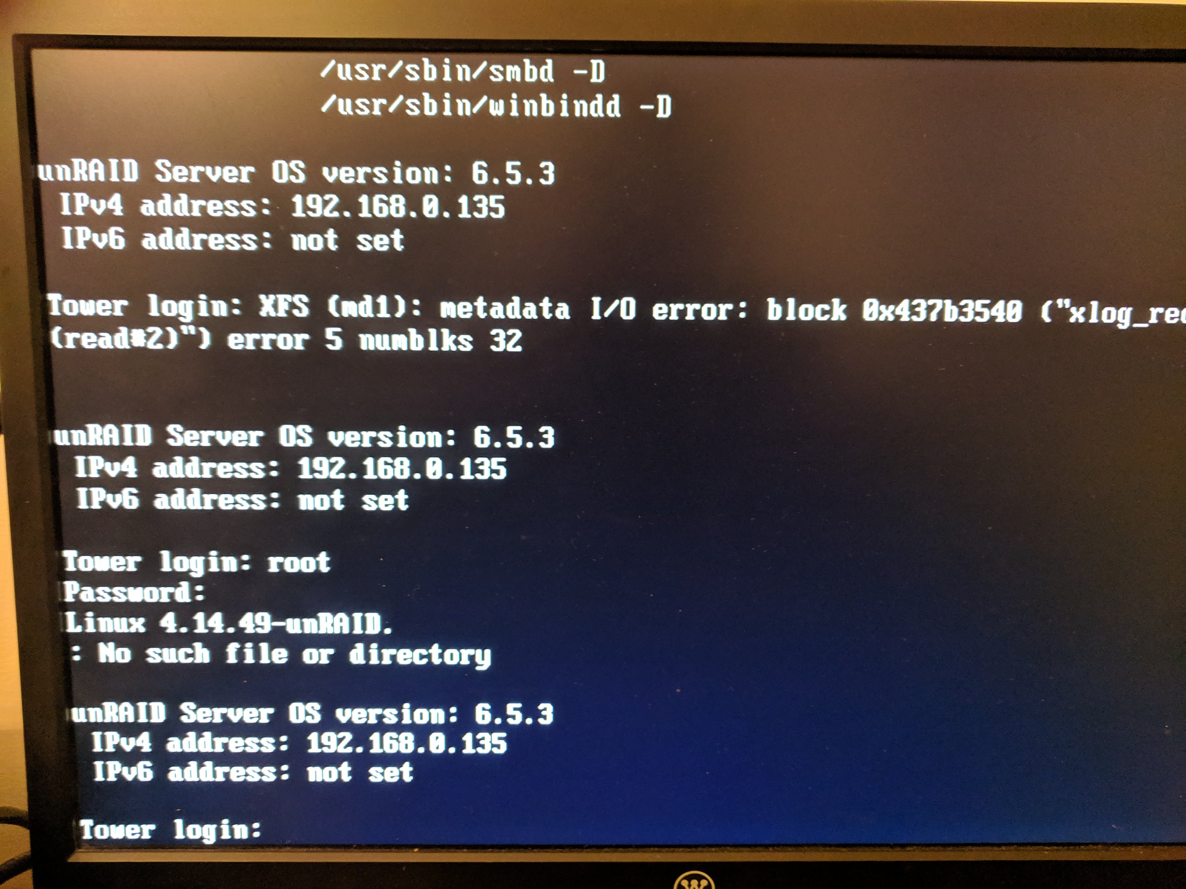

When I tried to log into the webUI (chrome) it returned an error connection refused. When I try to log into the machine itself I get the second picture. "No such file or directory" and another login prompt. I'm at work now, I'll type up the full story when I go to lunch.
That sounds like corruption of the passwd file, as seen in another couple of threads recently. You say that you re-created your boot flash from scratch but used a backup of your config folder? Please go to the backup and post the file called passwd from inside the config folder. It won't give any passwords away!

The line for the root user in the passwd file should look like this:
root:x:0:0:Console and webGui login account:/root:/bin/bash
Sorry, I've just re-read your OP and you don't explicitly mention a backup of your config. So get the passwd file directly from the config folder on your flash. You'll have to move it to a PC to read it.
