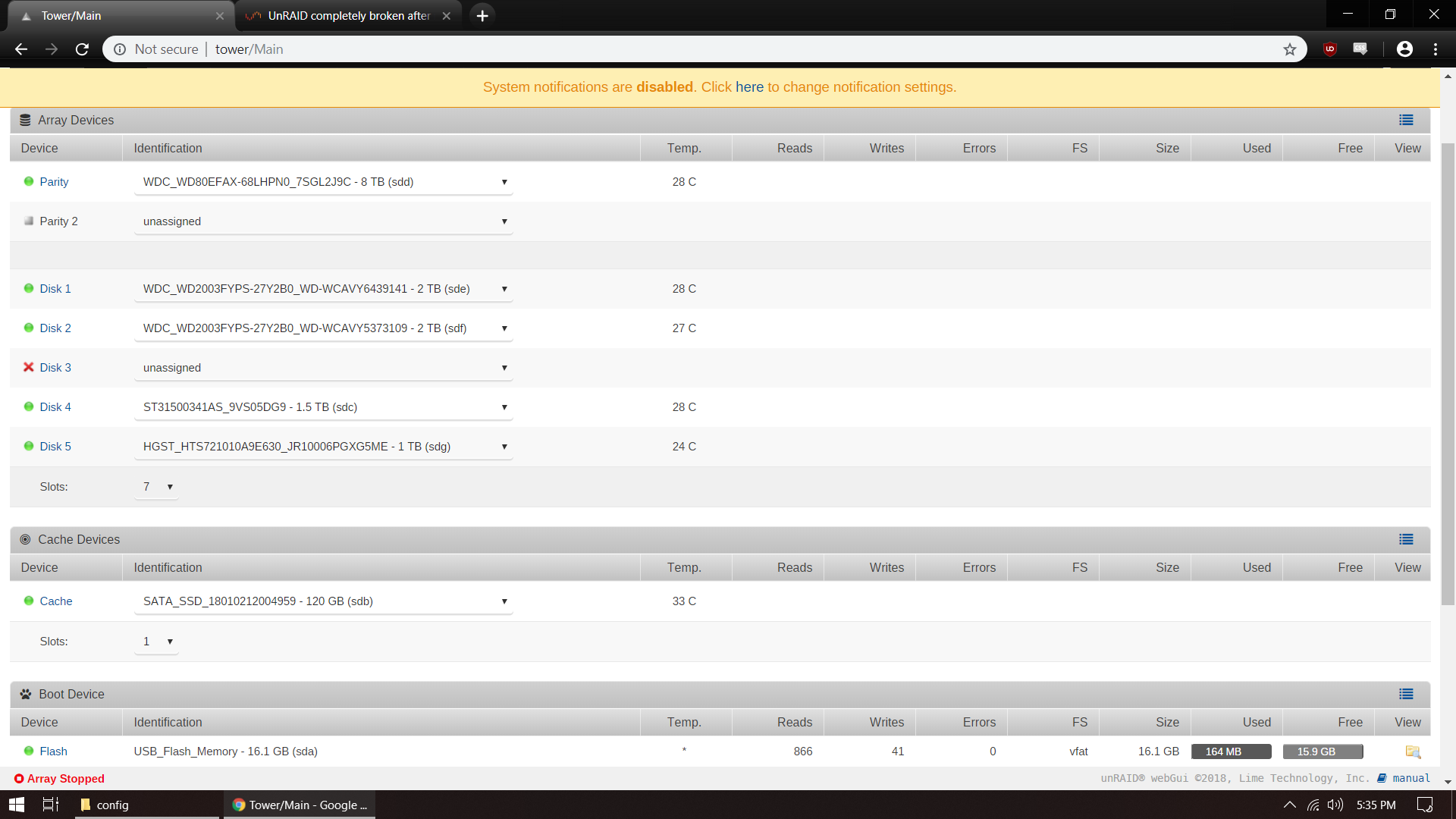

3 hours ago, trurl said:
I think if you can boot with that we may be back to the missing disk emulated.
Progress!
I'm guessing that my next step should be starting the array and copying everything on disk 3 to my PC since I have room? (2.5tb free on my desktop)
Just now, Pyro said:
Progress!
I was just about to ask for a screenshot. Looks good!
Yes start the array and copy the emulated disk3 to your PC.

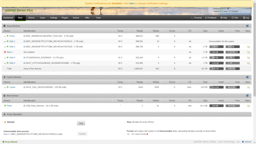

Small problem...
WDC_WD2003FYPS-27Y2B0_WD-WCAVY6439141 - 2 TB (sde) (Disk 1) shows unmountable, no file system.
1 hour ago, Pyro said:
Small problem...
We can deal with that separately later. Can you get the files on the emulated disk?
Give me a screenshot. And whatever you do don't agree to FORMAT anything.
Also good to post diags to see why the disk isn't mounting.

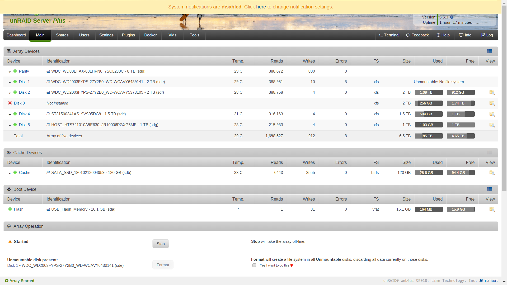

Yes, I am copying disk3 now. 3 failed files so far, all replaceable. 37% and counting. Definitely not going to format anything.
Here's the screen, and diagnostics.
tower-diagnostics-20181128-1552.zip
Disk1 is failing, so some files will fail to copy, copy what you can for now.
So is disk2, I posted the SMART on the other page before we got his disk assignments back. But its all we have to work with to try to get the data for the unresponsive disk3.
Yes, OP should try to copy what it can from the emulated disk3 first, with some luck disk2 is OK for now since last read errors on the SMART report are from a long time ago, and some times WD disks report false pending sectors, if not disk2 together with disk1 are good candidates for ddrescue after disk3 copy is done, disk1 will need a filesystem check but that can only be done after it's cloned to a new disk, since xfs_repair would abort on a read error.
