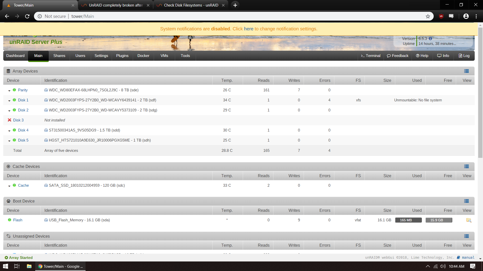

If I'm understanding the unraid xfs_repair wiki correctly, I should start the array in maintinance mode (screenshot) and type this into the terminal:
xfs_repair -v /dev/dse1
Is this correct?
I do apologize for the pile of questions, I'm a novice at best and don't want to screw anything up even more.
11 minutes ago, Pyro said:
Is this correct?
No. There is no such thing as /dev/dse1 - you have mistyped. Also /dev/sde is your parity disk so that isn't right either. Look under the Unassigned Devices section that you cut off in your screen grab to find the correct device. It's probably /dev/sdb1 but I can't see it so I can't be sure.
Edited by John_M
No need since the disk is unassigned, it just can't be mounted in UD, and like John_M mentioned check there for the correct identifier.
Ok, so sde is my (currently useless) parity, but it's also the disk I cloned sdf to. I should have the array stopped, and run:
xfs_repair -v /dev/sde1
Am I getting closer?
sdb is the 10tb that will become my new parity, but it's unformatted.
Edited by Pyro
derp
You didn't unassign it from the parity slot before cloning onto it?
On 12/1/2018 at 12:06 AM, johnnie.black said:
Any unused new disk, outside the array, same or larger capacity.
The concern I have is that your screenshot shows 7 writes to it, which will have added to the corruption. Stop the array and unassign it.
Otherwise, you have the xfs_repair command correct. You might want to consider re-doing the clone, but you might as well run xfs_repair first and see if it allows you to mount the disk in Unassigned Devices.

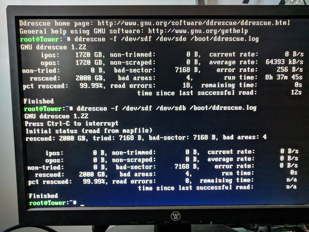

Alright, I guess I'll go ahead and clone disk 1 again to sdb 10tb since sde is likely to fail anyways.
Yes, do that but leave sde untouched for now in case the old disk 1 fails completely during the cloning process. You might be able to get something off of it if all else fails.
Uh... It happened instantly? This seems off. What did I screw up?
