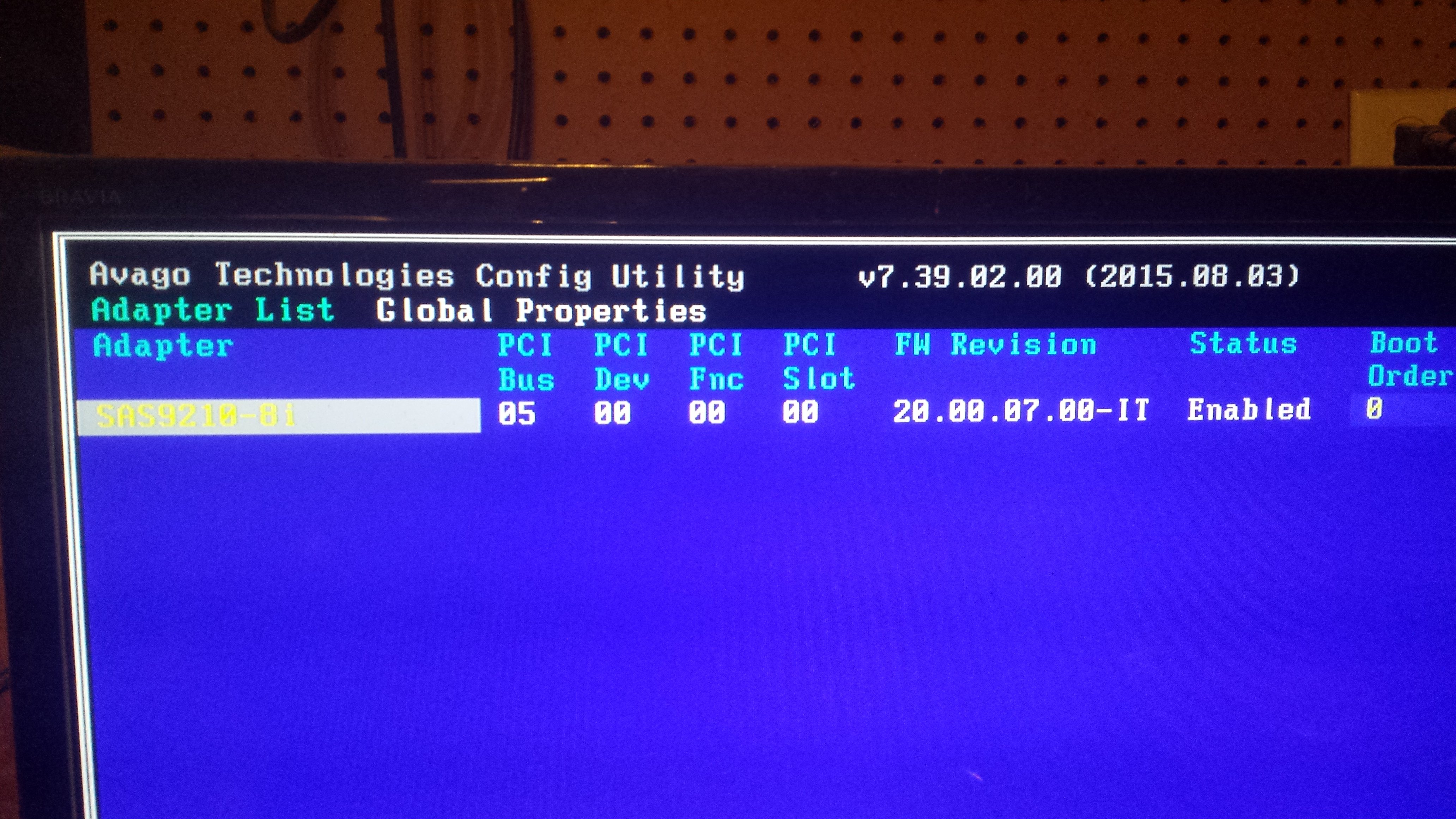

but can you double check for me i did it correct?
i installed  20.00.07.00  version  9210-8i_Package_P20_IR_IT_Firmware_BIOS_for_MSDOS_Windows
https://docs.broadcom.com/docs/12350504
and i upgraded  the bios and firmware  from the article i read

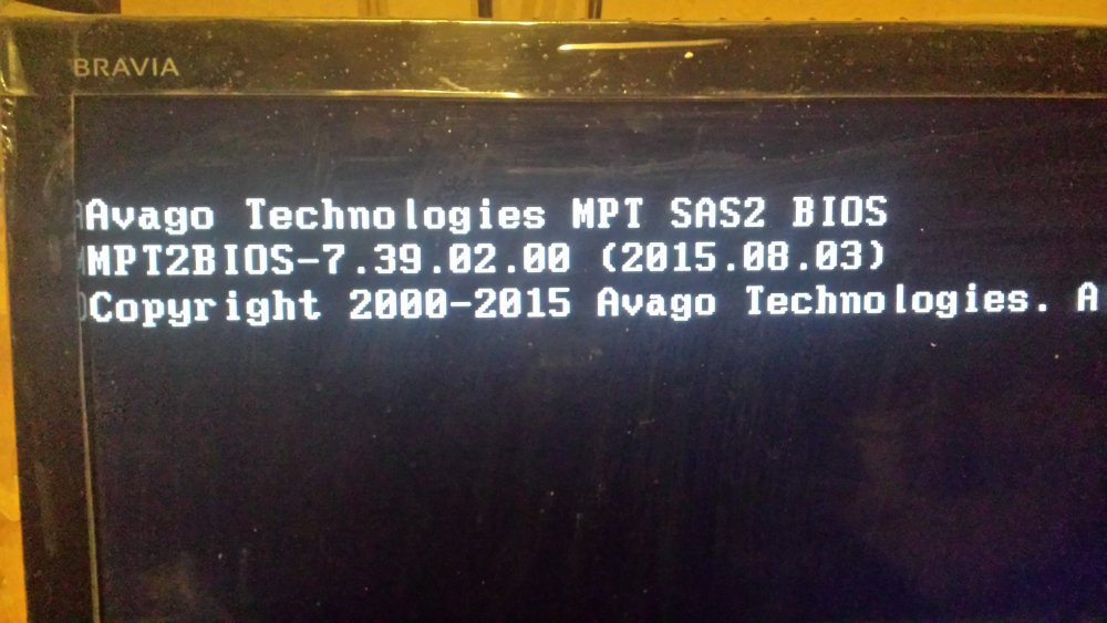

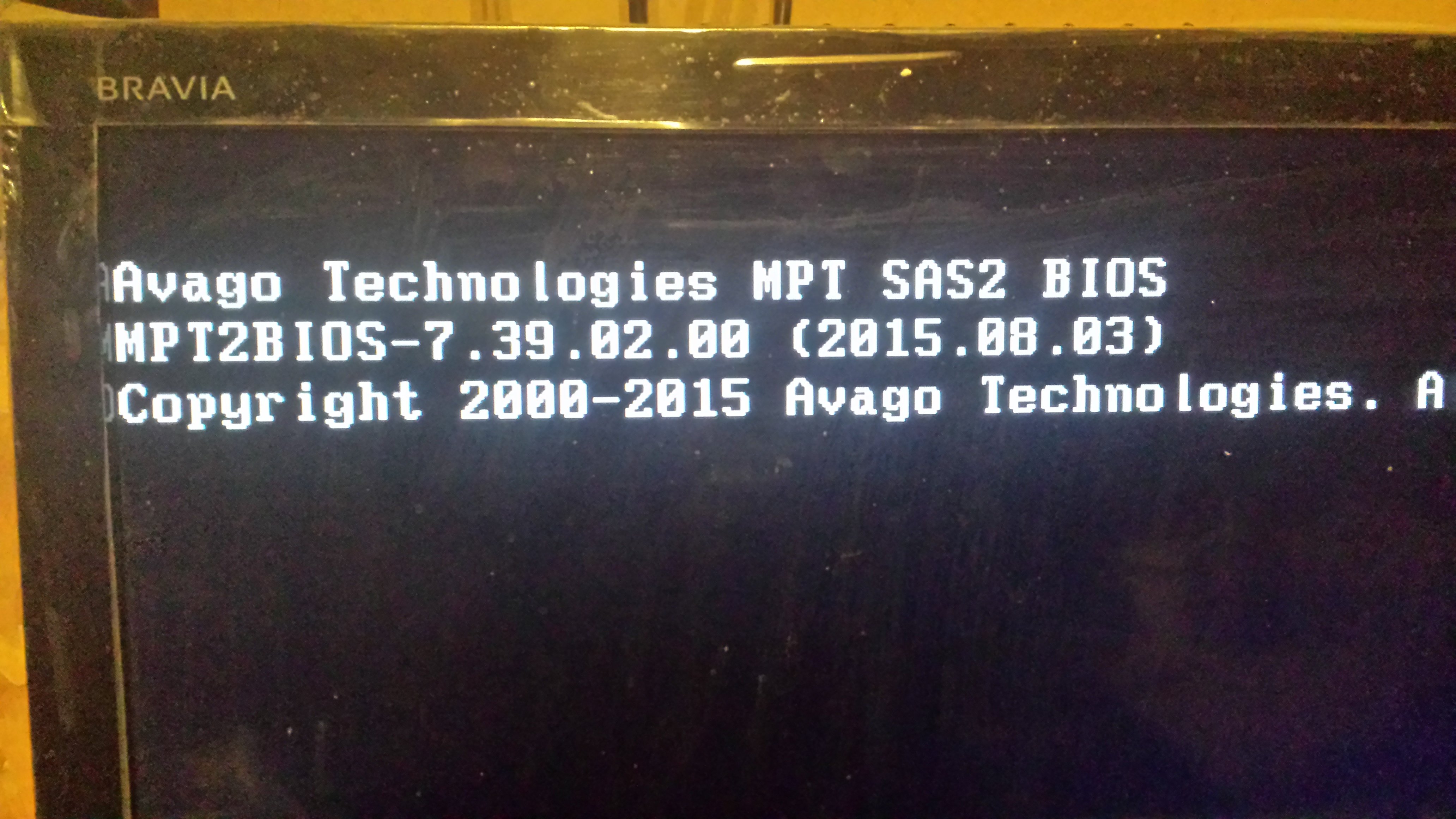

now  there is a newer bios  i think i kinda confused... under Bios  for downloads..
its 7.27.x.x.x.x.x.    yr 2016
but when i did the upgrade the firm and bios from the file above...  the bios i guess its 7.39 i think it was  from 2015  so i not sure do i upgrade the bios  or how do i read the proper bios to see if it worked...
if i did this correct  i going to install it in the unraid  as  i been just fiddling with the Windows  ill take a couple pics and upload from my phone to show you what i mean
as i havent had chance to swap my hard drive in a different bay to see if it was the motherboard or hot swap or if tis the hard drive...  just been busy
Unless you plan on booting from the card the BIOS doesn't matter anyway. The important part is the latest IT firmware, which you have.
ah ok nope  just the unraid...  didnt know you could boot from that...
