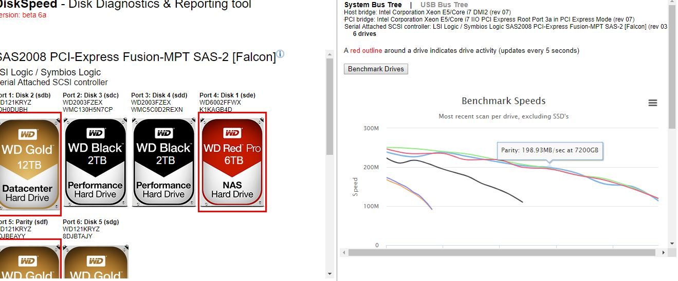

so that means it be significatenly slower...  so what are the options to speed it up if possible?? and here is teh disk report i only took pic of the main one.. and the other 2 drives also completed the test where before they couldnt   speed gap issue
this is no vms no doctors running
