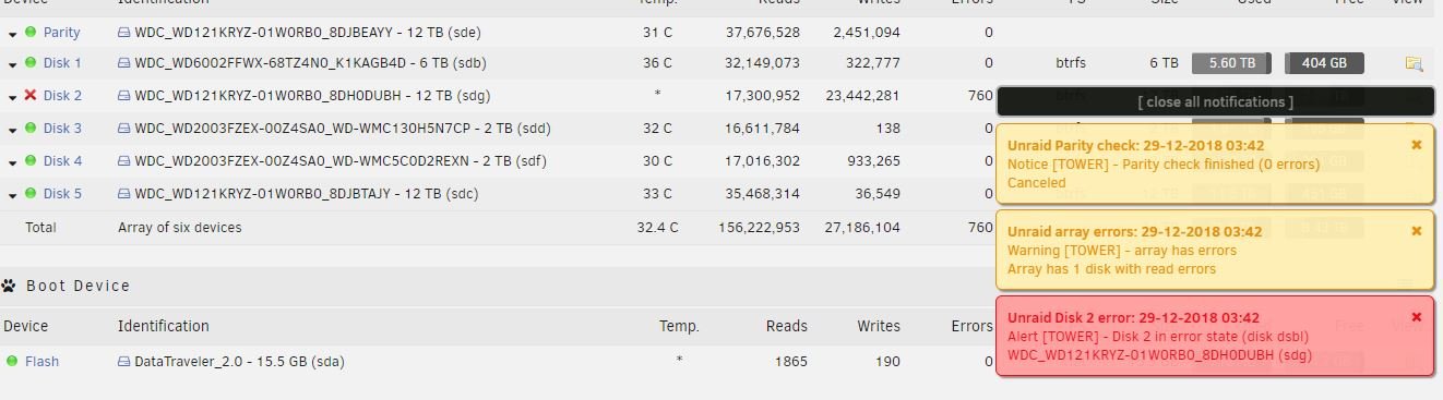

here is the diagnostic file
tower-diagnostics-20181229-0901.zip

and this is screen shot i took too
Nothing was written to parity, so no corruption, disk2 is also likely fine but since it dropped offline SMART it's not visible.

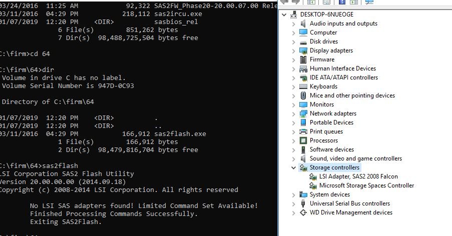

@Taddeusz i got the LSI 9210-8I card  Booting up computer sees it Windows sees it... the LSI software doesnt..
i tried the DOS method then i get PAL error then i did the Shell EFI boot up  and i cant seem to figure how you find the software on it the sas2flash
i been googling and still cant figure it out.. people can just sas2flash -list or listall  and shows  but for me i cant even get it to show an adapter

how do i do this?
