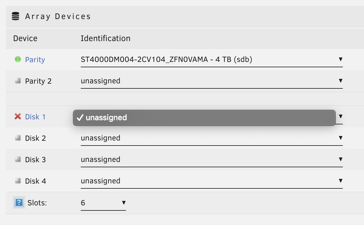

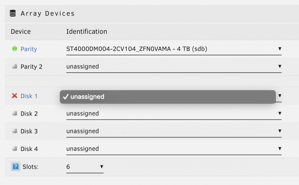

The server has been restarted and the disk isn't found by the bios. When going into the boot selection menu, the disk was not showing up. My parity was and my boot drive too.
This is what I got to see after Unraid started up:
This is a diagnostics file before starting the array.
oxygen-diagnostics-20181224-0945.zip
I will return tonight so I will check on the wiring tomorrow, swap some cables or connect it with a different port.
Swap/replace cables and SATA ports on that disk, if it's not detect by the BIOS it also won't be detected by Unraid.
While I unplugged the parity drive (as I later found out I mixed up the drives), I might have accidentally nudged the Disk 1 SATA cable because after I started the machine, the drive showed up again in the boot menu. It is currently rebuilding Disk 1...
