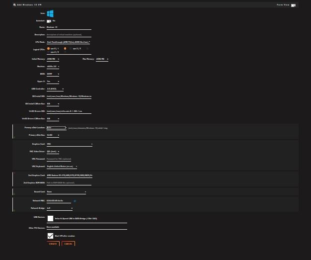

January 13, 20197 yr Hey guys, I am having some issues with passing through an AMD GPU. It's strange, because I was able to pass through this same GPU about 6 months ago to a Windows 10 VM. Basically what is happening is that I will setup a Windows 10 VM with VNC as the main GPU and the RX480 as my secondary. I will go through the windows setup and get to the desktop. I will then install all the missing drivers and then install the GPU driver. Once the driver is installed for the GPU my entire VNC session goes black. I try to RDP into the VM and I get to the desktop, but everything is black and I can only see the cursor. If I force stop the VM and start it back up it freezes on the loading bar and then it goes into windows recovery mode. I have tried these attempts, but without any change. Switched Machine from i440fx-3.0 to Q35-3.0 Turned Hyper-v Off Tried install with different CPU cores selected Tried not installing redhat display driver and just installing AMD Driver in device manager Tried VM install with just VNC as GPU and setup Windows and then shut the Windows 10 VM down and passed through the AMD GPU and it still shows a black screen I am trying an install right at this moment as a SeaBIOS, I will update this thread if that is successful. I've been at this all week, I have followed a bunch of other different guides (spaceinvaders) and still no luck. I have attached logs to this thread as well. Any ideas would be super helpful. Thanks! tower-diagnostics-20190113-1056.zip
