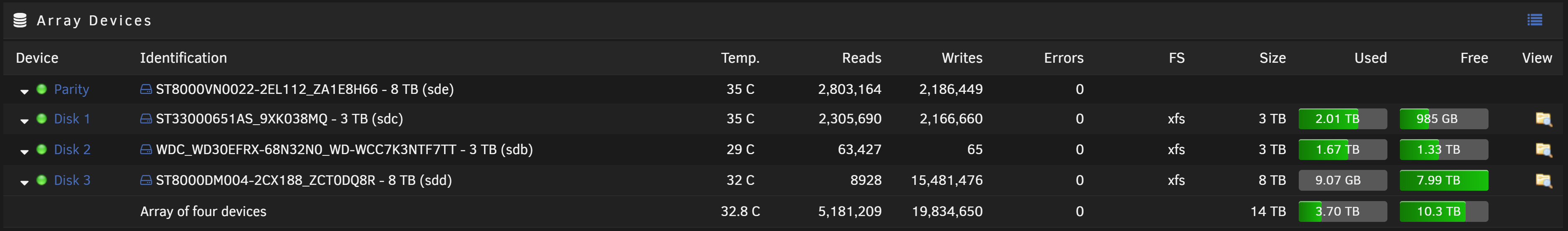

ALL MY SHARES ARE GONE...
*sigh*
Came home to this...
...a stopped array.  Again.
wtf

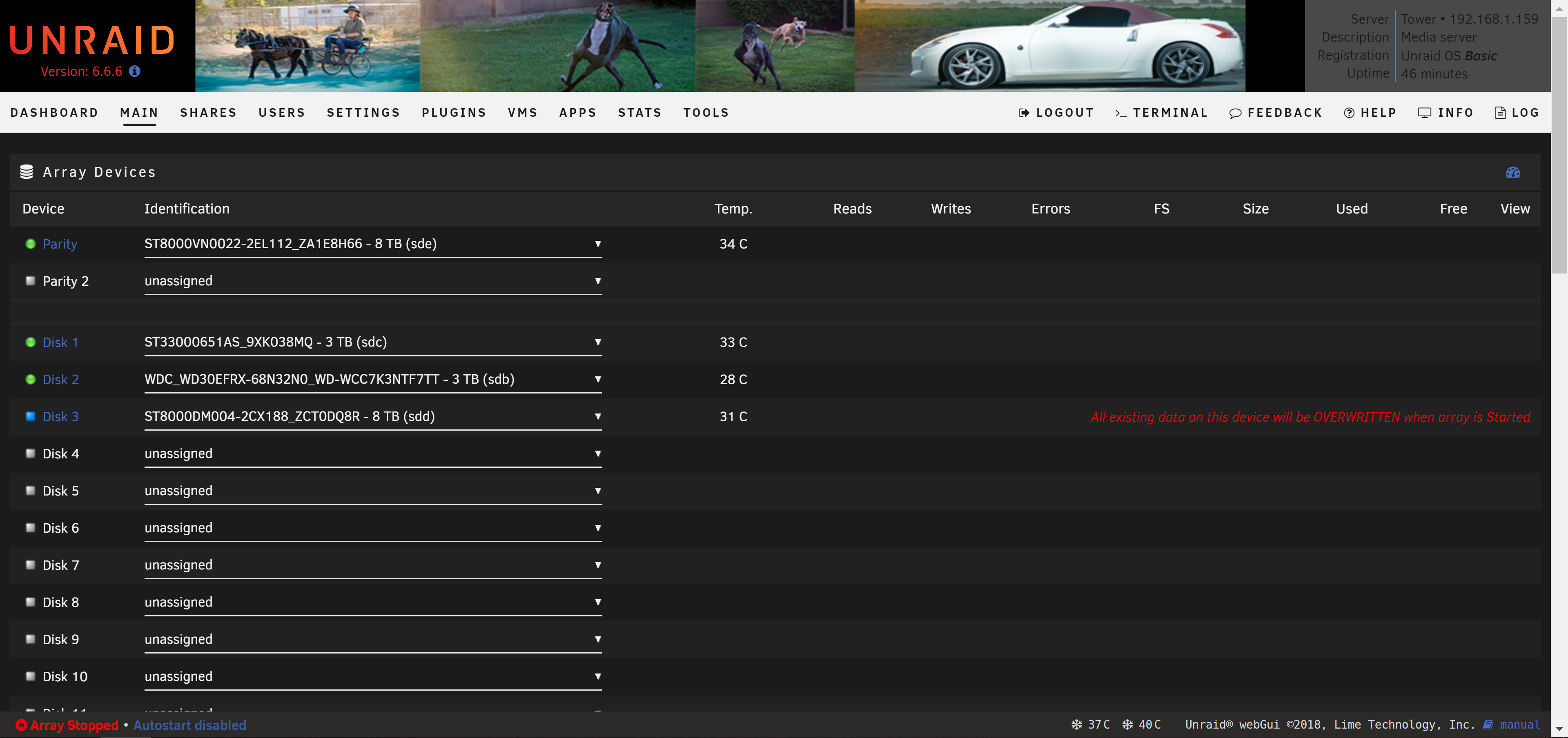

What do you mean "new config"?  Wipe it and start over?
New config adds all data drives as they are, and rebuilds parity based on the current content. It only wipes out the parity drive(s).
That's not really an option if that's what you mean.
Of course not. Just forget about adding that disk for now and see if you can get to a stable array without it.
Tools - New Config. Retain All, then unassign that problem disk. When you start the array the only thing it will do is rebuild parity using the other disks. None of the data disks will change.
In fact, since it sounds like you don't have backups, you might even postpone the parity rebuild by unassigning parity also. Then you can copy anything important and irreplaceable, and once you have done that, assign the parity disk and let it rebuild.
If it offers to FORMAT anything, DON'T. Come back for further advice.

New config.  Got it.  Sounds perfect.
Beautiful.  Will get it started tomorrow morning and post the results.
Thank you all!

Alright.  New config'd, all retain'd, wonky disk unassign'd, parity being reparity'd.  We'll see what happens!  Thanks, my friend.
The now unassigned 8TB drive has an option to format, btw.
I wouldn't bother with it for now in case trying to access it causes problems again. If you want to use it Unassigned you can format it later, and if you want to put it in the array it will be cleared so format would be pointless.

So, just to update everyone, the clearing FINALLY finished.  It took OVER FIVE DAYS for it to clear, but it finally finished and has been formatted and added to the array.
I've got another 8TB on the way that I'm going to use to replace one of the 3TB drives, but now that I have enough space, I don't really care how long it takes to clear.  I can FINALLY get to work setting everything up!
Thank you all for all the help.  You're the best.
Edited by rmp5s
That's way too long, but it's not the first time a user get's very low write performance with those Seagate disks, appears some are much slower than they should be.
