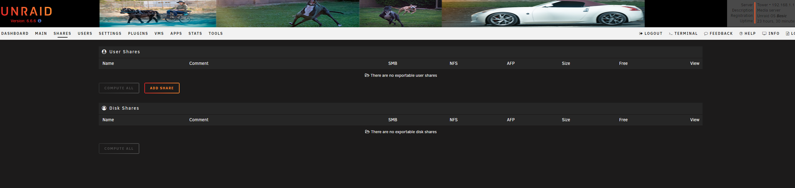

ALL MY SHARES ARE GONE...
I'm...um...a bit...concerned...
Was wondering why I could no longer access one of my shares and, come to find out, they're ALL GONE!!
This has to be a UI glitch or something...I mean...seriously.  This can't be right.
Anyone else had this happen?
Is it because I added a new drive and it's "clearing"?

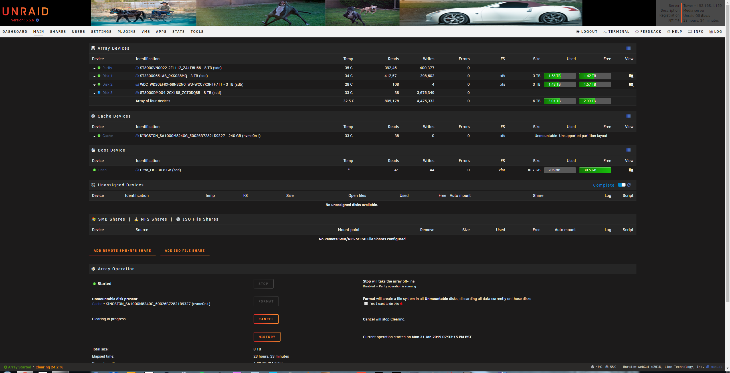

My main screen:

This is usually a browser issue. If you have an adblocker, whitelist your server. Try clearing browser cache, try another browser.
When you say you can't access them, do you mean over the network? If you can't access your shares over the network, go to Tools - Diagnostics and attach the complete diagnostics zip file to your next post.
I rebooted the server and they're back.

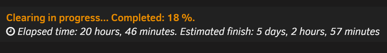

This stupid disk clearing nonsene, which took nearly 30 HOURS to get 24% complete, started over though.  SUPER annoying.  I REALLY thought it would detect that 24% had been done and start from there.  But.  No.  Apparently not.  Might get to add my new drive by mid March!  lol
That's way too long, a 10TB disk takes around 18 hours to clear, and you can use the server normally during the clear.
Ok...good to hear something's out of whack.  It's back up to 18-ish% now...after 24hrs or so...kinda nuts.

So...the million dollar question:
HOW CAN I SKIP CLEARING!?  I didn't have to clear my cache drive!  Can't I just format the new drive and add it?  I'd like to use it THIS WEEK!  rofl
Edited by rmp5s
Set a new config and assign all the drives where you want them, and let parity rebuild.
Keeping parity valid when you add a drive requires that the drive be clear. So you can either clear the disk or rebuild parity, your choice.
Ordinarily clearing is what you want since the array remains protected during the process, whereas if you elect to rebuild parity then it isn't protected until parity is rebuilt.
Possibly whatever is causing your slowness will also affect the parity rebuild anyway.
Here is another possibility:
Set a New Config without that new disk, check the box saying parity is valid, then just use your array without that additional disk and try to get to the bottom of your hardware problems.
