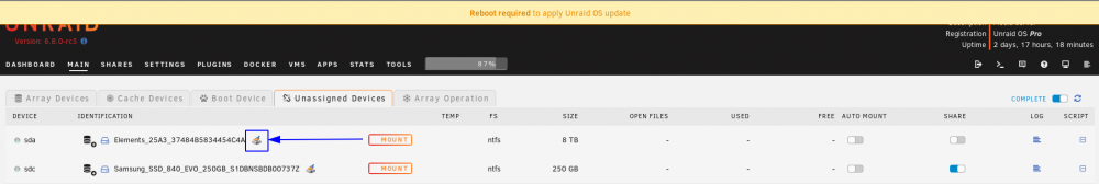

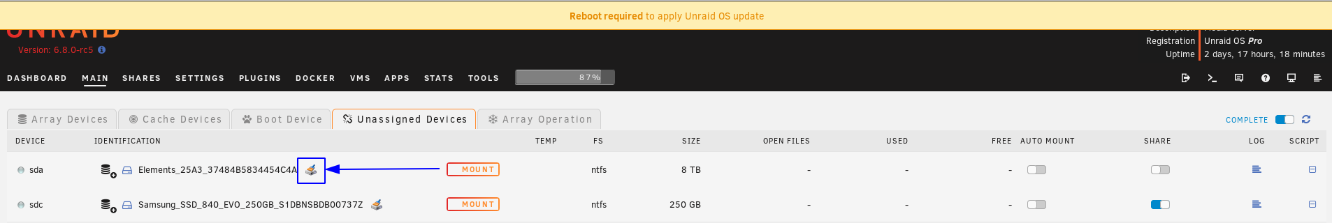

I have been trying to find out how to do exactly this. How do you do it? I am trying to test some drives before I shuck them to make sure they are not going to fail right away.
I do it the same way you PreClear internal drives. I plug the usb3 drive into usb3 port then run the PreClear process on it. Nothing magical or difficult at all.
What are you having trouble with, do you not have usb3 ports, do you not have usb3 cable, do you not know how to run preclear?
Only real suggestion is to have a fan running over the external enclosure to keep it cool.
Edited by BRiT
Click that.

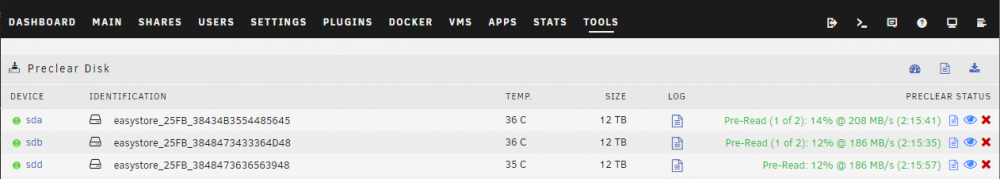

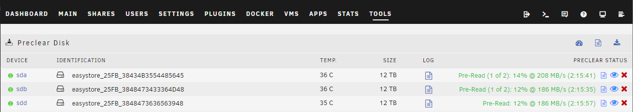

I was able to figure it out. Finding the location in the GUI was not the problem I was having. I have 3 drives to do and only one was showing up at any one time for some reason. I popped in a USB 3.0 card and have two plugged into it and one into the USB 3.0 built into the motherboard and all of them show fine at the same time now. I'm well into my drive tests.
The drive that is only doing one clear instead of two already went through and completed a clear while waiting for the USB 3.0 card.
