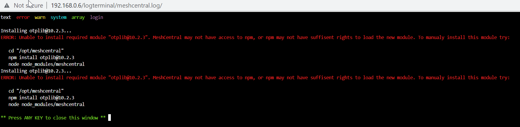

Ruthalas Posted February 4, 2021 Share Posted February 4, 2021 Appreciate it! Configuration: Name: MeshcCentral Repository: uldiseihenbergs/meshcentral WebUI: http://[IP]:[PORT:466]/ Network Type: Bridge Console shell command: Shell Privileged: Off Port: Container 80, Host 82, TCP Port (UI): Container 8443, Host 455, TCP Port (Agents): Container 443, Host 466, TCP Path (Data): Container /home/node/meshcentral/meshcentral-data, Host /mnt/user/appdata/meshcentral/data/, Read/Write Path (Files): Container /home/node/meshcentral/meshcentral-files, Host /mnt/user/appdata/meshcentral/files/, Read/Write Path (Web): Container /home/node/meshcentral/meshcentral-web, /mnt/user/appdata/meshcentral/web/, Read/Write Path (Backup): Container /home/node/meshcentral/meshcentral-backup, /mnt/user/appdata/meshcentral/backup/, Read/Write If the log you refer to is the one linked to in the unRAID UI, then this is the contents: (If there's another within the docker, let me know where it exists and I will fetch it!) Installing [email protected]... Installing [email protected]... MeshCentral HTTP redirection server running on port 80. MeshCentral v0.7.50, LAN mode. Server has no users, next new account will be site administrator. MeshCentral HTTPS server running on port 443. I have removed the container/image and deleted it's folder in appdata and recreated it (with the above settings) and the result was the same. Quote Link to comment

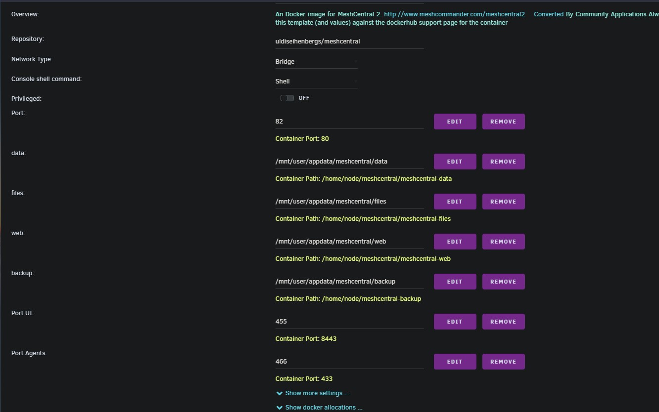

Mr_Jay84 Posted May 7, 2021 Share Posted May 7, 2021 I'm trying to get this running but still can't reach the WebUI. Installing [email protected]... Installing [email protected]... MeshCentral HTTP redirection server running on port 80. Generating certificates, may take a few minutes... Generating root certificate... Generating HTTPS certificate... Generating MeshAgent certificate... Generating Intel AMT MPS certificate... MeshCentral v0.8.16, LAN mode. Server has no users, next new account will be site administrator. MeshCentral HTTPS server running on port 443. Docker Template in attached screenshots Quote Link to comment
uldise Posted May 7, 2021 Share Posted May 7, 2021 @Mr_Jay84 seems like it's a first run, and you should access Webui with https://<yourLANIP>:466/ Quote Link to comment
Mr_Jay84 Posted May 7, 2021 Share Posted May 7, 2021 1 hour ago, uldise said: @Mr_Jay84 seems like it's a first run, and you should access Webui with https://<yourLANIP>:466/ No joy whatsoever unfortunately. Quote Link to comment
uldise Posted May 7, 2021 Share Posted May 7, 2021 @Mr_Jay84 there is typo on your port mappings - on last row container port should be 443 but you have 433 Quote Link to comment
Mr_Jay84 Posted May 10, 2021 Share Posted May 10, 2021 On 5/7/2021 at 4:00 PM, uldise said: @Mr_Jay84 there is typo on your port mappings - on last row container port should be 443 but you have 433 Christ so it is! That will team me to install dockers when drinking! lol Thanks awfully! Quote Link to comment

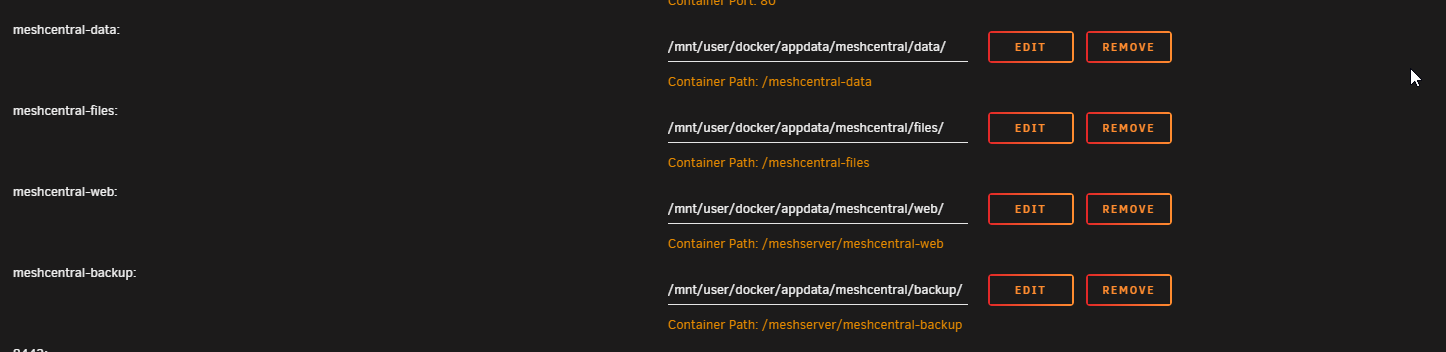

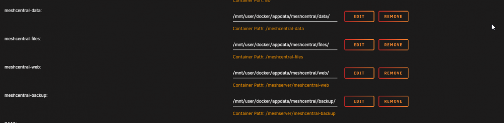

tjustice86 Posted June 7, 2021 Share Posted June 7, 2021 Here are my volume settings. Quote Link to comment
uldise Posted June 7, 2021 Share Posted June 7, 2021 Container paths is wrong, see here: https://hub.docker.com/r/uldiseihenbergs/meshcentral Quote Link to comment

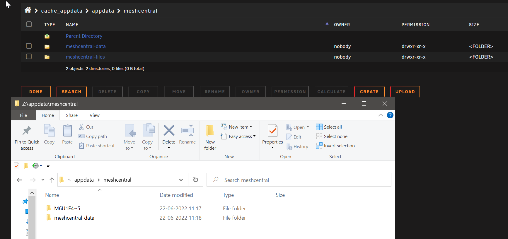

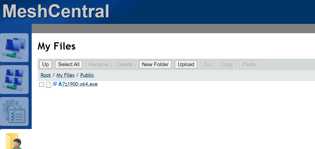

casperse Posted June 22, 2022 Share Posted June 22, 2022 (edited) I tried the community app but I am having some problems? Uploading files does not get uploaded to the files folder? Also windows share shows the folder strange? "M6U1...." Also changing the port number breaks the "open webui" on the Unraid docker menu (But thats a smaller problem) Edited June 22, 2022 by casperse Quote Link to comment
casperse Posted June 25, 2022 Share Posted June 25, 2022 Seem to be some access problem? Quote Link to comment
