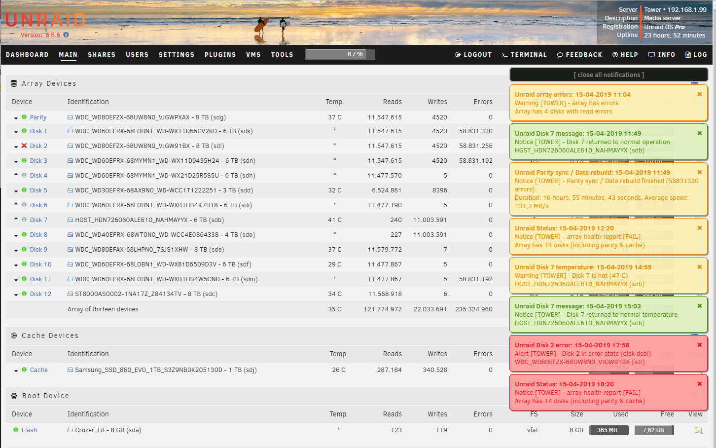

I have a Unraid set up consisting of 1 parity disk, 1 cache disk and 12 data disks.
One of the data disks (4 TB WD Red) had read errors and I decided to remove it and add a new disk (6 TB HGST) and rebuild.
Everything looked good for 10 hours but then I started to get error messages that several disk had read errors.
When the rebuild was done I had 4 disks with read errors and when I got home from work one of them (8 TB WD Red) was disabled and content emulated.
I have used Unraid for several years, changed hardware several times and changed disks before without problems.
What do I do know? Any suggestions would be appreciated
tower-diagnostics-20190415-1818.zip
Are disks 1,2,3,11 on the same controller?

Attached is the new diagnostics after reboot. To my limited knowledge SMART seems fine. No read errors or allocated sectors.
Disk 2 is still disabled though. How would I go about to make it online again?
