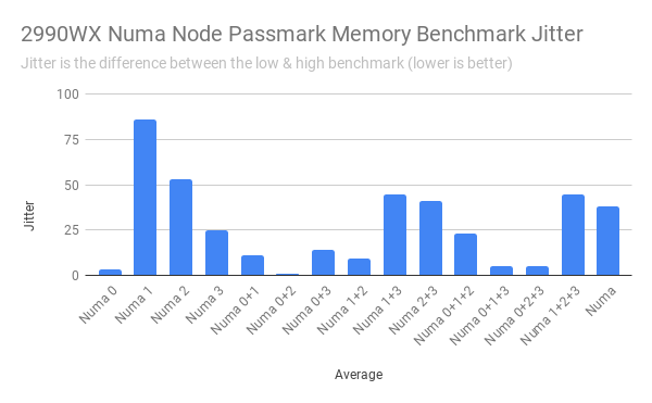

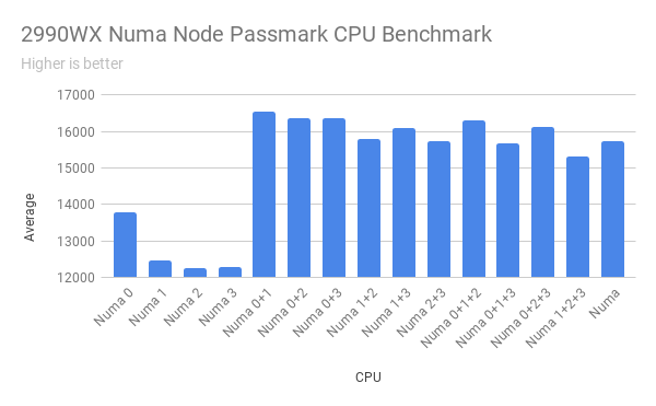

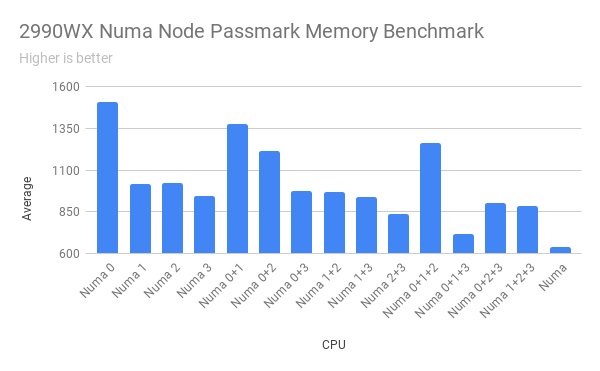

I benchmarked a Win10 VM with PassMark's PerformanceTest assigned to the different Numa nodes on the 2990WX, separately and different combinations. The last column was truncated, it's all four numa nodes except CPU 15/47.
Each test was repeated five times and the results averaged.
When running the benchmark, did you also set numatune to force memory load to the right NUMA node too?
Your Node 0 vs Node 1-3 looks suspiciously like your VM is fully allocated to node 0 only.
For VM that spread across multiple nodes, you might even want to force it so that memory is loaded evenly across different nodes. In my case, I have had to go as far as running 2 dummy VMs to load up 2 nodes to the right amount so that my main VM splits almost 50-50 across 2 nodes (and then shutdown the dummy VMs - thank goodness for CA User Scripts).
I didn't do any memory placement testing, just loaded up one VM with 8 GB of RAM assigned to it. This strikes me as how the vast majority of people will launch their VM's letting KVM do the memory assignments.
Indeed your tests make it clear that these WX Threadripper need some intervention for best performance. Unraid KVM is not smart enough to deal with it.
Even Windows isn't smart enough to handle the multi-Numa-node design. I remember watching Wendell in one of his videos showing that W10 in a VM on TR4 with extra Numa configuration runs way faster in multiple software and close to bare metal linux performance, than bare metal windows on the same system. I hope for the Ryzen 3000 series Microsoft is doin their homework.
