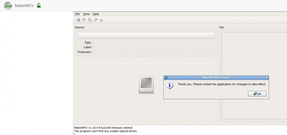

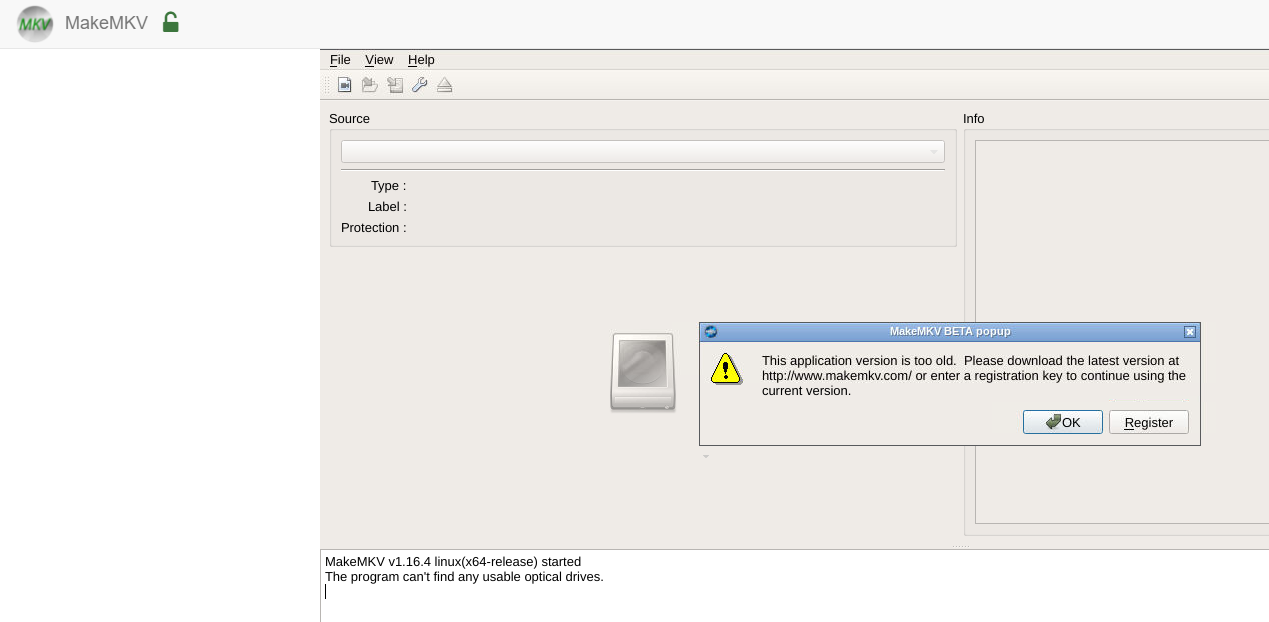

I can't get it to work after updating to latest 1.16.4.
I get 'Your temporary key has expired and was removed. Please restart the application.' error every time I try to go to webUI.
I entered a valid key (expires tomorrow) in the registration dialog that pops up but I keep getting the error with the key after a restart and can no longer use the app.

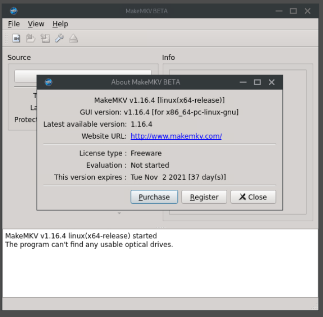

i cant fix what i cant see, and currently i cant replicate what you are seeing, here is what im seeing, pulling tagged 'latest' and starting the container:-
as you can see there are no issues starting makemkv and the trial licence is correctly set to expire on 2nd of nov. one thing you can try is deleting all files/folder in your /config folder for this container then restart it.

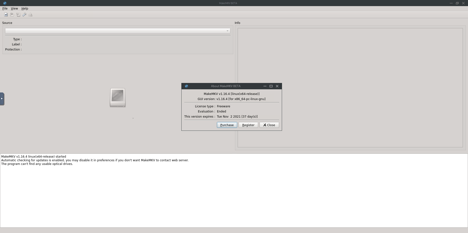

This is what i am now getting, bear in mind that i've used this program without any issues as late as 2 days ago. I've forced update and also deleted / recreated image. Strange one, only difference being the evaluation ended in my case?

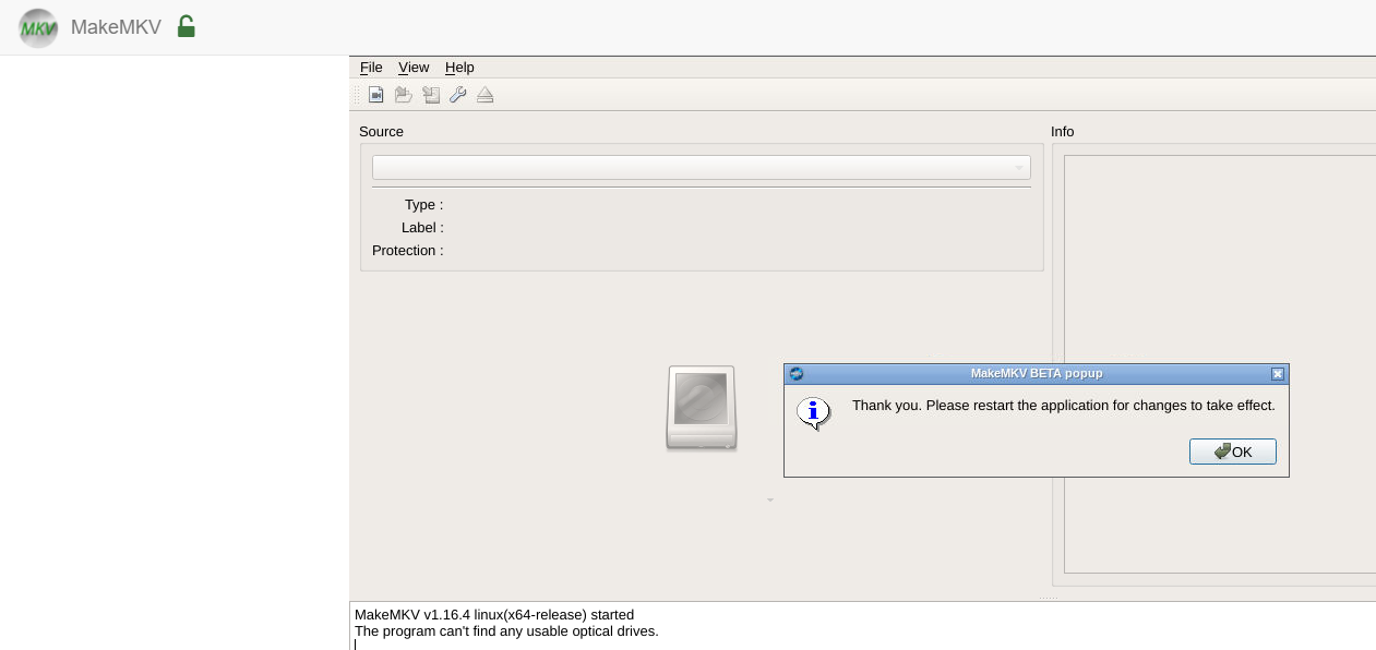

I've run into the problem of not being able to save any preferences at all. I see it raised its head in the summer and was 'fixed' by deletion of a symlink??? First noticed this when i realised my rips were defaulting to all languages being saved even when i only save english titles, audio, subs etc. Anyone any idea what needs doing this time around?
try this:-
1. stop the container
2. delete file /config/perms.txt
3. start container and wait - it could take a little while to start (resetting permissions).
4. try and save change and see if it persists.
