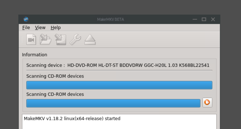

so this is my noob experience report, i tried connecting a optical dvd drive to rip a dvd with binhex makemkv.
i also encountered the missing drive error. i tried finding the commands for finding mounted drives and somehow ended up with
"cd/dvd  PLDS     DVD-RW DS8A9SH   EL3A  /dev/sr0   /dev/sg11".
i tried mounting via menu option "add device", but no luck, the cdrom doesnt show up.
i then did the console thing a user has posted before and executed the commands starting with "pacman -S --noconfirm usbutils".
the drive appears and i can actually start reading the dvd.
the process then cancels out with
"Unable to execute external program 'ccextractor' as its path is not set in preferences
Failed to execute external program 'ccextractor' from location '/usr/bin/mmccextr'"
the instructions from a different docker image introduced me to adding an extra option by turning on the advanced view for the docker options. i added the drive per "--device /dev/sr0 --device /dev/sg11" and did the pacman thing again, no luck tough, same error.
it appears the mount works but the xxextractor is missing. sadly i have no idea how to install that properly.
any advice is appreciated.
edit: fiddled around more. by activating expert mode in mkv options and adding "/bin/ccextractor" as a path i got the dvd ripped. tadaa.
what remains is the automaton of the pacman script. doing all those commands after rebooting the docker image will become tiresome sooner or later i guess.
Edited by likesboc
