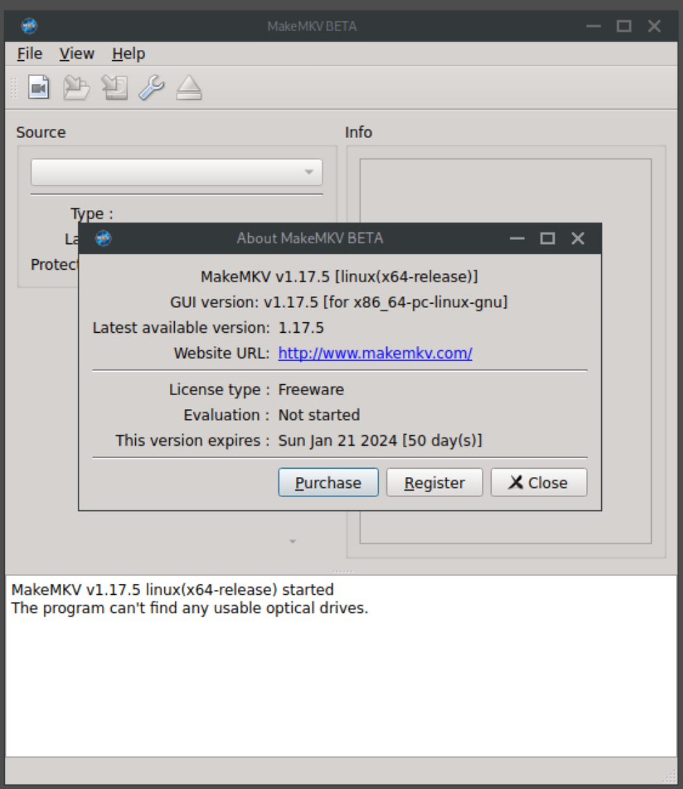

I am getting the update error. Will this docker be updated with a new license? Is there a way I can update the license manually?
what 'update error'? this has a freeware licence for another 50 days yet:-

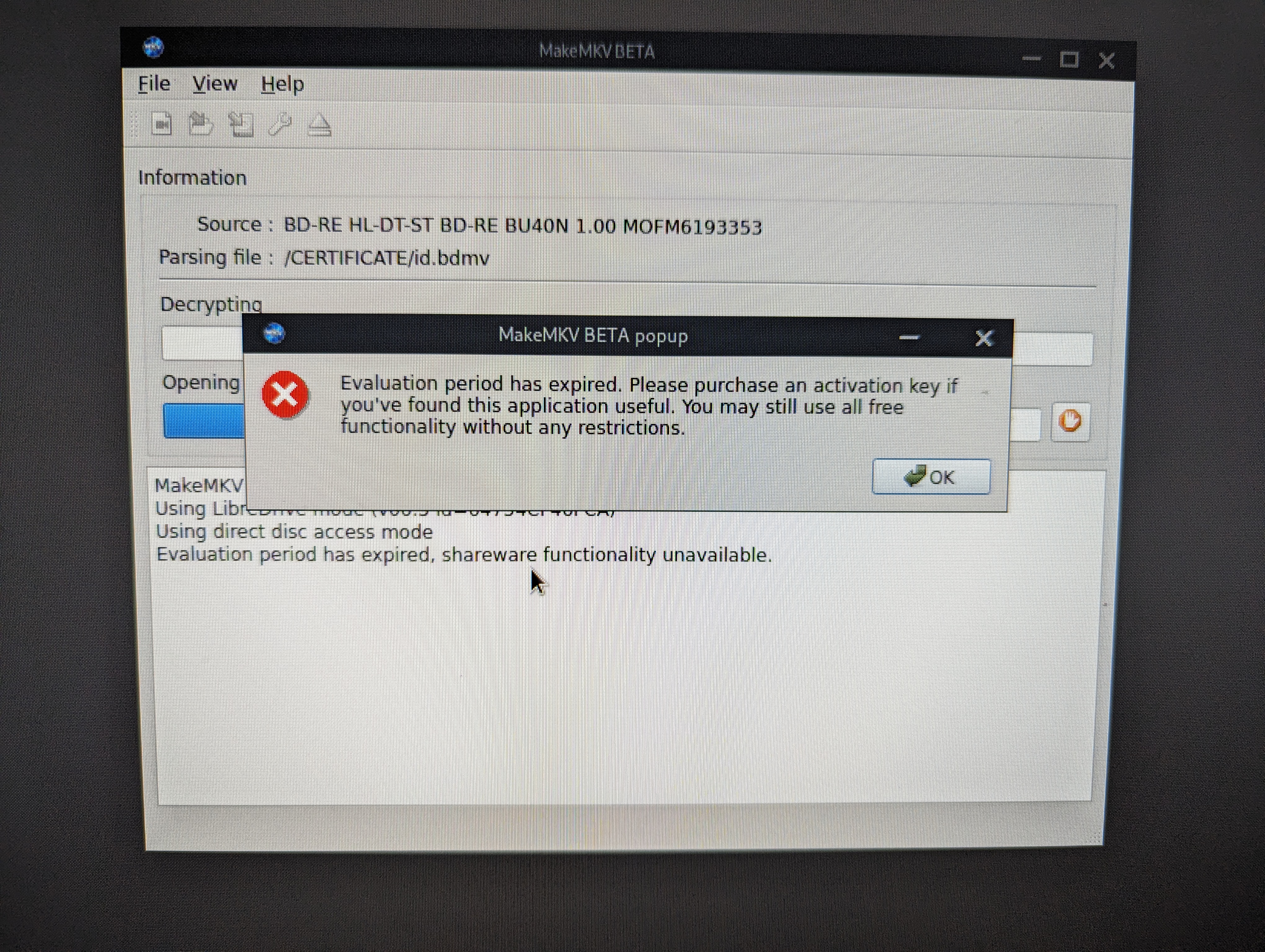

I show the same thing under the About menu. However, when I try to rip a blu-ray disk, I get the attached error.
Same here, did the force update, started and restarted, removed config file in appdata but still the "evaluation period expired" error returns. The About screen tells me I have 102 days left in my license?
Removing docker image, deleting appdata folder and reinstalling docker did the trick
