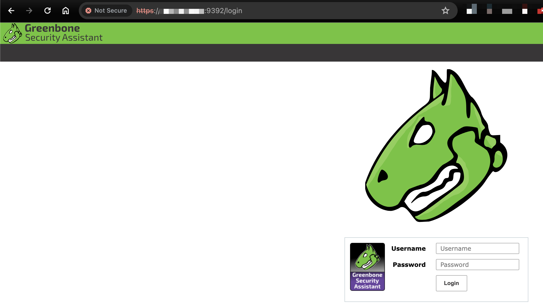

Author of the frak-gvm template here (not the actual container). Sorry for pointing the support page to here. I think it was my first template and I didn't have a page on the forum to point it to, or perhaps I started with the nessus template and inherited by accident. Either way, sorry for the confusion.
As I recall, the OpenVAS/GVM container takes a really long time to come up the first time as it downloads a ton of NVTs and other databases from the web. After it's done, it should come up. Just be patient and monitor the logs. It spends most of the time in the 'Updating xxx' lines then finally goes to: Your GVM 11 container is now ready to use!
9:C 14 Mar 2024 13:23:34.863 # oO0OoO0OoO0Oo Redis is starting oO0OoO0OoO0Oo
9:C 14 Mar 2024 13:23:34.863 # Redis version=5.0.7, bits=64, commit=00000000, modified=0, pid=9, just started
9:C 14 Mar 2024 13:23:34.863 # Configuration loaded
Wait for redis socket to be created...
Testing redis status...
Redis ready.
Starting PostgreSQL...
waiting for server to start....2024-03-14 13:23:35.963 EDT [21] LOG:  starting PostgreSQL 12.3 (Ubuntu 12.3-1.pgdg20.04+1) on x86_64-pc-linux-gnu, compiled by gcc (Ubuntu 9.3.0-10ubuntu2) 9.3.0, 64-bit
2024-03-14 13:23:35.964 EDT [21] LOG:  listening on IPv4 address "127.0.0.1", port 5432
2024-03-14 13:23:35.964 EDT [21] LOG:  could not bind IPv6 address "::1": Cannot assign requested address
2024-03-14 13:23:35.964 EDT [21] HINT:  Is another postmaster already running on port 5432? If not, wait a few seconds and retry.
2024-03-14 13:23:35.983 EDT [21] LOG:  listening on Unix socket "/var/run/postgresql/.s.PGSQL.5432"
2024-03-14 13:23:36.016 EDT [22] LOG:  database system was interrupted; last known up at 2024-03-14 13:20:10 EDT
............2024-03-14 13:23:48.242 EDT [22] LOG:  database system was not properly shut down; automatic recovery in progress
2024-03-14 13:23:48.249 EDT [22] LOG:  redo starts at 6/AFF8A7C8
...2024-03-14 13:23:51.958 EDT [22] LOG:  invalid record length at 6/C435B610: wanted 24, got 0
2024-03-14 13:23:51.958 EDT [22] LOG:  redo done at 6/C435AEA8
....2024-03-14 13:23:55.066 EDT [21] LOG:  database system is ready to accept connections
 done
server started
Updating NVTs...
Updating CERT data...
2024-03-14 13:24:55.160 EDT [43] LOG:  autovacuum: dropping orphan temp table "gvmd.pg_temp_5.current_credentials"
rsync: failed to connect to feed.openvas.org (89.146.224.58): Connection timed out (110)
rsync: failed to connect to feed.openvas.org (2a01:130:2000:127::d1): Cannot assign requested address (99)
rsync error: error in socket IO (code 10) at clientserver.c(127) [Receiver=3.1.3]
Updating SCAP data...
Starting Open Scanner Protocol daemon for OpenVAS...
Starting Greenbone Vulnerability Manager...
admin
Starting Greenbone Security Assistant...
Oops, secure memory pool already initialized
Starting OpenSSH Server...
+ Your GVM 11 container is now ready to use! +
I would also monitor the output of:
netstat -tulpn | grep LISTEN
and look for the 9392 port which corresponds to the Web UI port.
When it finally completes, the output of that command should look like this:
root@e2885647614f:/# netstat -tulpn | grep LISTEN
tcp        0      0 0.0.0.0:9390            0.0.0.0:*               LISTEN      -
tcp        0      0 0.0.0.0:6379            0.0.0.0:*               LISTEN      10/redis-server 0.0
tcp        0      0 127.0.0.11:32801        0.0.0.0:*               LISTEN      -
tcp        0      0 0.0.0.0:22              0.0.0.0:*               LISTEN      379/sshd: /usr/sbin
tcp        0      0 127.0.0.1:5432          0.0.0.0:*               LISTEN      -
tcp6       0      0 :::9392                 :::*                    LISTEN      -
tcp6       0      0 :::22                   :::*                    LISTEN      379/sshd: /usr/sbin
Pointing the browser to <ip-address>:9392 should look like this:
Edited by frakman1

Since the support link was redirected, I'll have to post here.  It looks like the source project is now deprecated so frak-gvm may need to be deprecated or replaced.
https://github.com/Secure-Compliance-Solutions-LLC/GVM-Docker/commit/d5fa0ed1edf63faf06230270c7c006bb5d013a80?diff=split&w=0
CC @Squid in case this should be added to Fix Common Problems
