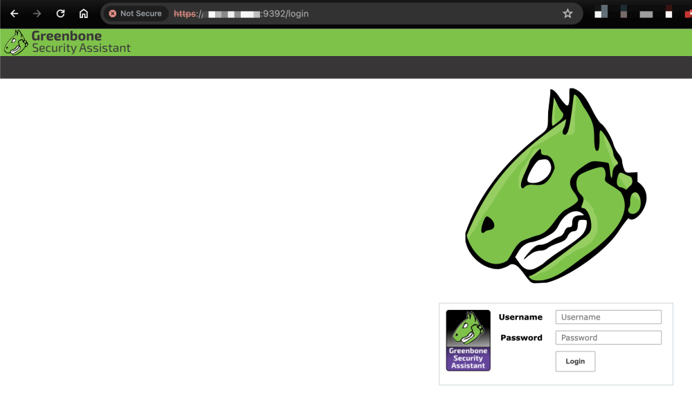

Hoping this is the right topic:
I'm having trouble installing greenbone. I can get to the webui but I can't log in. I have another docker on the main port so I changed GB's webui port. Does this template require the default port or is there something I'm missing?
Chezro, you can change the port mapping on either of the containers.
For doing it here, modify host port 1 on the docker configuration page. This will map the port you set to the containers internal port 8843.

On 6/9/2021 at 3:37 PM, bilboswaggins said:
Hey,
Sorry if this has already been addressed but I keep getting the "Report outdated / end-of-life Scan Engine / Environment (local)"
Installed GVM Libraries (gvm-libs) version: 11.0.1
Latest available GVM Libraries (gvm-libs) version: 20.8.1
Is there a way to manually update this?
I came here to ask the same question - any way to get this updated? TIA
Glad you pinged me as I am able to get this handled today as I have some time on my hands. Been pretty busy and this keeps slipping my mind given it continues to work with updated plugins; however, I may look into creating an automated pipeline for publishing updates here soon if I can make the time out of my schedule to work this.
Just re-packaged a new container update that I am spinning up for a test (wouldn't want to push an update and break everyone's functional scanner) before publishing it. I should have it up here shortly. 😁
Just to give you a heads up, I just pushed an update updating Nessusd to the latest version as well as updating the base image and other dependencies.
Let me know if you have any issues.
UPDATE 1 5:30PM MST: No issues with the package and it functioning; however, if deploying an update/upgrade it appears there is some bug that causes a 404 error. Working on a fix right now, which involves backing up /config/opt/nessus/var/nessus (which is the configuration files for a user), cleaning up the whole previous install, then re-installing the new package. I think since I just copied the deb into the path there is something that it doesn't like. I plan to have this fixed today within the next hour or so. I don't recommend updating just yet!
UPDATE 2 6:00PM MST: I believe to have a patch in place that i published. Doing a final test to make sure all is well. I recommend if you have anything important (IE: license for non-free) to backup the var/nessus folder and store it elsewhere. This can be done by accessing the console. Wouldn't be a bad idea to do this anyways if this is used on a business/production system. I imagine most UnRaid instances are for small home use and I know personally I wouldn't have an issue re-doing my configurations; however, this is probably not the same for a select few.
If anyone is still having issues, please feel free to post your logs. I should have time over this 3-day weekend to work with anyone who is running into issues in debugging it. Seems each time I go for a simple patch it works fine except for upgrading where a volume and data is present. If all is well, I may look into making a CI/CD pipeline to auto-update the core components on a regular schedule, but I have to figure out good tests it can run before merging into the production version.
