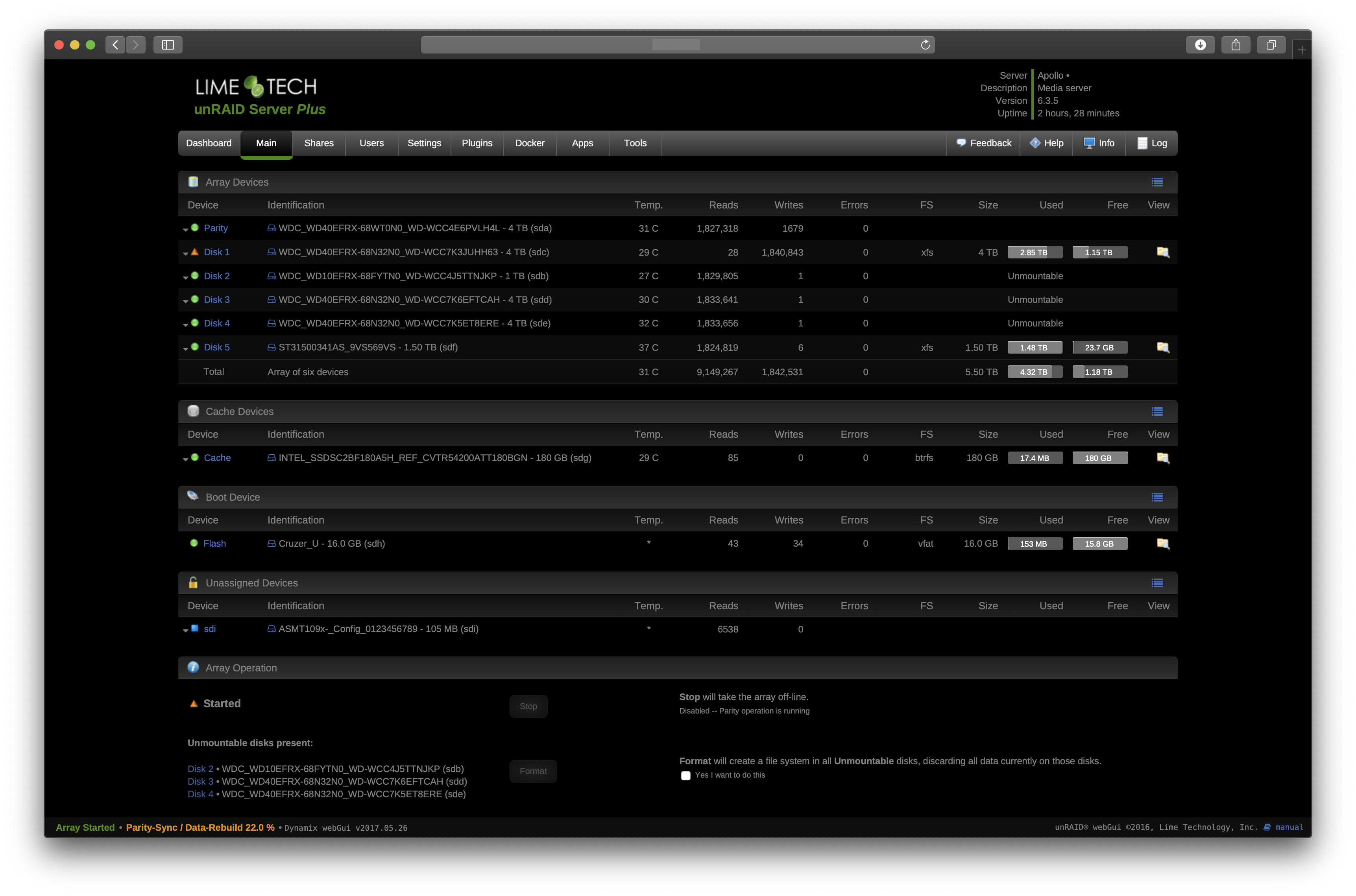

Post a screenshot of Main - Array Devices
@trurl Here's the screenshot
Emulated disk1 seems to be mounted, so let the rebuild complete. Are all your array disks XFS?

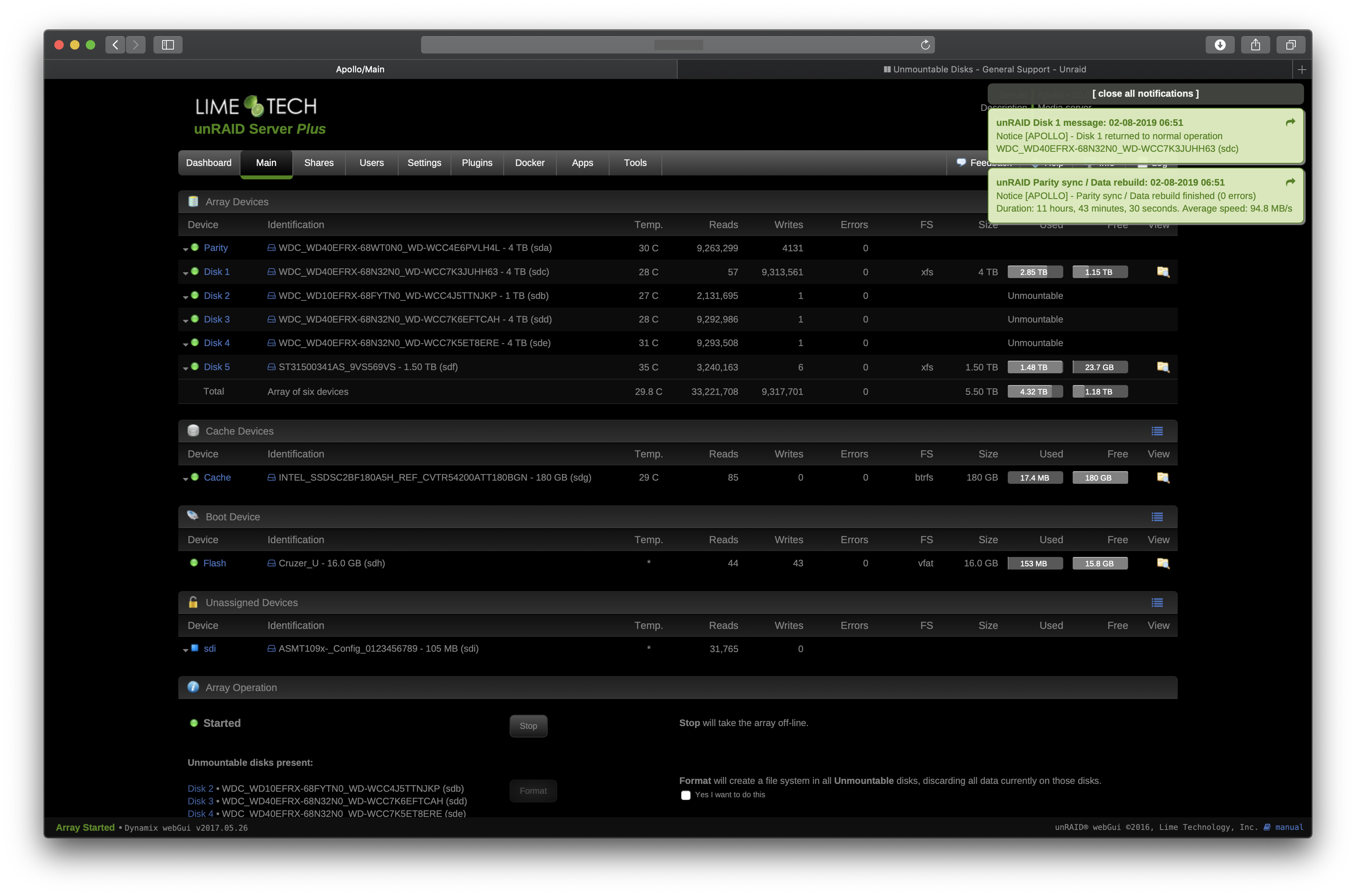

@trurl The rebuild completed successfully with 0 errors.
That looks good except for those unmountable disks. I don't understand how you got those. Did you perhaps do all the disk swapping with the power still on or something? Is there anything you left out in your description?
Post a new diagnostic.
Kind of a strange problem, filesystems look corrupt, very unlikely to happen to all 3 with normal use.
