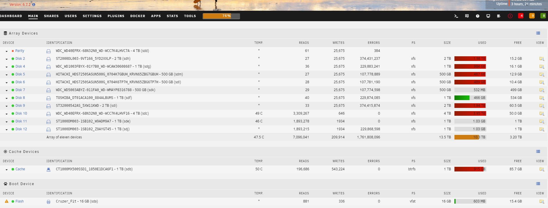

Quick, need help. Array showing absurd # of reads and writes on several drives. Shares not accessible
Reads are 22,617,230,667,232, Writes are 22,617,230,667,232.  And of course, thousands of errors.

Not sure if it's my HBA controller that I removed, and installed back again.  Before that, it was ok.  No spare HBA.  As for the SFF-8087 cable, using 2 cables for 7 drives.  Can't be possible that all drives are failing if 1 of the cables are defective.

It might be worth checking that the HBA is well seated in the motherboard slot.   I once had similar problems with one that was not properly seated.
BTW, I forgot to mention that it starts out ok.  No errors.  I can even access shares, then after a few minutes, those errors showed.
I've removed it, and placed it well once again.  But ok, will move slots this time.  Any other suggestions from other members?  Hope this is not the end of my HBA :D  Thanks itimpi

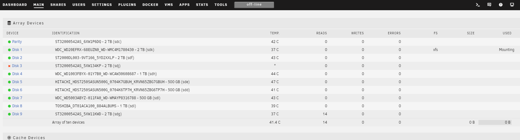

So I got a new set of cables, just arrived today.  No mess.  Connected the cables, and now, I have only 1 drive says mounting.  Nothing happening.  Array not started.  Please help.  Attaching diagnostics.  BTW, changed to a different slot of PCIe already.

I've done some further testing.  I've switched power between drives, still the same problem.  I've connected the parity drive directly to M/B instead of connected to HBA controller, (using regular sata cable) still having the same problems.  I'm attaching a screenshot here.
My Drive 3 is also disabled since I think it died first before the parity.
Won't array start without parity?  Any suggestion what to do next?

Please post current diags, with the parity disk on the MB controller.
Hi.  This is the new diagnostics with parity connected directly to M/B.  Also swapped the PSU connector with another drive.
tower-diagnostics-20190814-2334.zip
Now it's more clear, parity disk is failing.
so as you can see, I have disk 3 that's currently disabled due to drive failed.  What steps do I start with to recover as much as possible :D?
Disk 3 also appears to be failing, best options IMHO are manually copying everything you can from old disk3 to a new disk or using ddrescue to clone it, when that's done also get a new disk for parity, do a new config with new disk3 and remaining disks and sync parity.

While rebuilding parity, I am seeing a lot of errors, though the array is accessible.  Is this normal?
Could it finally be my Dell Perc H310 that is causing problems?  Any way to find out?  I'm using new SFF-8087 cables already.
Looks like it:
Aug 18 09:55:38 Tower kernel: mpt2sas_cm0: SAS host is non-operational !!!!
Try it in a different slot, also make sure it's sufficiently cooled.
You're also having problems with the parity disk, and that one is on the onboard SATA ports, it dropped offline so there's no SMART report, but looks more like a connection problem.
Parity disk is brand new though. Recently passed Pre clearing.
