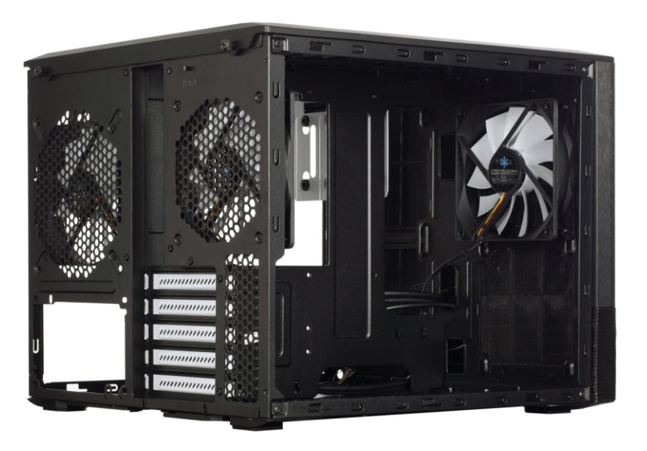

August 29, 20196 yr Author I also prefer not having any small fans on the Dell Perc. I'm attaching a picture of Node 804 here, so you can visualize the amount of air that passes through. Used to be, I didn't have any problems with errors with the drives. All of a sudden, I do. The most recent testing that still produced the multiple errors in the drives, I had my case, left and right, wide open. Not sure if it's the lack of pressure within the chamber that caused not enough airflow through Dell heatsinks If there is such a thing.
August 29, 20196 yr As it is summer, there is one more option. Is the ambient temperature in the room where the system stands higher than usual ? If you have been operating the system at borderline temperatures over the year, this could be a reason (And a wide open case does not help in heat dissipation as the airflow is no longer directed over the hot components). In my office where my unraid box stands (also a node 804 by the way) the temperature during this summer is significantly higher than the last years and this has an effect on all the equipment within the case. So I am running all fans at max level currently to keep temperatures in the case at an acceptable level. Cooling the HBA with a 40mm fan might not seem to be the best option, but it definetly helps in controlling the temperature of the HBA. Just use a quality fan like the ones from Noctua. If you use a motherboard fan connector to power the fan you might also be able to get a warning when the fan does not turn. Edited August 29, 20196 yr by Kevek79 Typo

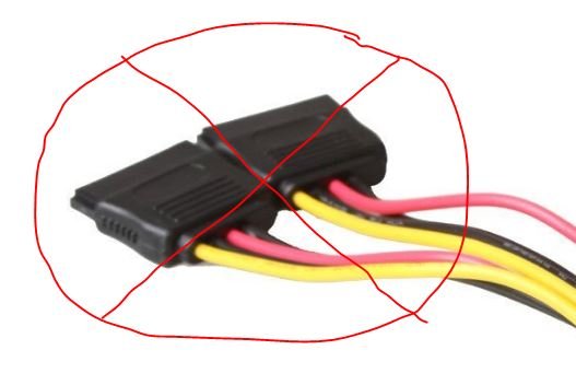

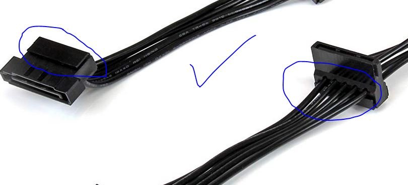

August 31, 20196 yr Author @Kevek79, Thanks for the tip. Indeed, had a Noctua fan connected to the M/B directly. Installed it last night. I can see the fan running. Unfortunately, still having issues. Same problem. This actually eliminates the temp of HBA as the root cause. I am attaching my diagnostics again here. I hope people here can help identify issue. @johnnie.black, hope you can help take a look. @Michael_P, I am using the one marked X . My psu doesn't have enough modular ports to connect the correct type of splitter. I hope it's not that serious. tower-diagnostics-20190831-0027.zip

August 31, 20196 yr Community Expert 11 hours ago, jang430 said: @Michael_P, I am using the one marked X . My psu doesn't have enough modular ports to connect the correct type of splitter. I hope it's not that serious. The one with the check mark is a splitter, but it's not molded connector. The problem with the molded connectors is how they're laid in the mold, the only way to QC them to ensure there isn't any strands touching or too close is to x-ray them as they come off the line - and at that price point they're not doing it. Google molded sata power splitter and you can read some horror stories. I had one in my desktop PC for years, one morning I noticed it had shut itself off overnight so I turn it back on - bright flash, smoke, unhappy noises and the splitter was on fire. I thought it was just a fluke, until I happened across a youtube video a couple days later (crazy coincidence) of a guy building a NAS who had the same thing happen to him, he made a video dissecting the connectors and showing the problem.
