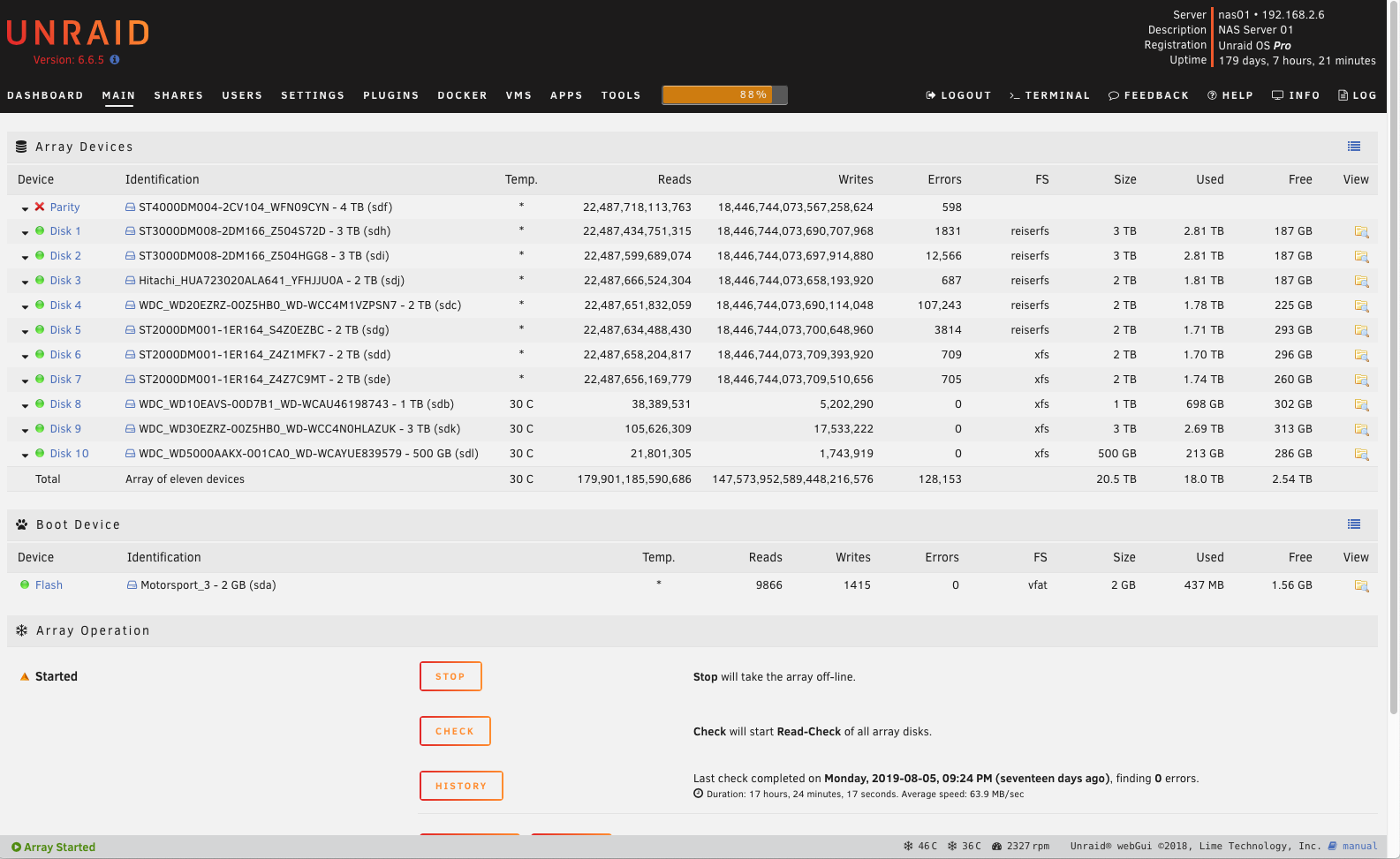

I woke up this morning to a warning on my dashboard that my parity drive was in failed state. I also noticed that seven of my other drives were showing errors. Screenshot below:

Thoughts on where I go from here? Did I lose my data across the first seven drives?
Based on the screenshot looks like a controller problem, the one connected to the 8 drives with errors, make sure it's well seated and cooled, if possible try a different slot, if it keeps happening could be going bad.

Those errors are normal if the HBA stopped working, but Unraid only disables one disk max with single parity, 2 with dual parity, and luckily parity was the first one to error so the one that got disabled, errors will be reset after a power cycle, data on all disks should be fine, just parity will need re-synching.
