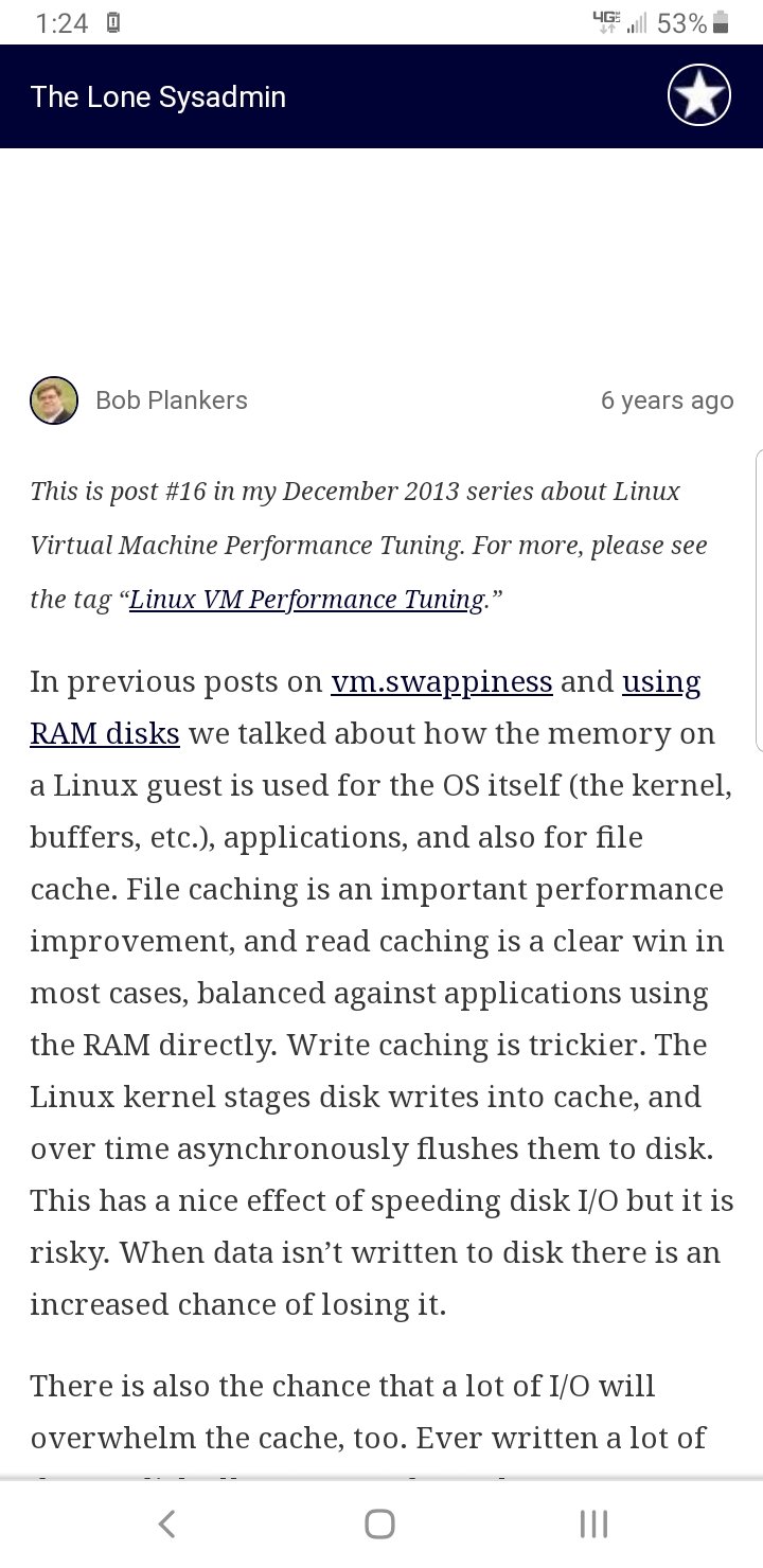

October 7, 20197 yr Community Expert RAM cache is mostly controlled by these: sysctl vm.dirty_ratio - default is 20% free RAM sysctl vm.dirty_background_ratio - default is 10% free RAM You can experiment and set them higher but note that performance will likely suffer when more data needs to be committed. See here for an explanation what theses values change: https://lonesysadmin.net/2013/12/22/better-linux-disk-caching-performance-vm-dirty_ratio/ Edited October 7, 20197 yr by johnnie.black
October 7, 20197 yr Author 19 minutes ago, johnnie.black said: RAM cache is mostly controlled by these: sysctl vm.dirty_ratio - default is 20% free RAM sysctl vm.dirty_background_ratio - default is 10% free RAM You can experiment and set them higher but note that performance will likely suffer when more data needs to be committed. See here for an explanation what theses values change: https://lonesysadmin.net/2013/12/22/better-linux-disk-caching-performance-vm-dirty_ratio/ Hmm, even at default ratios, those amounts would be hugely more than my file transfer sizes. Maybe something else is the issue? Even transferring world of warcraft (classic) over the network take minutes, not tens of seconds. It's a 4.5gb file, and I'm seeing a peak of 200MB/s, then a drop to 5, etc. At default values it should load into ram instantly, basically. Edited October 7, 20197 yr by Hikakiller

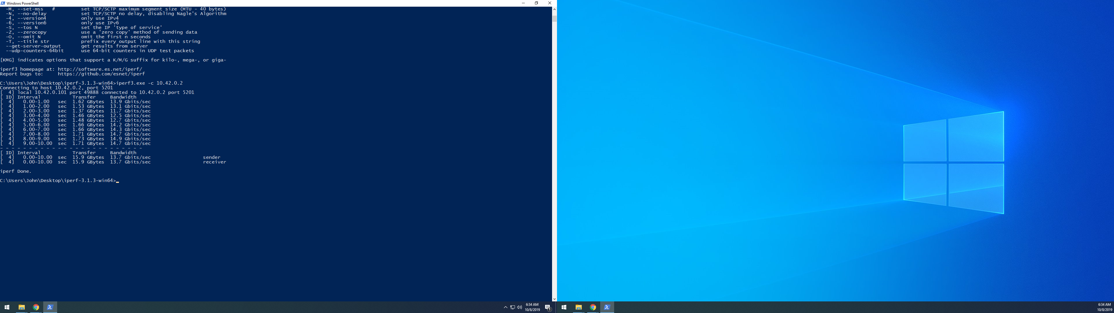

October 8, 20197 yr Author 6 hours ago, johnnie.black said: Link speed doesn't really matter, why I suggested using iperf to test network bandwidth. Here are my results.

October 8, 20197 yr Community Expert 5 hours ago, Hikakiller said: Here are my results. Don't understand how results can be faster than 10GbE.

October 8, 20197 yr Author 53 minutes ago, johnnie.black said: Don't understand how results can be faster than 10GbE. Sorry, this is a vm on the unraid array.
October 8, 20197 yr Community Expert 9 minutes ago, Hikakiller said: Sorry, this is a vm on the unraid array. So no point in doing that, you need to test with the computer you're copying from as source.
October 8, 20197 yr Author 24 minutes ago, johnnie.black said: So no point in doing that, you need to test with the computer you're copying from as source. Ah, sorry. My main windows computer is virtualized on my unraid machine. Edited October 8, 20197 yr by Hikakiller
