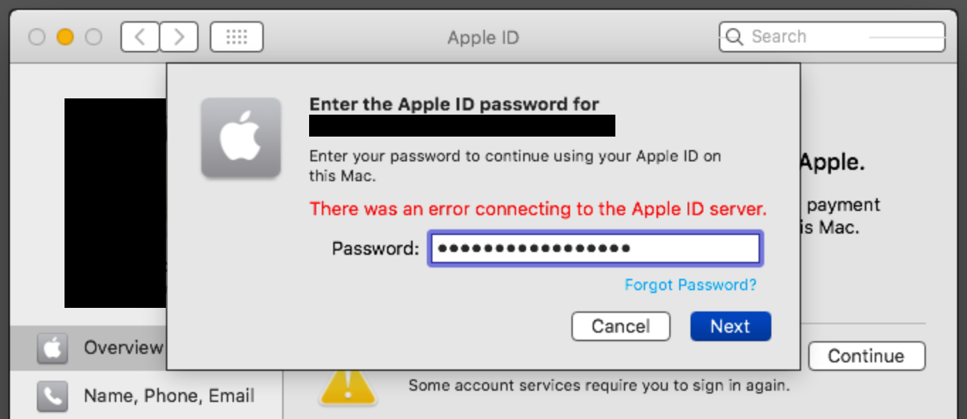

October 14, 20197 yr tl;dr: My Catalina VM doesn't like the same bridged network configuration I used with High Sierra and Mojave, and I can't make any sense of it. I've been running a simple (no GPU or other passthroughs) macOS VM on my Unraid server for years now--first High Sierra, then Mojave, and now Catalina. Before Catalina, I always successfully used a bridged network configuration like this (phony MAC address below): <interface type='bridge'> <mac address='00:11:22:33:44:55'/> <source bridge='br0'/> <model type='e1000-82545em'/> <address type='pci' domain='0x0000' bus='0x00' slot='0x05' function='0x0'/> </interface> When I boot Catalina with the configuration above, however, things go really strangely--the Ethernet cable is reported as unplugged, the system lags, the menu bar either never appears or is only ever partially rendered, sometimes the keyboard doesn't work at all, and I can't ever successfully shut down. I use Clover as my bootloader, so I tried this configuration with both same older bootloader and UEFI driver versions that worked with Mojave, as well as with everything updated to Clover v2.5k 5070; I saw no difference either way. So, I changed to a non-bridged configuration, like this... <interface type='network'> <mac address='00:11:22:33:44:55'/> <source network='default'/> <model type='e1000-82545em'/> <address type='pci' domain='0x0000' bus='0x00' slot='0x05' function='0x0'/> </interface> ...and everything works fine, which is surprising, given that it is still a virtual e1000-82545em NIC with the same MAC in the same virtual PCI slot. I wouldn't imagine that Catalina would even know the difference! It's better than nothing for the moment, but I really do need the VM to be bridged for my purposes. So, as another experiment, I tried bridging using the 'vmxnet3' virtual NIC, like this... <interface type='bridge'> <mac address='00:11:22:33:44:55'/> <source bridge='br0'/> <model type='vmxnet3'/> <address type='pci' domain='0x0000' bus='0x00' slot='0x05' function='0x0'/> </interface> ...which sorta surprisingly does make Catalina work properly, except I get bumped off all Apple cloud services, and System Preferences asks me to log in again. By itself, that isn't shocking, since I did change the (virtual) hardware out from under Catalina. The surprising part is that Catalina then can't reach the Apple ID servers: I did a fair amount of Googling about this result, and while I couldn't find anyone really getting into a discussion or analysis, I did find a few offhand references to vmxnet3 causing iCloud login woes. So, out of desperation, I tried installing Catalina again using vmxnet3 bridging from the start, but it made no difference. So, does anyone have any idea why a straightforward e1000-82545em bridge that worked fine under High Sierra and Mojave might cause Catalina to melt down? Or (though I'd much rather just get the e1000-82545em bridging working) does anyone have any experience getting communication with the Apple ID servers working properly with a vmxnet3 bridge? Thanks for any help! Edited October 16, 20197 yr by bland328 Clarified a couple points
October 16, 20197 yr Author Edit: I wasn't quite right about this! It's true that that some or all of Apple's online services require communication over an en0 device that appears to be "built in"...but vmxnet3 does appear as a built-in interface if the system configuration is right. For my earlier testing, my virtual vmxnet3 interface was configured on bus 3/slot 0, in which case macOS decides it isn't built-in (IORegistry says IOBuiltin=False and IOPrimaryInterface=False, though I'm not clear if the latter matters). When I move my vmxnet3 to bus 0/slot 5, macOS does see it as built-in (IORegistry says IOBuiltin=True and IOPrimaryInterface=True). However, I still can't use it to log into to the App Store, as I get a "There was an error connecting to the Apple ID Server" error. If I switch back to an unbridged e1000-82545em configuration, I can log into the App Store. But, then I can't bridge, or Catalina has a nervous breakdown. Some progress on this...it looks like vmxnet3 simply won't work for Apple cloud services (including the App Store) by design, because macOS (for whatever security reasons, I suppose) requires a built-in Ethernet adapter for such things. Since vmxnet3 is a paravirtualized NIC powered by an Apple driver, it makes sense that macOS would know it isn't a real, built-in NIC. Just to confirm, with vmxnet3 networking active, I used IORegistryExplorer (an Xcode-related developers' tool) in the Catalina VM to search for 'en0' and, sure enough, found: IOBuiltin Boolean False So, vmxnet3 doesn't look like a good solution for those of us who use iCloud/iMessage/App Store/etc. At least, not without some low-level game playing that I'd rather not get into, if I can avoid it. So, that focuses my question: Why might bridging to br0 using e1000-82545em work under High Sierra and Mojave, but not Catalina? Is there a macOS virtual networking guru out there (perhaps even @SpaceInvaderOne?) who might be able to point me to something to analyze or try? Edited October 19, 20197 yr by bland328 I was wrong.
October 17, 20197 yr Just to add to your findings that I also have problems with Catalina and icloud login with e1000-82545em (only in the preference panel, it works ok with the web browser). I cannot track what apple checks, since sometimes it works sometimes it doesn't work, and it fails with very generic errors. iCloud was working with e1000-82545em and Catalina, iMessage didn't work, so I logout from all, reset icloud, removed the mac os vm from the list of "find my phone" and "my devices". I also enabled the 2 factor authentication, the code is delivered than a message is displayed ("cannot verify your identity") than it hangs (preference panel). I have to try the ethernet passthrough and wait for the mac pro 2019 to be on the market as my last chance.
