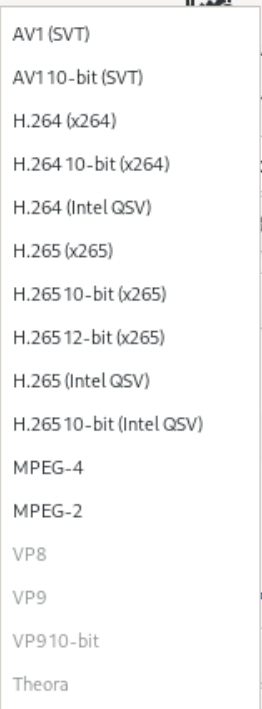

SRTG Posted May 19, 2023 Share Posted May 19, 2023 (edited) I'd like to bump this. I have the same issue as @Alvin Leong except I'm using Plex. HW transcoding works fine but I can't seem to enable quicksync on handbrake. I've added /dev/dri as a handbrake device parameter so if Quicksync works in Plex it should show up here. I added the below to the "go file" but no joy. modprobe i915 chown -R nobody:users /dev/dri chmod -R 777 /dev/dri If anyone could provide a steer it would be much appreciated! Edited May 19, 2023 by SRTG Quote Link to comment

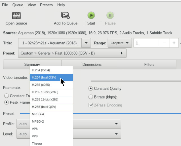

Hoopster Posted May 19, 2023 Share Posted May 19, 2023 3 hours ago, SRTG said: If anyone could provide a steer it would be much appreciated! Have you created a preset in HandBrake that uses the QSV encoder? Do QSV encoder options appear in the video encoder list in HandBrake? If not, the container is not setup properly with /dev/dri Quote Link to comment

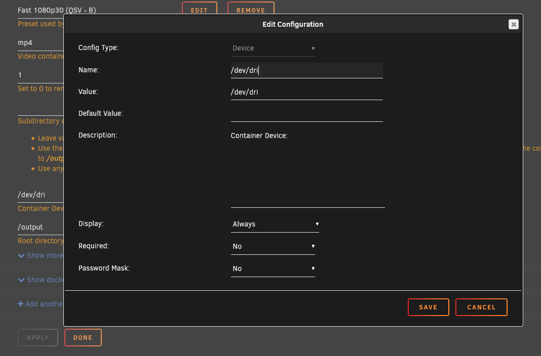

SRTG Posted May 20, 2023 Share Posted May 20, 2023 17 hours ago, Hoopster said: Have you created a preset in HandBrake that uses the QSV encoder? Do QSV encoder options appear in the video encoder list in HandBrake? If not, the container is not setup properly with /dev/dri The QSV options don't appear in the dropdown. Mine still look like this: I've already added /dev/dri device as below but still no luck. Quote Link to comment

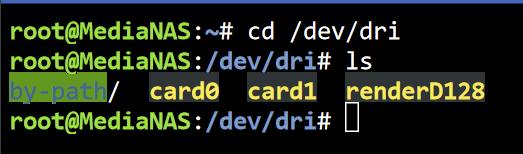

Hoopster Posted May 20, 2023 Share Posted May 20, 2023 59 minutes ago, SRTG said: I've already added /dev/dri device as below but still no luck. Do you get any errors related to /dev/dri when your Handbrake container starts? Post your docker run command. In a terminal session, if you type the following commands what do you see? cd /dev/dri ls You should see the following (card1 does not need to be there). If you do not see this, your system is not loading the i915 /dev/dri drivers. You do not mention what version of Unraid you are running, but from version 6.9.0 and greater, go file entries for modprobe i915 are no longer recommended.; although, I suppose it may still work. I am using the "touch" method to load i915. See the release notes for more information. For example, here are the 6.9.0 release notes on GPU drivers: Quote Link to comment
SRTG Posted May 20, 2023 Share Posted May 20, 2023 52 minutes ago, Hoopster said: In a terminal session, if you type the following commands what do you see? cd /dev/dri ls You should see the following (card1 does not need to be there). If you do not see this, your system is not loading the i915 /dev/dri drivers. Yes, in terminal I see card0, render D128. I'm running UNRAID 6.11.5. I did notice something in handbrake_activity_logs.txt. It seems to confirm QSV is available but it can't locate the driver ? I'm a little confused on how Plex can see this but Handbrake can't. So a possible solution is terminal: touch /boot/config/modprobe.d/i915.conf ? Thanks for your help so far! Quote Link to comment

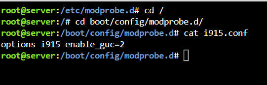

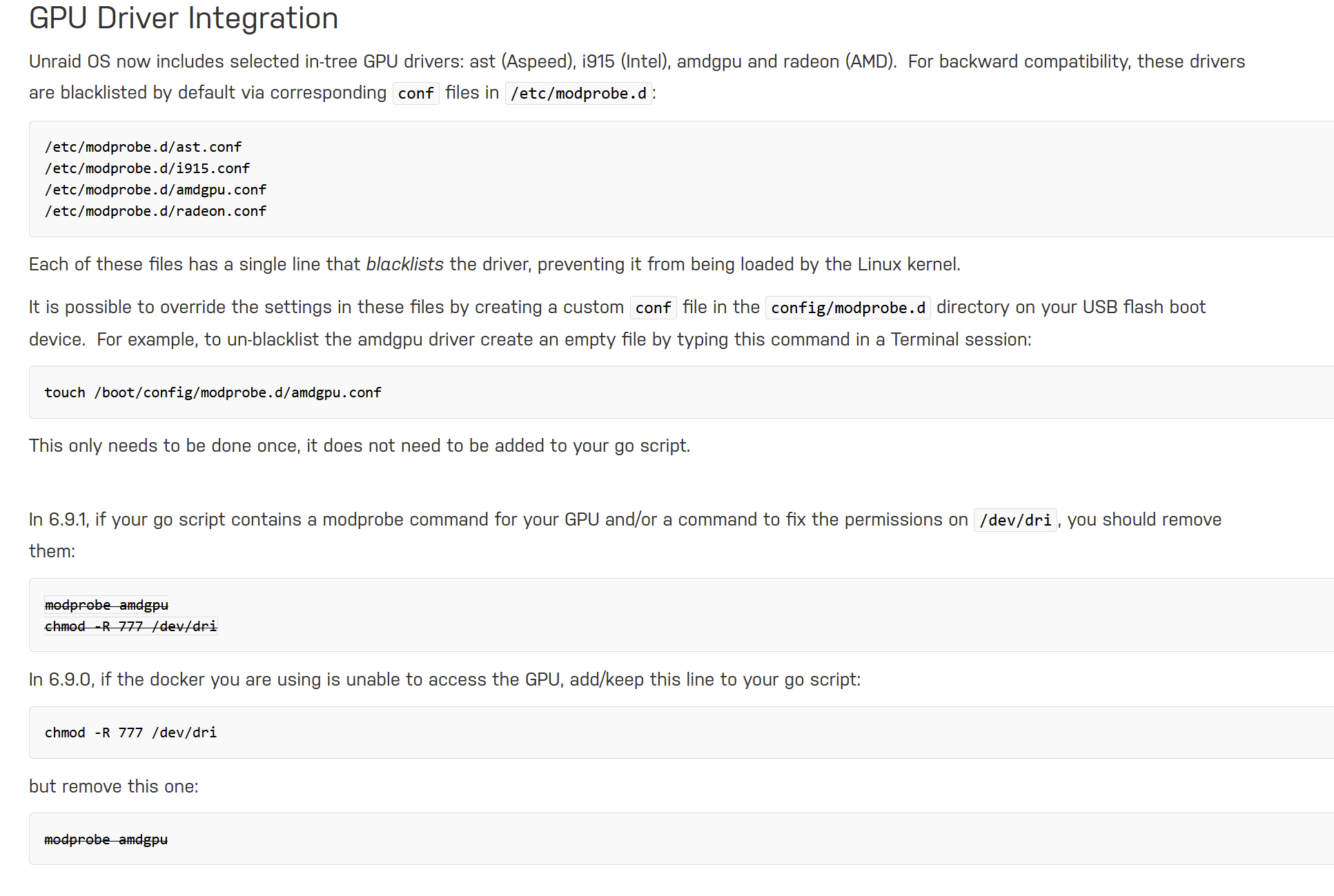

Hoopster Posted May 21, 2023 Share Posted May 21, 2023 On 5/20/2023 at 9:29 AM, SRTG said: So a possible solution is terminal: touch /boot/config/modprobe.d/i915.conf ? I just built a new server last week on which I installed Handbrake. I am running Unraid 6.11.5 on that server. I noticed I had no QSV Handbrake options on that server. I had no i915.conf file there either; however, I recall that in an Unraid release after 6.9.0 (I do not recall which one), it was mentioned that Unraid would now automatically load the i915 drivers if an iGPU was detected. As a test of that theory, I did not create an i915.conf file via the touch method on this server. The only thing I did to get the QSV encoder options to show up in Handbrake on this new server was to add the /dev/dri device. I am currently running a Fast 1080p30 H.265 QSV encode on that server. My /dev/dri device looks no different than yours, yet it works for me and not for you. Perhaps try posting in the Handbrake support thread? Quote Link to comment

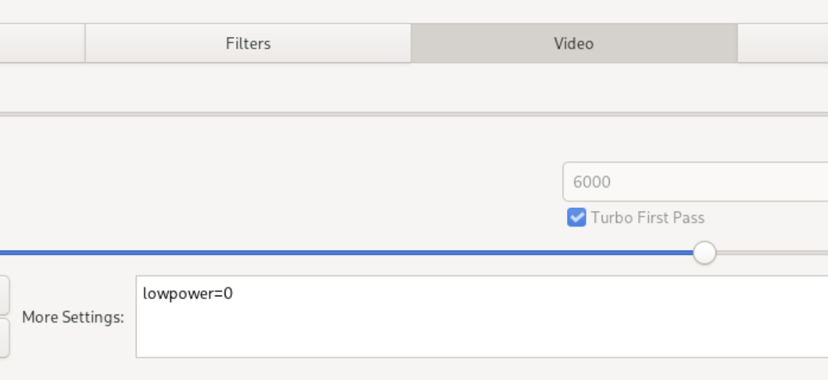

Hoopster Posted May 22, 2023 Share Posted May 22, 2023 (edited) @SRTG Of course, you cannot even get the QSV encoding options to show up, but, when you do, here is another tip should you get encoding failures when attempting QSV encoding in Handbrake: I don't know what CPU you are using, but in examining my Handbrake QSV preset, I remembered a setting I needed to add to get QSV to work with the 11th Generation i5-11600 CPU in that system. Prior to adding this, I would get an "encoding failed" message on all encoding attempts with QSV. Rocket Lake/11th gen CPU/iGPUs had problems with low power QSV encoding which is the default for Handbrake. I had to turn off low power mode in the QSV presets by adding "lowpower=0' to the "More Settings" box in in the Video tab. So I did not have to add this each time, I made sure to resave the Preset with this setting. Edited May 22, 2023 by Hoopster Quote Link to comment

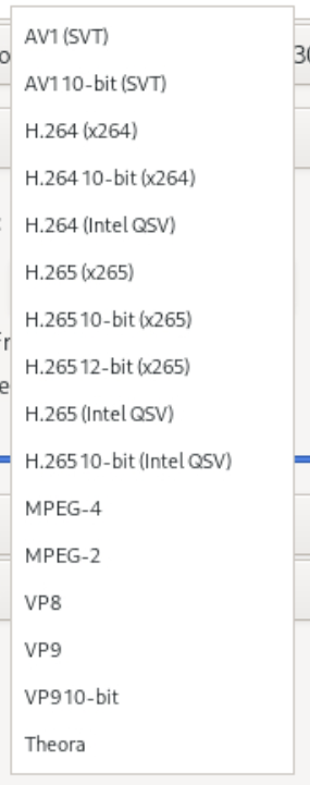

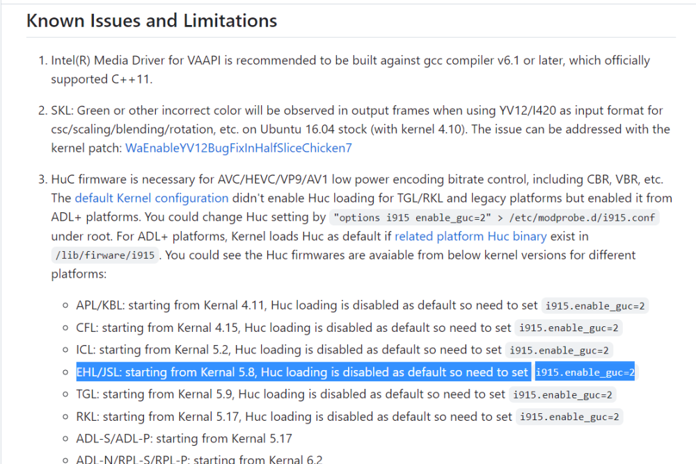

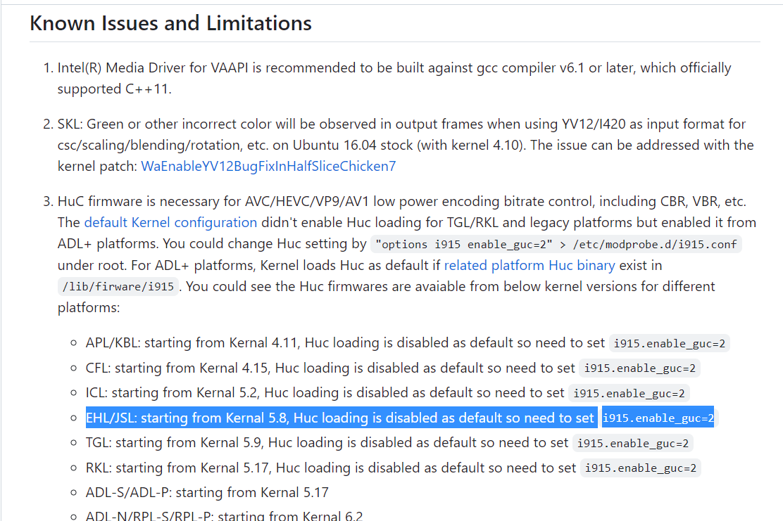

mellow65 Posted July 7, 2023 Share Posted July 7, 2023 I'm going to drop some head pounding, time sucking, information that has taken me the better part of 2 days to figure out, and every time I went searching this thread kept coming up so I feel this may be the best place to drop it for any future poor soul that tries to figure it out. I have been trying to figure out why my 10th gen Intel Celeron Elkhart Lake J6413 would not show the QSV options. Even though in handbrakes activity screen it says "qsv is available on this system", I went down every rabbit hole, every random thread I could find. I followed all the things in this thread even though I'm running 6.11.5 and some of the things weren't needed. I think the main issue I was running into was the fact that my CPU/GPU only supports low power mode (according to the jellyfin documentation). Which when I was running my server off of an i7-8700T, I never had a single issue, and the QSV options just came up. When I was on the handbrake site looking at the QSV documentation, https://handbrake.fr/docs/en/latest/technical/video-qsv.html There was a link to a github "Known Issues and Limitations" for intel media drivers. https://github.com/intel/media-driver#known-issues-and-limitations This got me trying to put "options i915 enable_guc=2" in all the locations the "i915.conf" file may live. What ended up working for me was putting "options i915 enable_guc=2" in the /boot/config/modprobe.d/i915.conf. This does copy down to the /etc/modprobe.d/i915.conf on reboot. I hope this can help anyone in the future if you come upon this. Quote Link to comment
