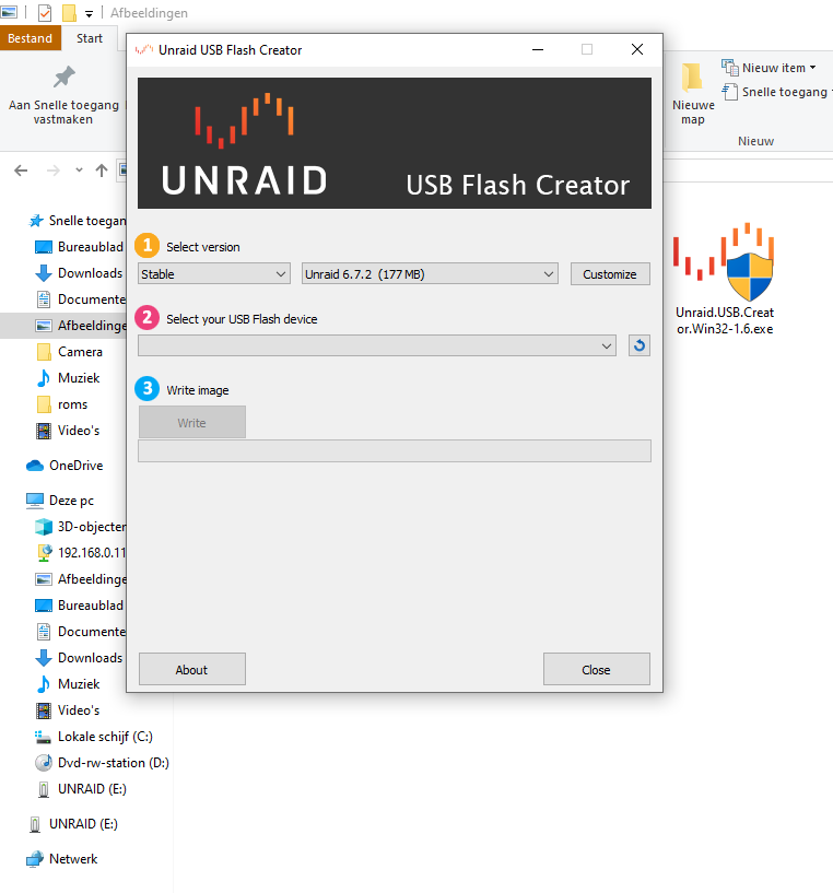

Firstly the USB creation tool doesn't detect the (formatted to FAT32) USB Stick:

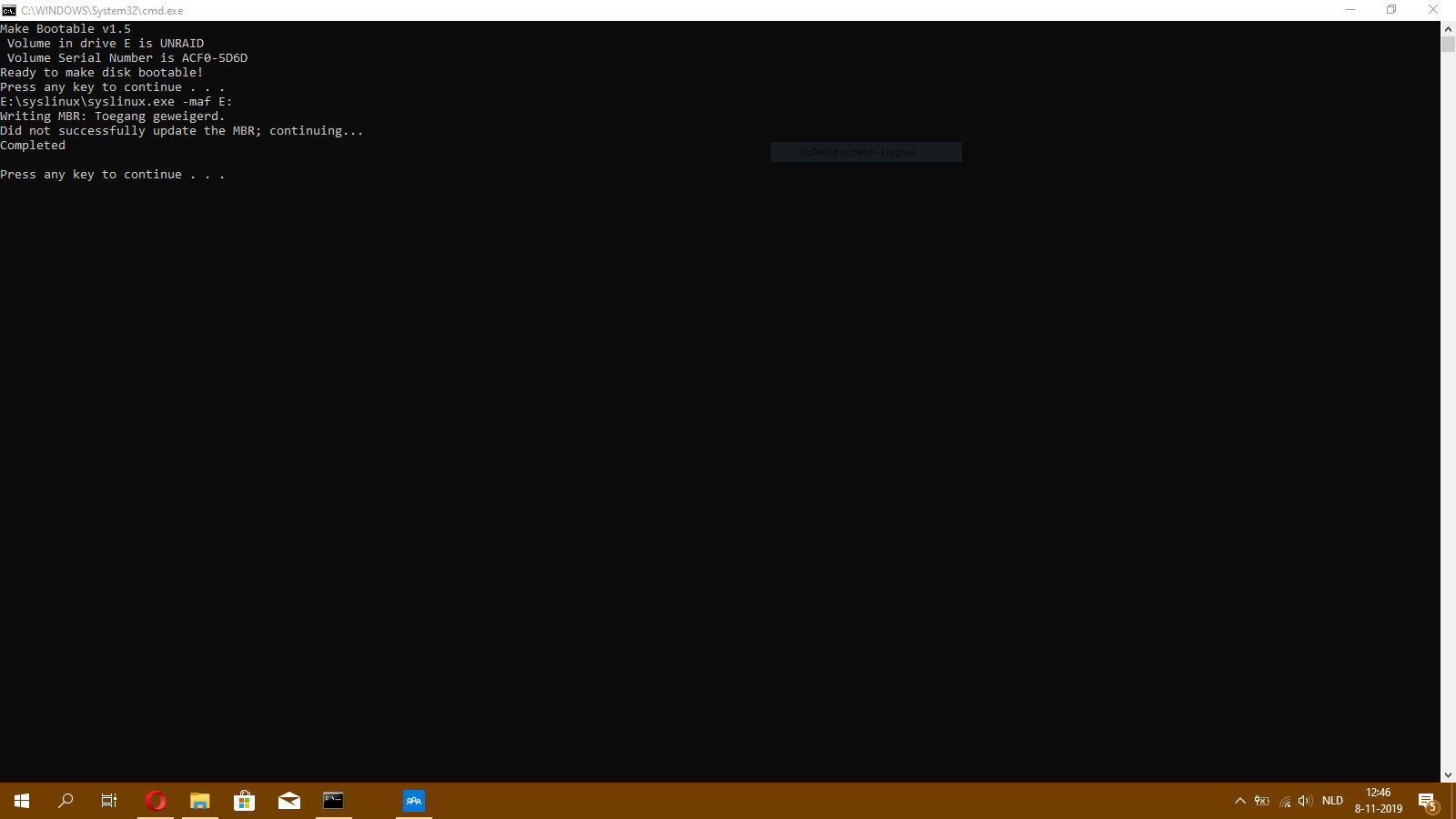

So of course I tried doing it manually which gave me a "MBR DENIED" error:

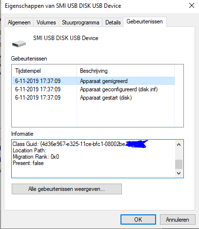

41 minutes ago, trurl said:
GUID is the globally unique identifier required to assign an Unraid license to the flash drive. Without it you won't be able to use it with Unraid. Not saying it doesn't have a GUID, we don't know. And I don't know if that is any reason it shouldn't be able to prepare it for booting.
Might be simpler if you just try a more reputable flash drive.
It does have a GUID. (I don't know how senitive it is so I did 'blur' some numbers)

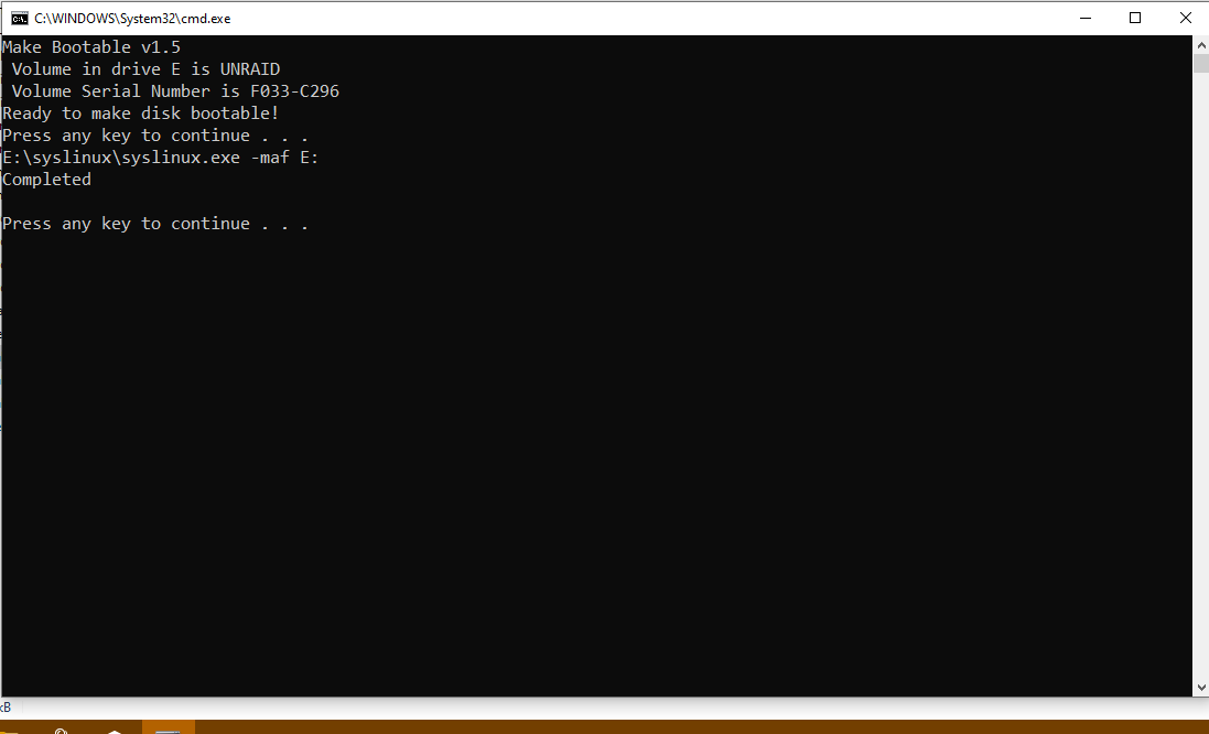

Thx so much!
Ive found a loophole where i made it MBR with a Kubuntu iso using Rufus (the .zip for unraid won't work in rufus apperently). I then deleted all contents that was extracted from the iso. Extracted the unraid zip to the usb drive. Ran the cmd commandline and no more MBR rubbish!
