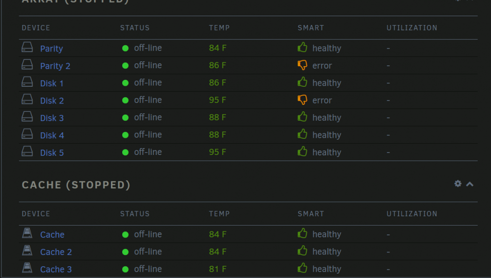

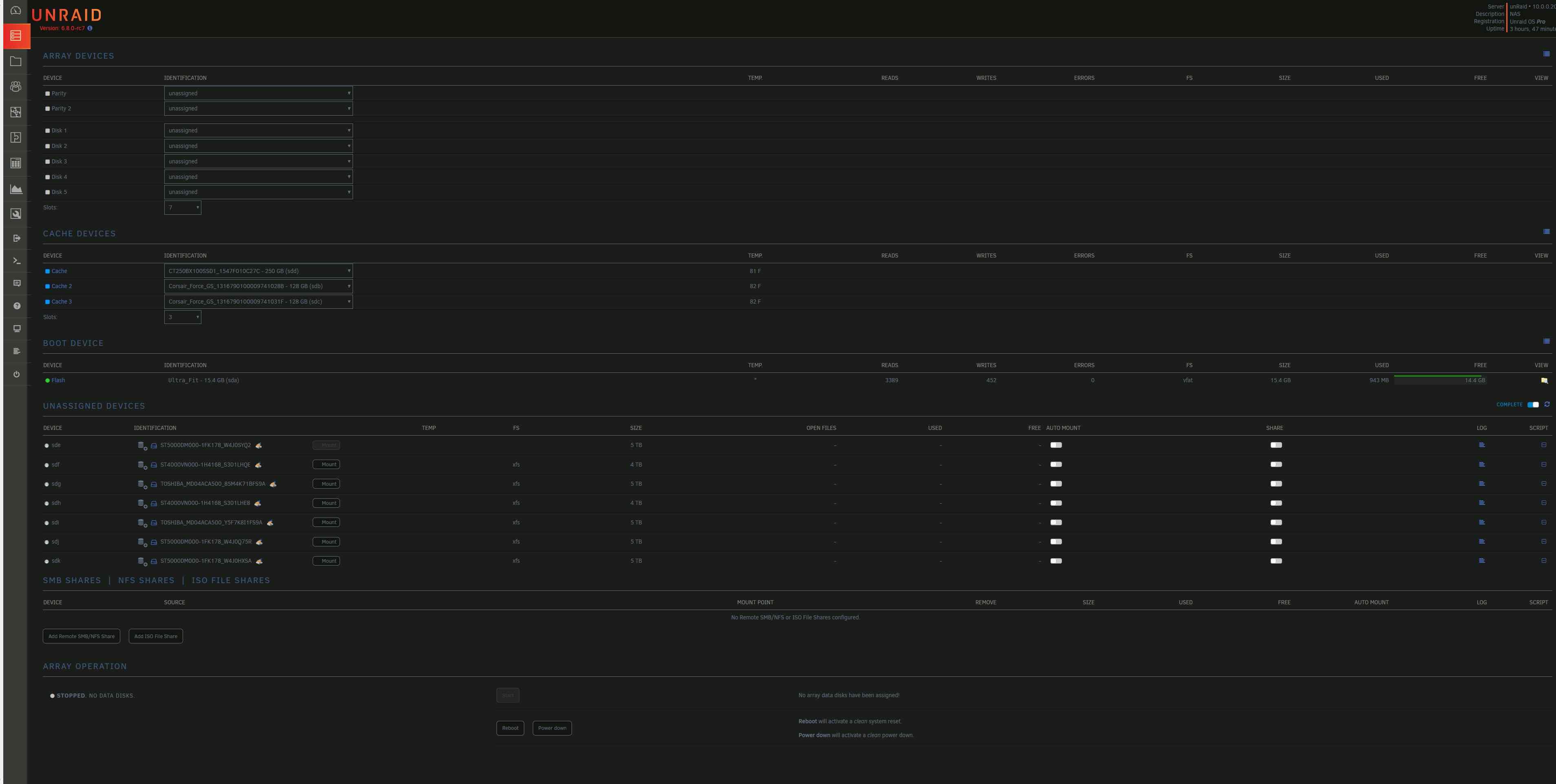

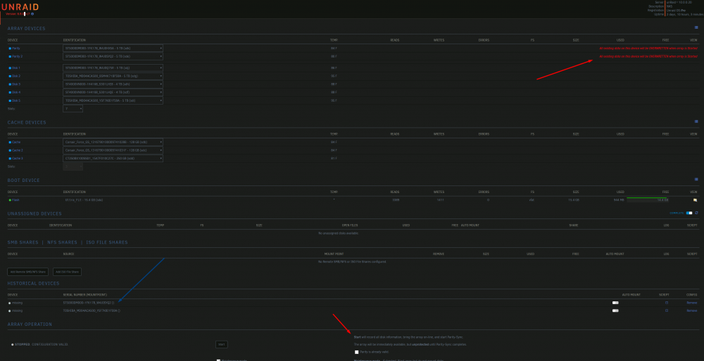

So ill go ahead and said it, i was clicking buttons i didnt understand lol. This is what I did:
unraid-syslog-20191126-1931.zip
unraid-diagnostics-20191126-1919.zip
So 1 of my 5tb is definitely dead dead, but im comfortable holding out till next week to maximize cyber week. But what i was dicking around with was my cache pool. I did have 4 ssds in raid 0, 2x 250gb and 2x 128gb. I yanked one last nite for another pc that i needed access too, and i was overkill with this setup as 4 as is. I was having issues though rebuilding my btrfs cache pool with the 3 ssds i have left. Luckily i had my appdata folders backing up every week, so the only data loss im gonna miss from the cache drives would be whatever was still waiting to the mover schedule to kick in. But now im afraid to touch it because im fairly certain i havent totally bricked all my data yet because i thought if done correctly this is still salvagable, but 1 more fuckup and i could be dead in the water. Loosing roughly 20tb of data. alot of it being irreplaceable. I spent some time trying to figure it out on my own but im worried that i could misinterpret something and still ruin all the data. So i wanted to check in with the pros here that point me in the right direction to salvage my data.
Thanks in advance for the input!
~Acps

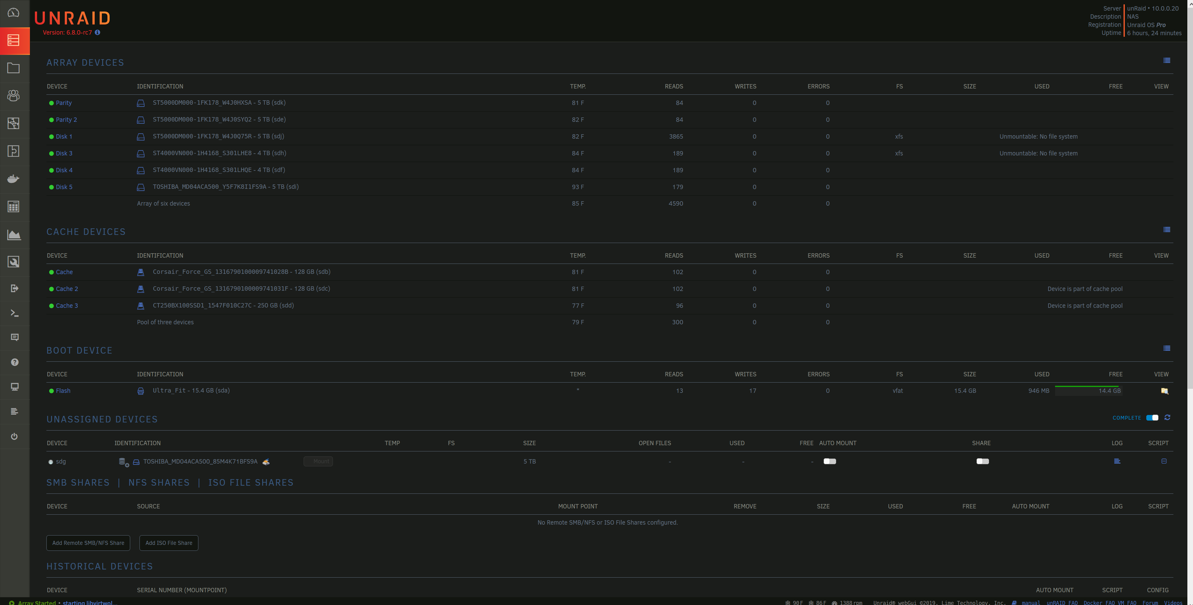

I would suspect that the unformatted 5TB drive (in the  unassigned section) is actually your parity drive.   The other six unassigned drives which are formatted are the data drives.
I would also suspect that the TOSHIBA MD04ACA500  (sdg) drive with the serial number ending in FS9A is on its last legs.  Do you think that your parity was valid before this hiccup occurred?  That would effect how you might approach the recovery operation.  If parity was good, then you could just rebuilt this disk onto a replacement.  But be careful with what you do as you could lose the option by not doing correctly.   (In my opinion, the last thing you want to do at this point is to attempt to rebuilt parity with that disk (Serial# ...FS9A) installed as I suspect that the parity operation will fail...)

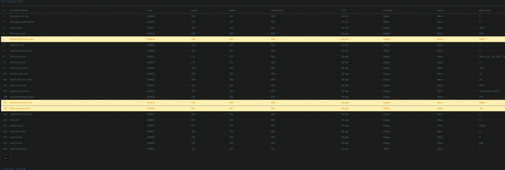

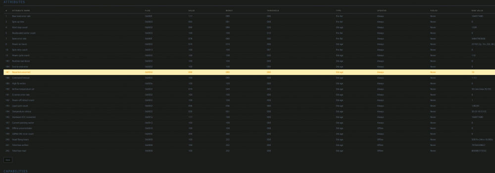

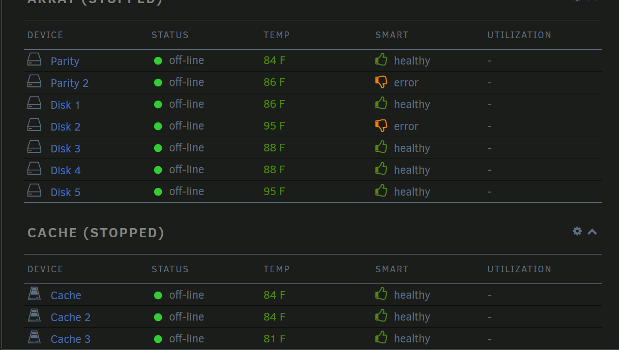

Now Disk2 which is sdg, is definitely bad, its been dead dead. its been like that for several weeks and i tried many times to try and rebuild the array with it to see if it was a fluke, but i 3-4 times it always ended up failing and being emulated data, but i had dual parity so i wasnt worried. Parirty2 sde which is that drive that looks unformated was the other drive i had an issue with. But it was a 1 time fluke because it hasnt had a single issue since it reported a few errors.
Disk2 sdg
Parity2 sde

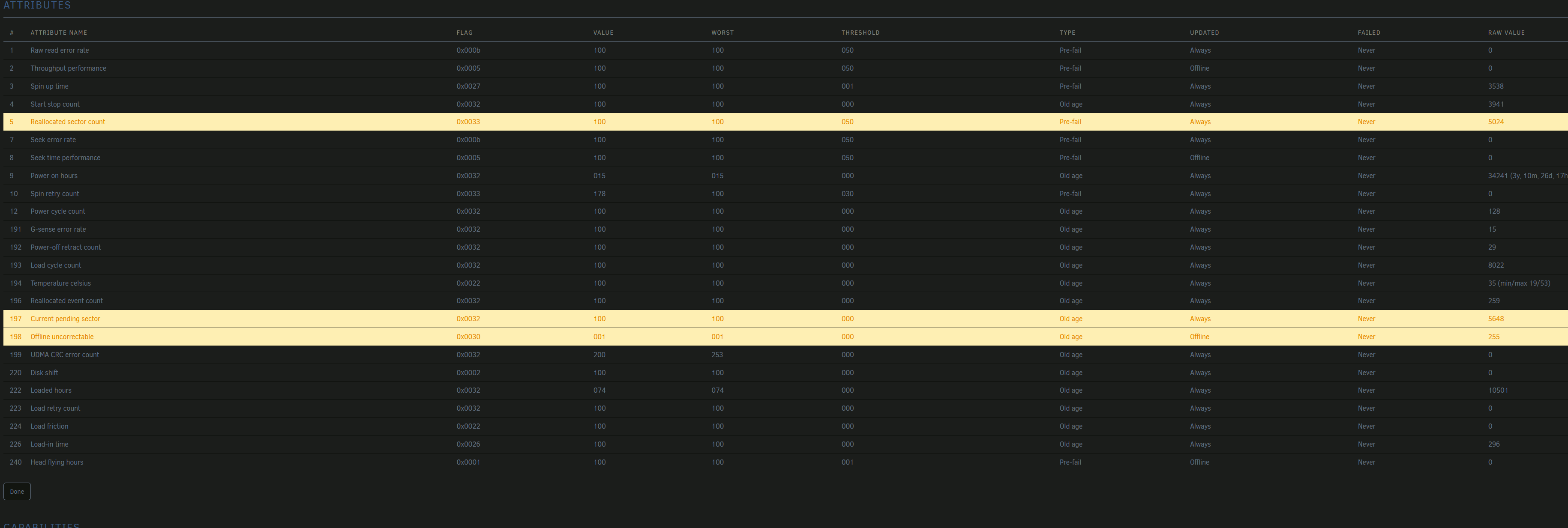

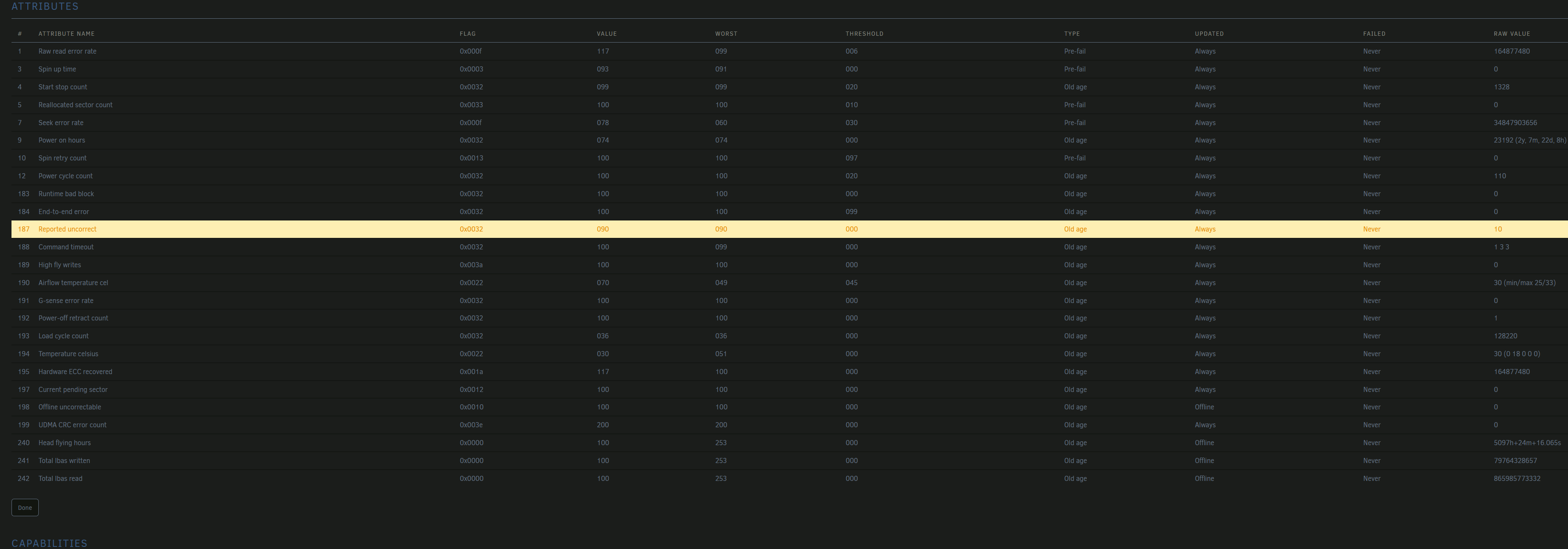

Looking the smart health tho its showing they both have errors:
But i thinks that because they got unassigned and reassigned. Because i acknowledged them after i try and rebuild the array to see if itll occur again.

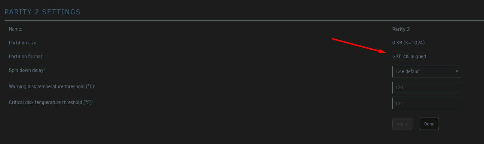

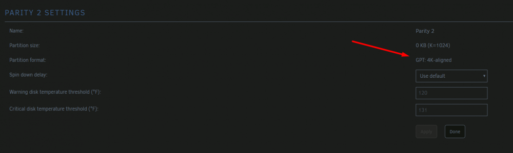

Parity2 sde the one showing unformulated was confusing me too, but once i assinged it back into its slot in the array it says it was formated just fine.

So after all the pics and walls of text, i hope that clarifies what i did and hopefully, i just need to start the array and let the parity sync run. But i was worried because in the first pic i posted of the drives assinged but not mounted, the 2 raid arrows are contradicting each other. That red text saying id loose all my data didnt popup till after i assinged both parity and then assinged disk1. So im afraid to try it until i hear back from someone who has a much better understanding of this than me, so ty for the help so far and hopefully someone can confirm i can rebuild it just fine. If thats not the case. I would want to try and recover as much data as possible from the disks without trying to rebuild the array and possible write over the good data thats still there.

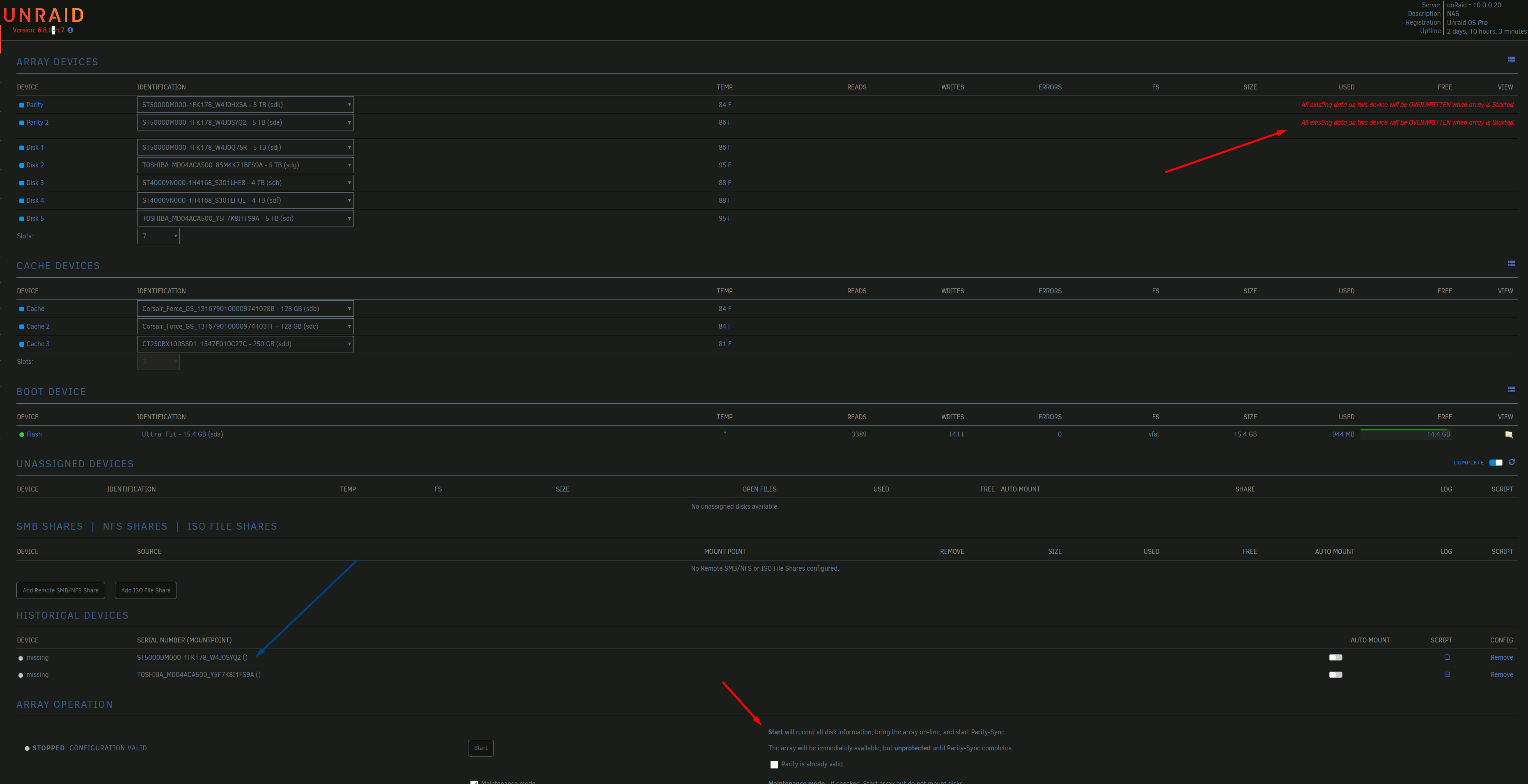

Ok so i was able to bring my array back online without disk2, and checking parity is valid, however disk2 data isnt being emulated like it was before. I do have a replacement hdd thatll be here tuesday. Is the data being stored on disk2 still recoverable? Or how do i emulate the data from the parity drives?

Stop at this point.  Don't allow any writes to the array.  What happened to the physical disk 2?  Did you take it out?  I believe you should have included it in the assignment of disks if the server could detected it (even if it is bad!) and thus its contents could be emulated.  I am going to ping @johnnie.black again but I believe he is in Europe so he probably won't see this until tomorrow.  (I have had very few issues with my servers so I don't have much experience in fixing the more complex problems.  He seems to have many servers running and seems to have accumulated a lot of knowledge in "how to deal" with these types of things.)

I literally did this, since i did not have a spare i unassigned disk2. I didnt remove it its still sitting in my server plugged in just as an unassigned disk.
it sounds as if you did not start the array with disk2 assigned and then stop it to unassign the disk and restart the array?    That would have left you with disk2 being emulated.   If you did the unassignment without that initial start then it would not be emulated (and parity would be invalid).
Has  anything been written to the array in the meantime?   Have you tried to rebuild parity?
THats exactly what i did, i guess i missunder stood johnny. i did some appdata backups, but as far as i know thats all to the cache drive. so i dont think anything beens wrriten array. Will rebuilding the parity make disk2 data unrecoverable?

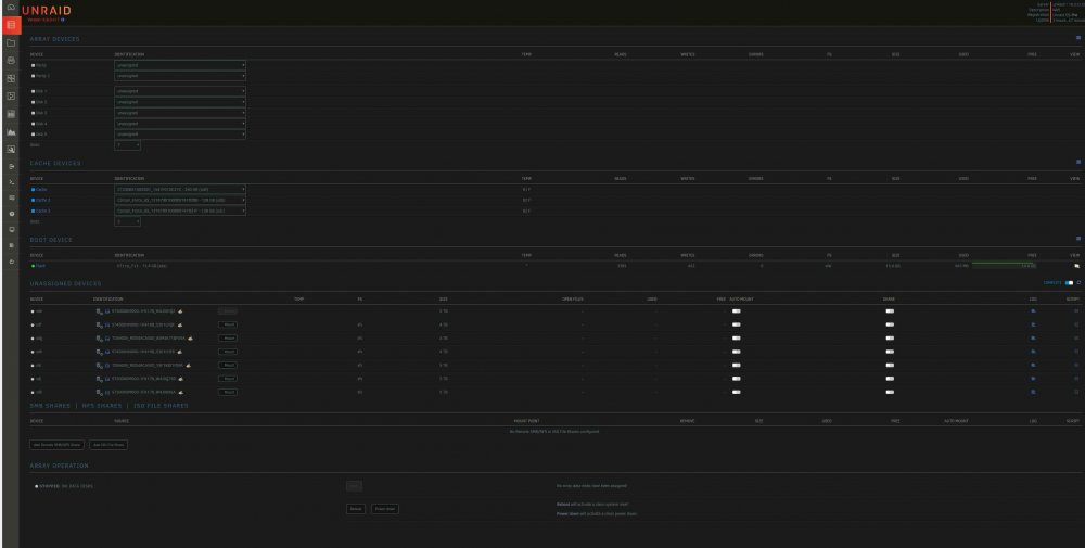

Can the drive be mounted when it is shown as an Unassigned device?
You should be able to mount old disk2 with UD plugin and copy everything you can, alternatively you can clone it with ddrescue.

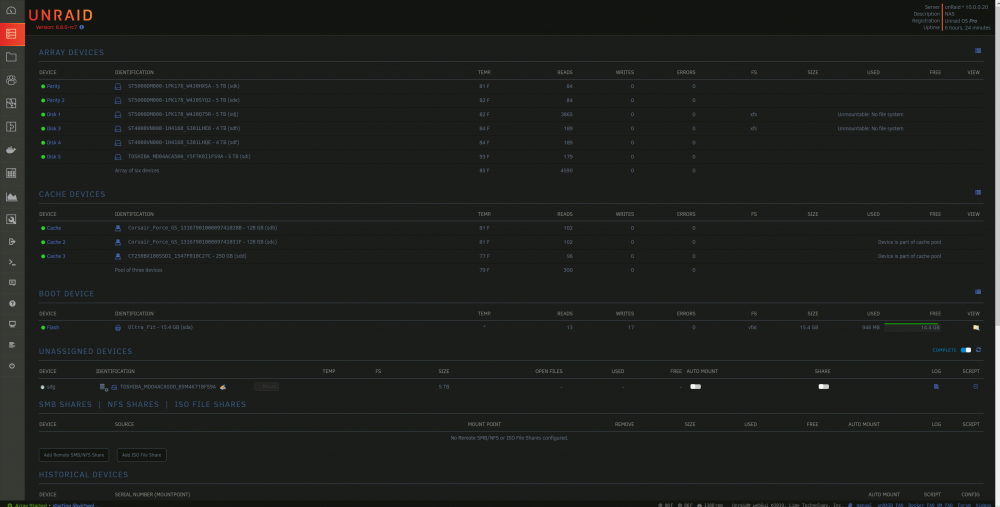

Cant mount,no file system and unraids MBR is missing so I think data recovery is no longer an option. Atleast I didn't loose my entire array. Frustrating part is not knowing exactly what I lost.
To make things worse, Disk 1 and 3 now are unmountable with no file system present. After trying to add disk 2 back to the array:
Niether disk shows any errors and smart reports are clean. I got a feeling the raid controller i was told needed to be replace is coming back to haunt me...

Controller driver crashed, reboot and post new diags.
