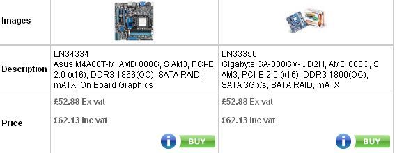

Motherboard suggestions...based on scan.uk availability and $ (limited DDR2 and on-board graphics selections in-stock)
see attached (requires DDR3 memory)
