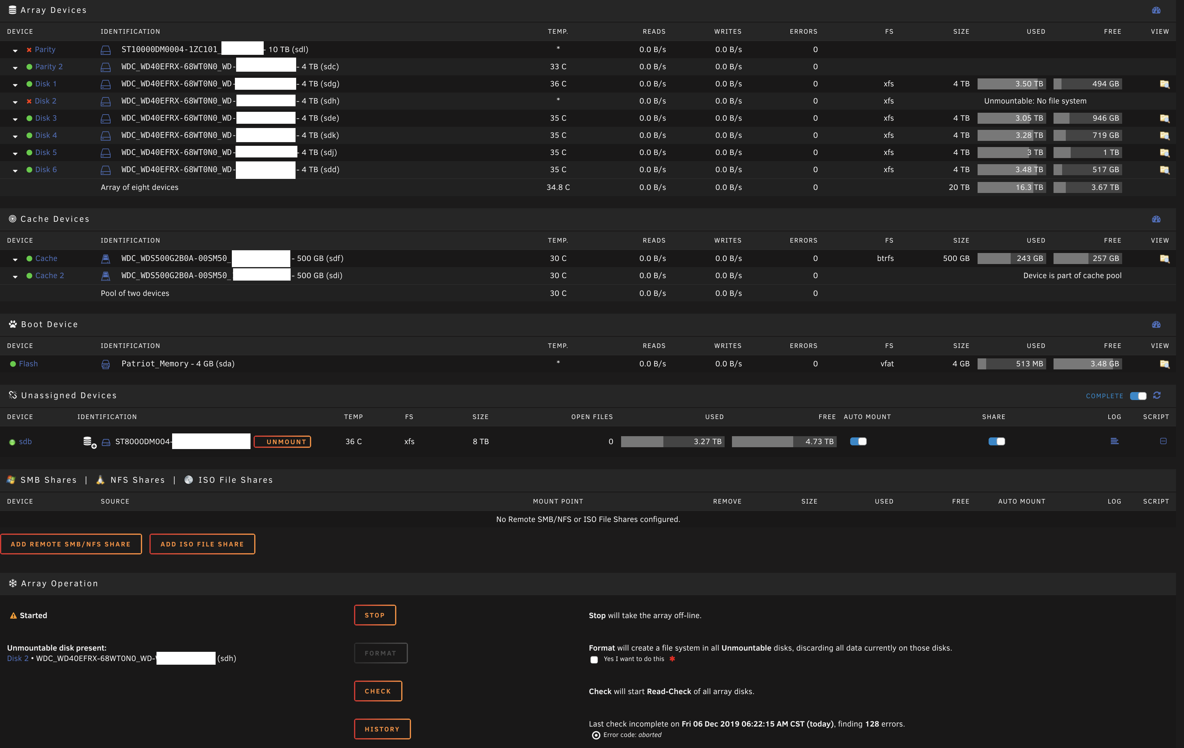

- I shut down unRAID. Checked my cables, removed and reseated the Dell card. That seems to work.
- unRAID boots, now the rest of disks seem fine again, except Disk2 is "unmountable: no file system".
- I clicked Start the array, but it wants to format Disk2 first.
Should I format Disk 2, or try a new config like you said? Seems like both roads lead to a parity check.

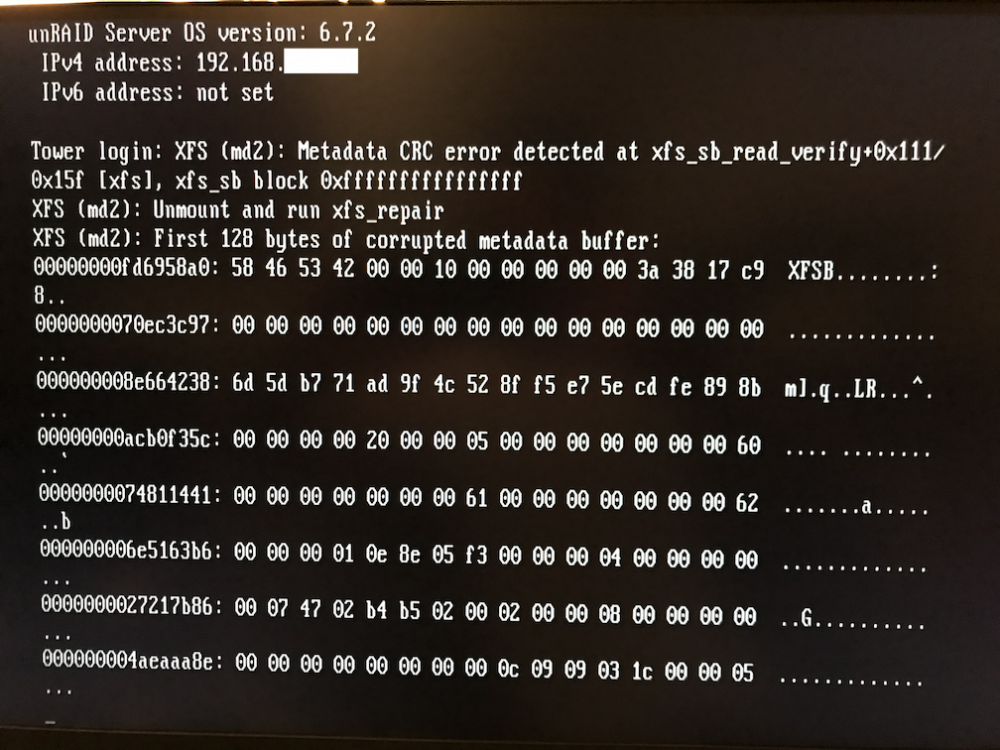

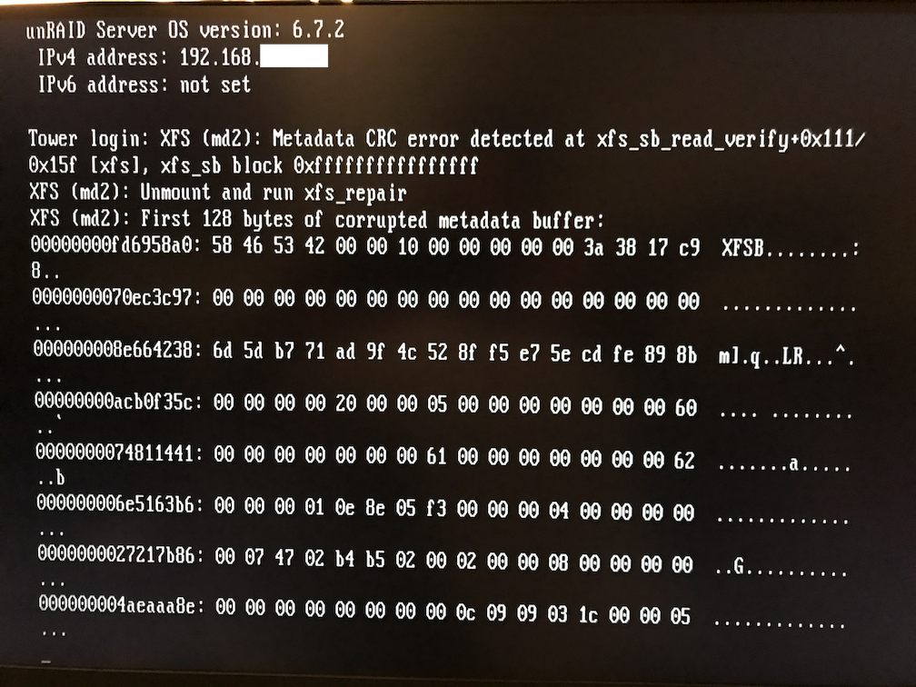

Also I'm seeing this on the video output from unRAID.
Format is never a an option, unless there's no data on disk2, after a format data can't be recovered from parity, seems to be a common misconception.
You could try fixing the filesystem on the emulated disk2 first and if successful rebuild, but since there can be some corruption, and assuming nothing was written to disk2 once it got disabled, doing a new config with IMHO be the way to go.
