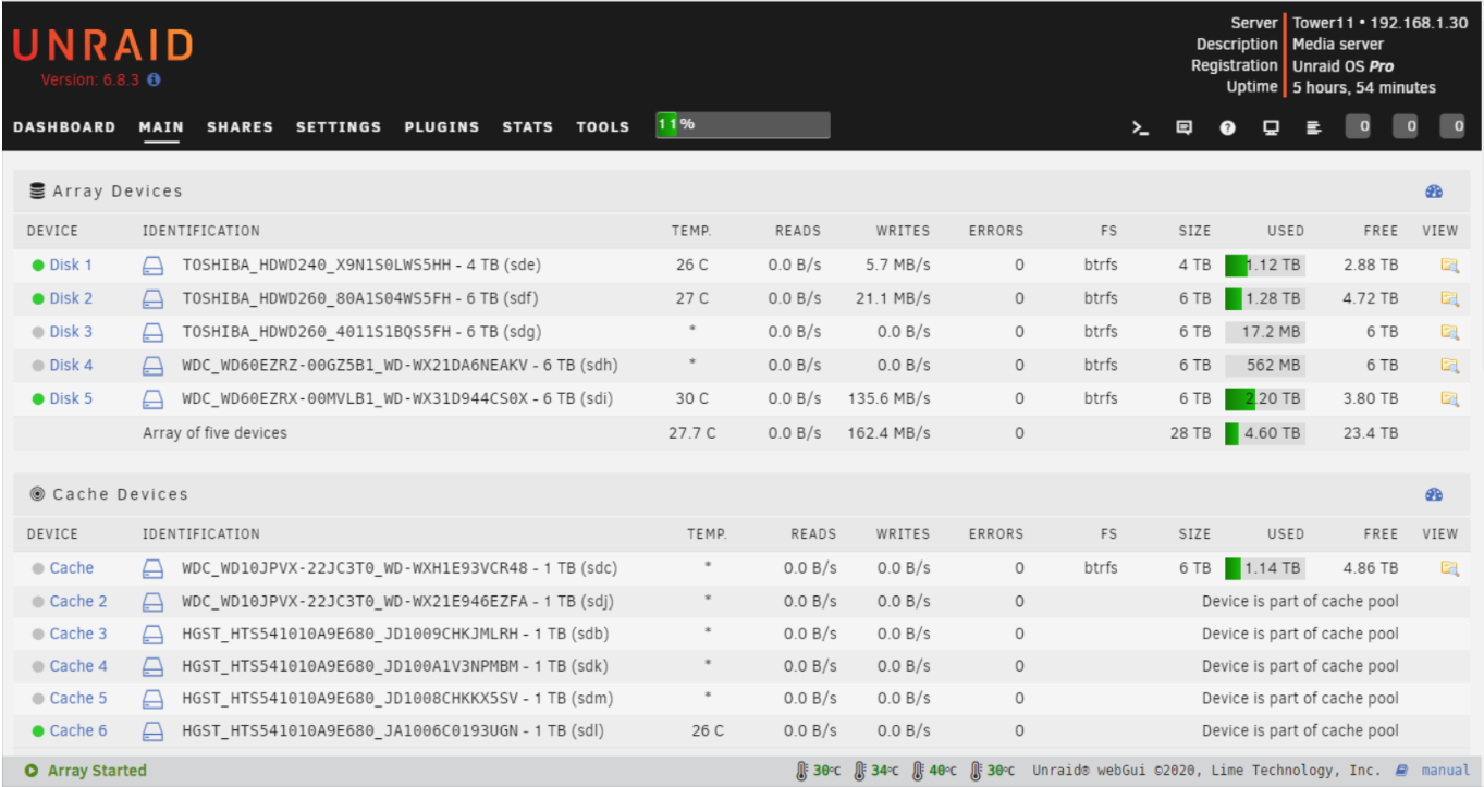

Here's an example of the slower SMR performance in some drives, due to a config change in one of my backup servers I need to re-transfer all the data, when doing this I disable parity so I can transfer 2 or 3 disks at the same time, using 10GbE (due to the SSH encryption this CPU can only handle about 300MB/s), all 3 disks started transferring within minutes of each other and the 2 SMR drives are going noticeable slower, and the difference will probably be larger for the remaining two disks since there won't be such a CPU bottleneck.
One final data point, SMR (disk3) vs CMR (disk4), similar amount of data transferred, note the time and average speed differences:
