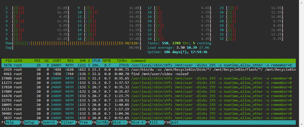

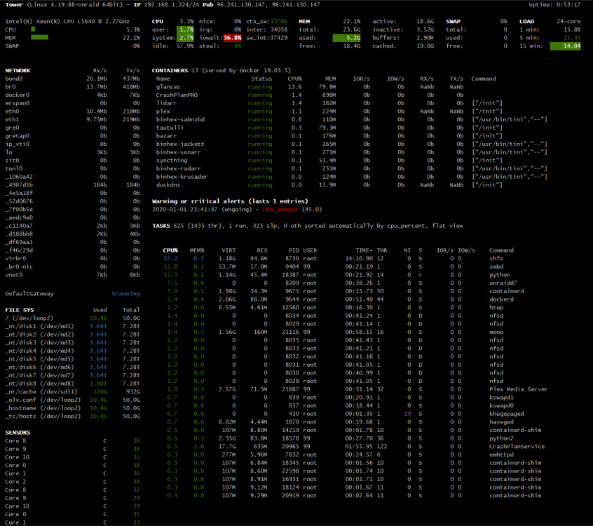

January 2, 20206 yr Allow me to try and explain this. A few days ago I upgraded from 6.7 to 6.8 and this problem has developed since then. I have tried the following solutions, I've shut down all VMs and Dockers, I've turned off the one external VM which has NFS mount access to some of my shares and I've even rebooted and the same command comes back persistently using a good quarter of my 24 core system. /usr/local/sbin/shfs /mnt/user -disks 511 2048000000 -o noatime,allow_other -o remember=330 No disk check is being done. No mover process is running. Last parity check came back clean. I know this process is not unusual at all and a number of them run at all times on the system. But *one* of them is constantly sucking up a good quarter of all my CPU for reasons I can not seem to isolate. I've posted a screenshot and a dump of my current diagnostics, any help would be welcome in tracking down my rogue process or plugin that is doing this? Thanks! - Urbancore. tower-diagnostics-20200101-2301.zip Edited January 2, 20206 yr by urbancore

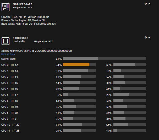

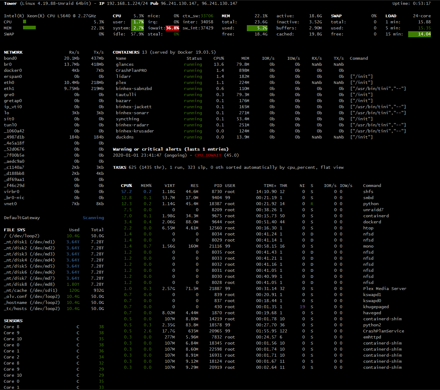

January 2, 20206 yr Author HTOP is wildly different then the web gui which I am adding here. Is this a web gui bug?
January 2, 20206 yr Author Marking this solved. So for those who are reading this with possible similar issues here was what the problem was. High I/O wait as shown here in glances caused the GUI to spit out a higher cpu use then htop or top showed. The cause of this was an external plex box I built for using quicksync hardware transcoding which was attached to the unRaid box via NFS which was doing library scans and thumbnail generation sucking up a ton of bandwidth (like 6/800 mbps) and that was causing the I/O delays. So apparently the GUI reads I/O wait as CPU use in some cases. I found this using Glances and Netdata dockers.

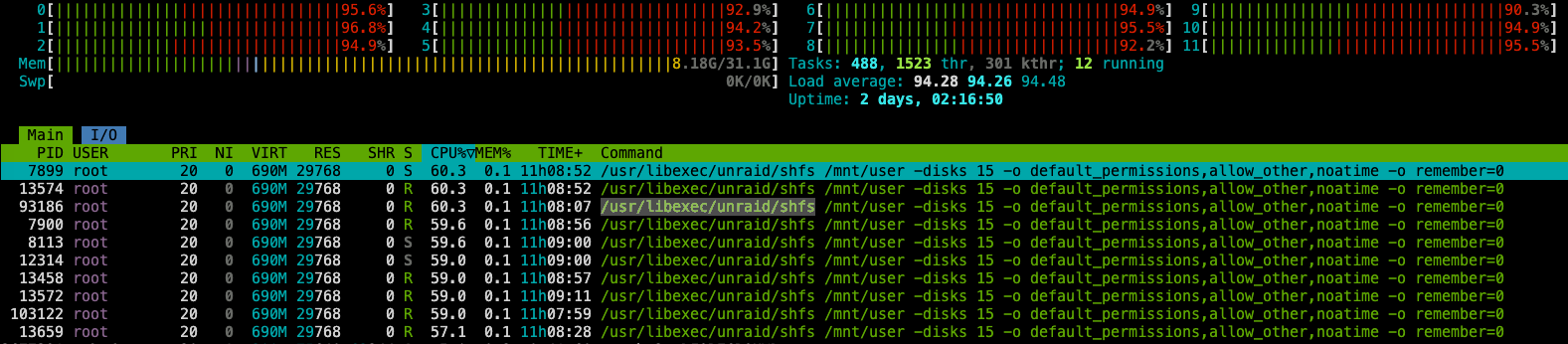

December 28, 20214 yr On 10/18/2021 at 11:49 PM, volcs0 said: I know this is an old thread, but I am having trouble sorting this out. Here is the command running: /usr/local/sbin/shfs /mnt/user -disks 511 -o noatime,allow_other -o remember=330 It's using up almost all my CPU. I don't have anything set up like described above. How can I sort out the source of this problem? did you ever solve this? I've got a similar one /usr/local/sbin/shfs /mnt/user -disks 15 -o noatime,allow_other -o remember=0

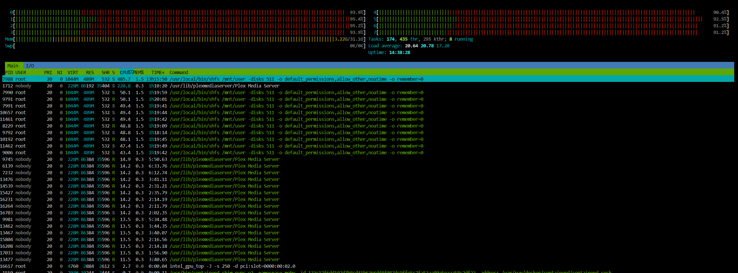

June 25, 20233 yr I've just come across this issue after upgrading to 6.12.1 yesterday. I've never seen it happen before. It turned out to be Jellyfin in my case causing the issue. As soon as I stopped that docker, my CPU usage dropped from maxing out all the cores to a steady 20%.

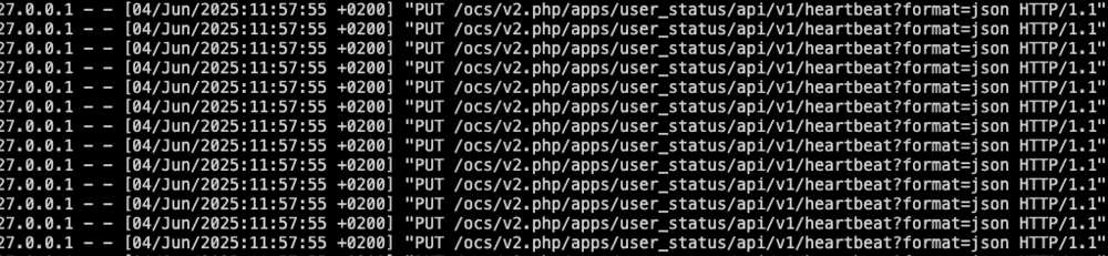

June 4, 20251 yr here the same issue. Noticed high powerusage on my machine recently. I upgraded to 7.1.2 in hopes it would resolve it. First I discovered a plex transcoder process being stuck on a single mkv file. after removing it and restarting plex I noticed shfs taking up a lot of cpu. Restarting the server doesn't help. CPU usage builds up slowly in a few hours max. Any help would be appreciated. I'm going to shut down a few dockers, trying to find the problem.edit:after some additional check I found out my Nextcloud docker is causing massive issues. Checking the log for this container I notice it being overflown with http requests for notifications and heartbeats...No clue yet how to fix this... To be continuededit2:ok, I resolved my issue by disabling the notifications and the user status application in nextcloud (inside nextcloud go to active apps, there disable both apps)my cpus are idle again Edited June 4, 20251 yr by RezzZ nextcloud was the issue
