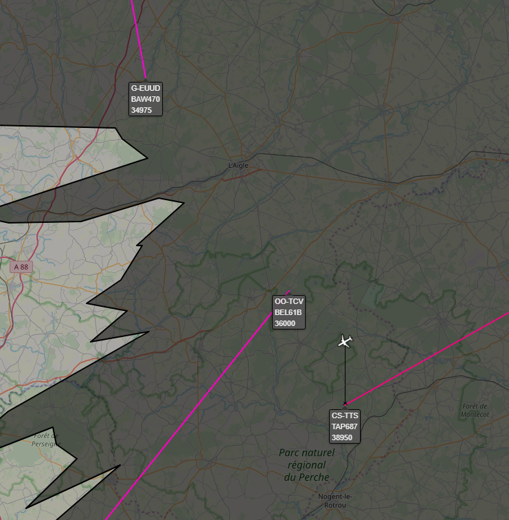

i got an issue with silhouettes dissapearing since the latest update, i just got flight traces and callsign/Reg/alt box, everything was working perfectly before. Any idea where it might comes from ?
Check your admin ui and make sure that "/opt/vrs/Flags/" and "/opt/vrs/Silhouettes" are in there
But my guess is you are mentioning the markers and plane icons on the map.
I don't run VRS anymore (moved to modes mixer) but I spun up my old container and noticed the problem.
Not sure if its a Mono thing (I use latest..) so I'll revert back to an older Mono and see if that changes anything!
Fixed it.. went back to Mono 6.0.. works perfect now ;)
Yes perfect ! Thanks a lot.
Looks like i spoke too fast, curiously some a/c are still missing markers. That did not happen before.
Edit: if i click at where the a/c is supposed to be, the selected yellow marker appears along with alt line and dissapear again if i click elsewhere.
It might be related to some picture handling issue as the a/c pictures (those top right) which had also dissapeared are back.
I did a quick check the same PNG could be perfectly fine for an a/c but not for another one, only change is the rotation.
No a/c marker, just a blank png: images/web-markers/top/Wdth-40/Hght-112/Rotate-330/Alt-70/CenX-20/WTC-Medium-2-Jet.png
a/c marker as usual: images/web-markers/top/Wdth-40/Hght-112/Rotate-200/Alt-70/CenX-20/WTC-Medium-2-Jet.png
in the log:
libpng warning: iCCP: known incorrect sRGB profile
libpng warning: iCCP: cHRM chunk does not match sRGB
might be an issue with incorrect pngs having troubles being handled by an updated libpng.

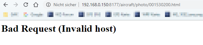

for a few days I have had the problem that the plane pictures of a plane are no longer displayed.
If I click on one of the not loaded images, I get a "Bad Request - Invalid Host" message.
How could i solve the problem?
