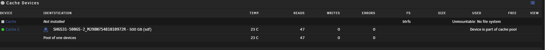

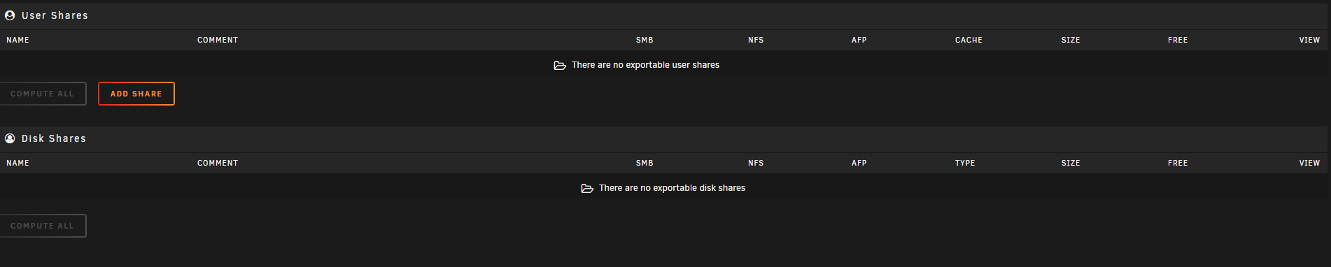

Still getting my feet wet with Unraid.  Ran into a problem today  and not sure how to fix it.  I had a 2TB Sata drive and at 500G SSD set up as a Cache pool.  It was only my intention to use the 500G but since I was porting over my old media server I thought adding the 2TB drive would help with getting things up and going faster)  Per one of Space invader One's tips videos I did something with some of my shares (Not data but other system type shares and I can't find out as the shares are no longer there) as luck would have it the 2TB drive died today.  Now I Lost all my docker containers such as Krusader/Plex etc as well as my share information.  as expected when I browse to my shares over the network none of my shares are accessible.
I'm hoping I'm not screwed and have lost all of my data. How can I recover from this?

Cache appears to be non redundant, when was the pool created? There was a bug with v6.7.x that resulted in a non redundant pool.
I probably built it about 45 days ago (used 30 day trial and extra 2 weeks and then it ran for a week maybe before I upgraded with a purchased license) ago and I see 6.8 came out early December so it is very possible I built this on 6.7.  If I did how screwed am I?
Edited by Arcadejunkie
See here for some recovery options, but if one drive is really dead it might not work if there's missing metadata on that drive, 50/50 chance.

Your array disks and their data should be fine. Your docker problems are because dockers are on cache by default. If you remove cache and start the array the user shares on your array disks should be accessible.
You have possibly the largest number of files in config/shares on flash that I have ever seen. Did you really have 188 user shares? Did you intend to have that many?

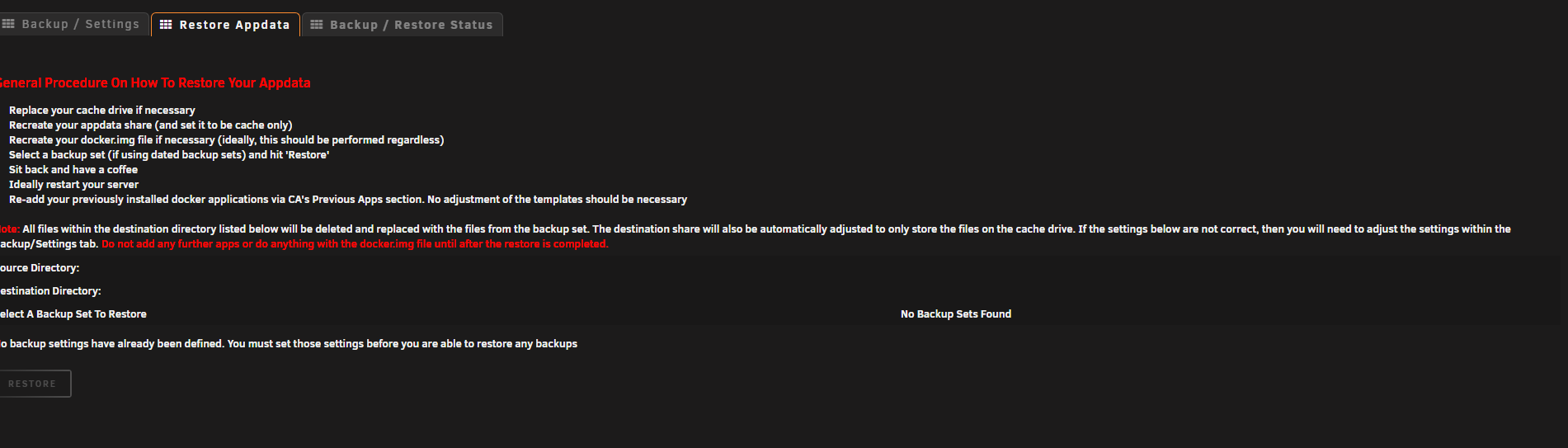

LOL this keeps getting better and better.....As I originally stated I'm still getting my feet wet.  I just looked at CA Appdata backup and it says no backups found so
no.....something happend when I was moving things around in Krusader and when I moved things to a root dir it share them all out.  That was on my to do list to figure out for today before the drive crash
Because the settings in backup aren't there...  Without reading through the thread, did you redo your flash drive?  If there were settings already, they would be listed in that screenshot next to source / destination

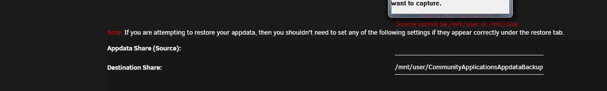

You would need to verify the source and destination on the Backup Section of the plugin.
There is a destination but no source
Your "source" is where you want it to go on the restore (or in the context of the backup page, its the appdata share you're backing up).  Without a "source" on that page, presumably the restore section isn't populating any results because as far as it's concerned you've never set up the plugin in the first place.

Ok I think I follow you but what should I set the source up to then?  I have

Where do you want the appdata to be stored now?  That's where you set it.  ie: /mnt/disk1/appdata
Under Disk 1 I already have an appdata folder however if I select that it says all data will be overwritten.  I assume this is from before. Is there a way to pull that data?  Or do I just choose to put it there and overwrite things?  Sorry.....trying to prevent the least amount of data loss as possible and trying to understand how this OS works at the same time.
