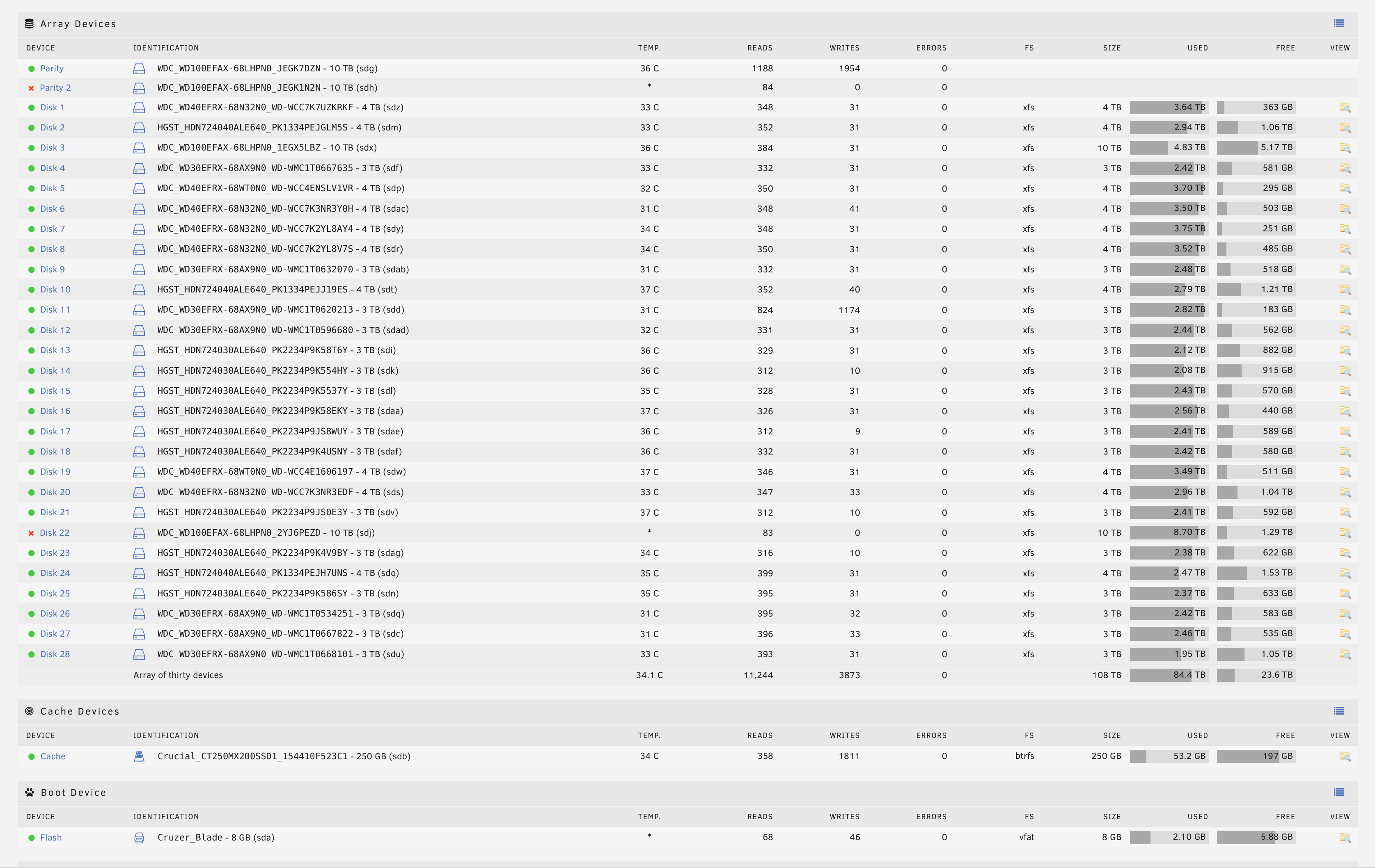

I am starting a new topic because I have a damage unraid (one disc with error, and one parity disc with error).
I am not very techy sadly, quite a newbie...
If anyone can offer some help on how to proceed, then I would be very happy.
I have added a photo of the array, and a diagnostic.

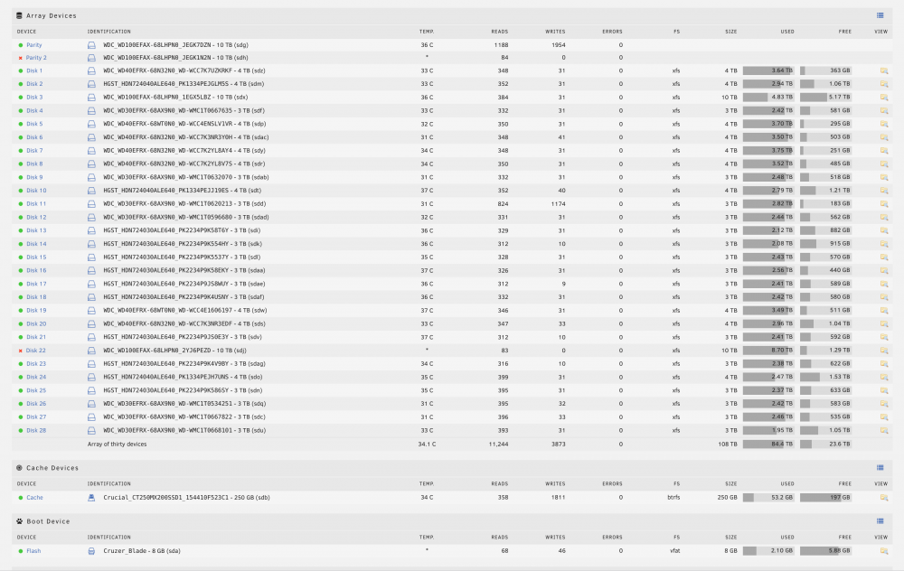

Discs look okay regarding SMART warnings in Dashboard. Photo enclosed.

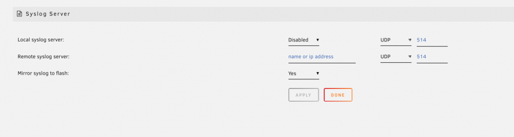

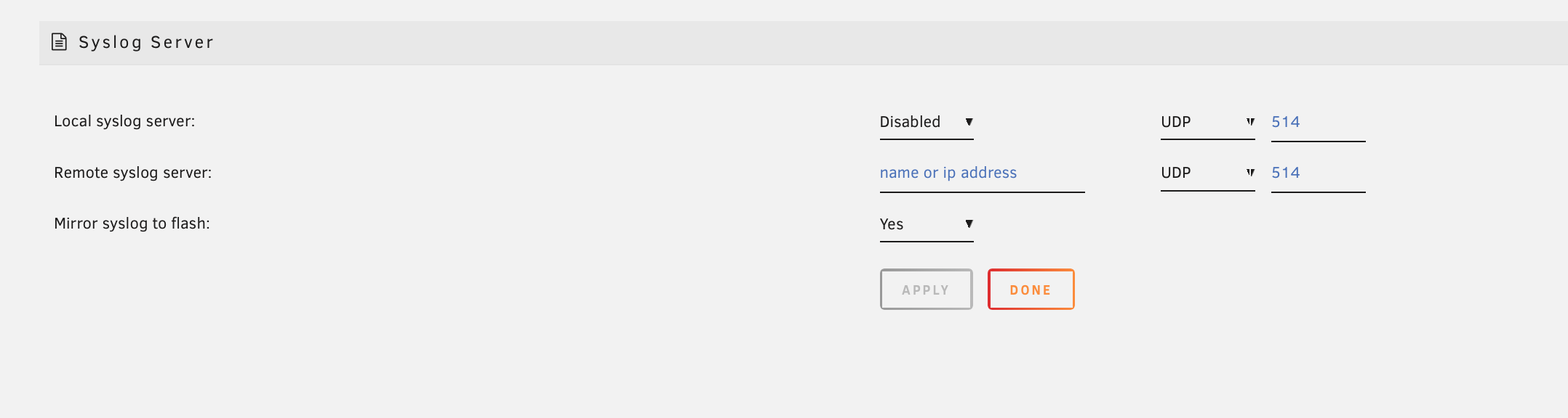

Syslog Server is setup, yes. Photo enclosed.
If it was setup then it will have saved syslog from before boot. You should attach that to your NEXT post so we can maybe see why the disks were disabled.
You're using SASLP controllers, these have several known issues, including controller crashing and dropping disks without a reason, can't say for sure without the syslog but likely what happened here, since both disabled disks are on the same controller, though it could also be a for example a cable issue, in any case and if possible I suggest replacing them with LSI HBAs.

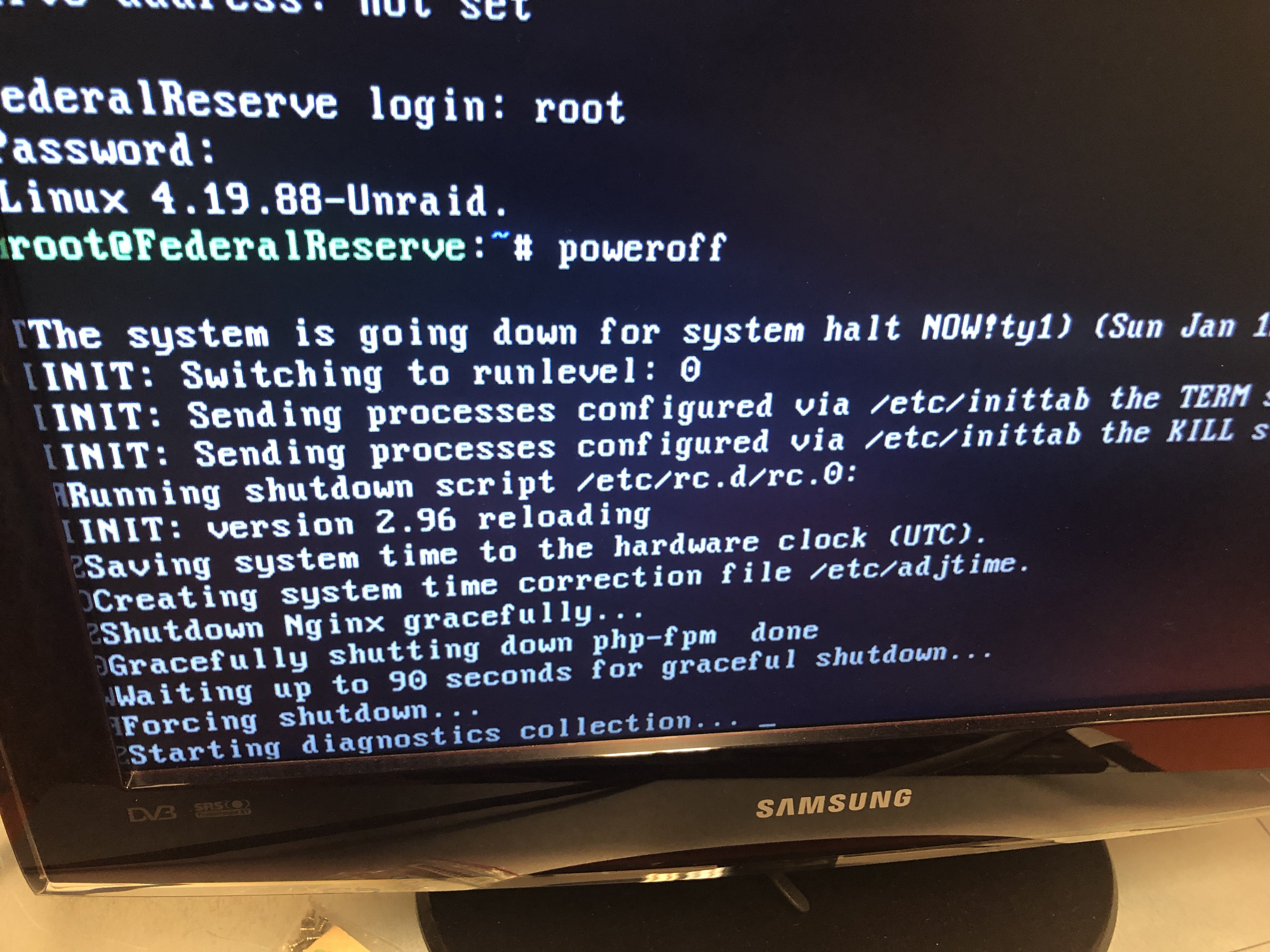

I was on a 2 weeks trip, this happened before I left. I think I made a diagnostics before I left, I am adding it here (2x diagnostics in a zip file). And I made a photo of the screen as I tried to power down the raid at that time.
For the syslog, will I have to power down the unraid, and remove the usb stick to find the syslog before boot ?
