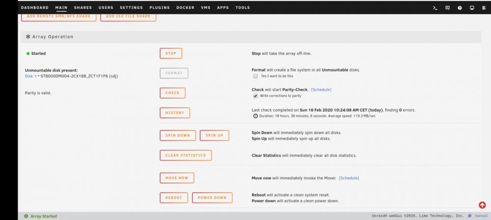

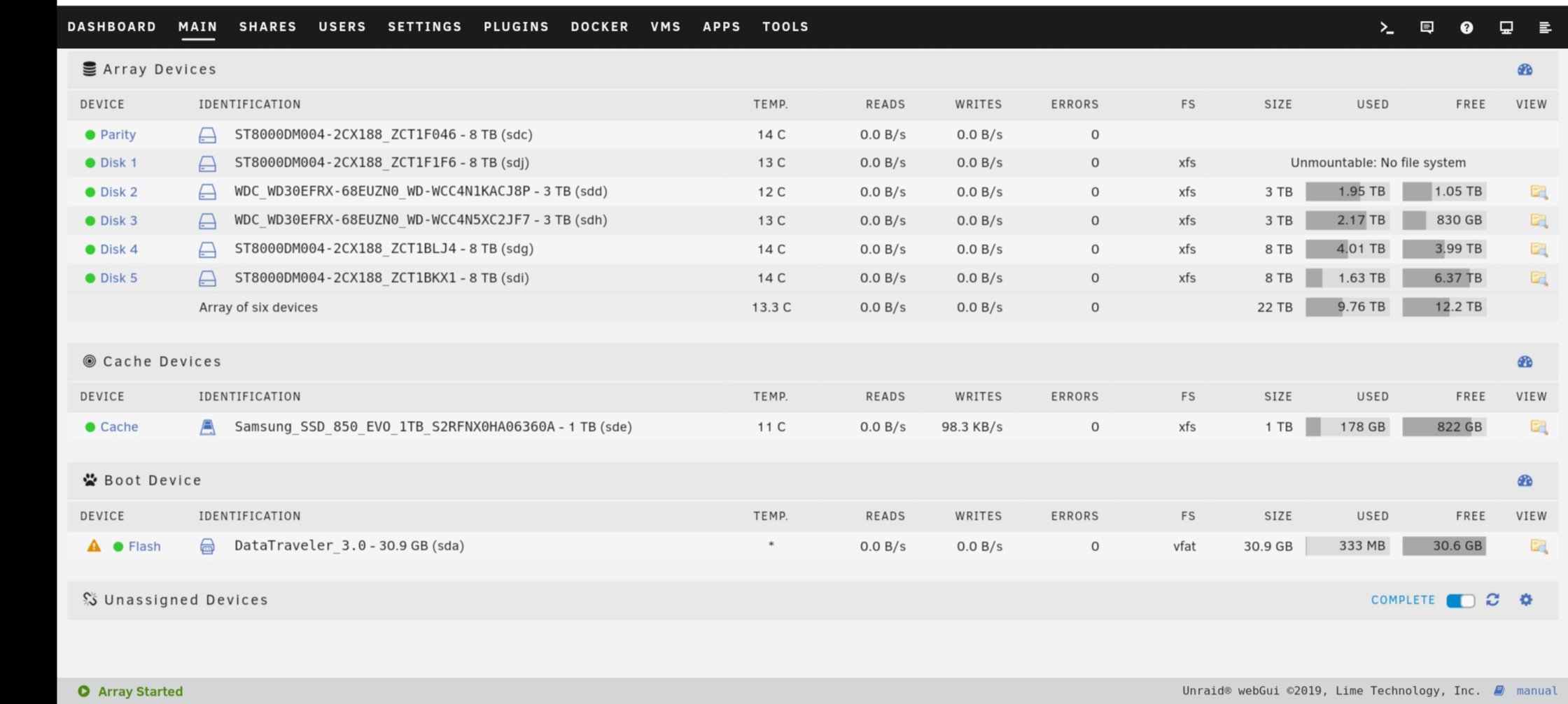

Have you rebooted since the rebuild? If not, don't. Post a screenshot of Main - Array Devices.
31 minutes ago, trurl said:
Looks like you have a corrupted filesystem on disk1, and it was that way in both the "before" and "after" diagnostics.
Attached. Haven't rebooted
Doesn't look like there were any I/O errors during the rebuild, and I didn't see any in the diagnostics, but there was some clutter in the syslog so I wanted to check. Do you have multiple browsers or browser tabs open to your server, including mobile? That would cause the clutter I was seeing. (csrf token)
So, you need to repair the filesystem on disk1.
Stop the array and start it in Maintenance mode, then click on Disk1 to get to its page and Click the button to check its filesystem.
Capture any output and post it.
