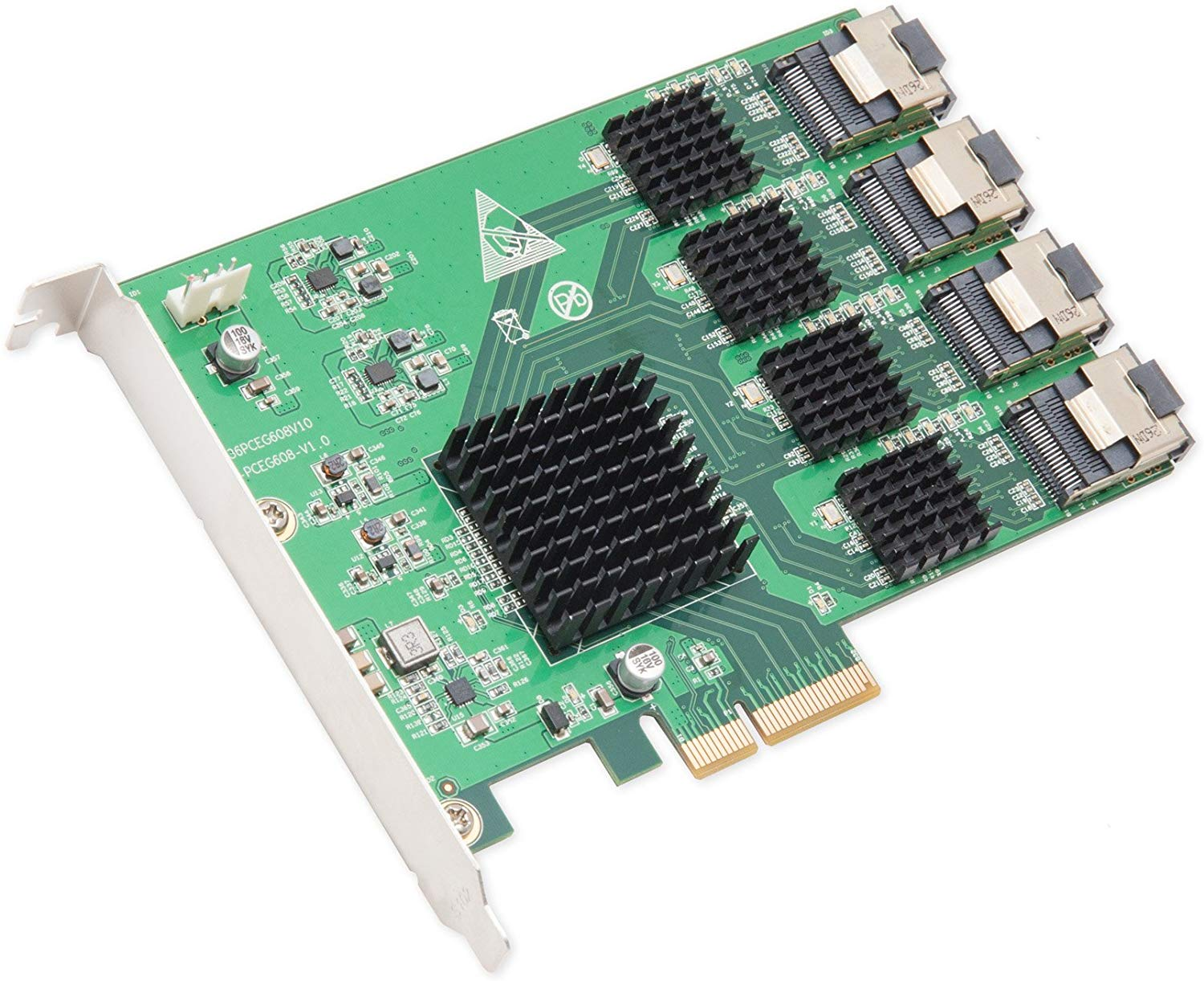

So, we wanna get this one, it has 16 SATA ports

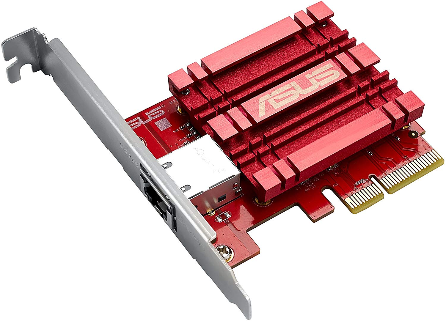

And then, we need 10 Gbit connection, so we wanna get this one
So, my question here is, is there an Expansion card wich can have both in the same card?, We really dont care about the size, or the pci connector lenght, as long as it fits in the same PCI-E port, we will be happy. After all, if you add the number of lanes that each card uses, its about X8, and we prefer to use a X8 port, than two X4 ports

That sata card you posted is a IO Crest SI-PEX40097
Couple of problems
#1 - Its a PCIe2.0 x2 card.  You will most likely run into bandwidth issues with it during parity checks / rebuilds etc when it starts getting full of drives
#2 - Its a Marvel based controller.  These are problematic at the best of times, and aren't particularly recommended.  You're always better off with an LSI based card
#3 - The Marvel 9215 only supports 4 sata ports.  I'd surmise that the board also has 4 port expanders on it, so you're into a double whammy on bandwidth and reliability / compatibility
#4 - I wouldn't particularly consider IO Crest to be anything but a bottom of the line manufacturer.  Even if everything else above wasn't a factor, their products would still be considered very low end
Don't cheap out on this.   You're only going to wind up having to buy a real card soon after buying this one.

You are not going to get a card that does both. They don't exist, and even if they did I'd not want to have to hunt one down during an emergency.
Getting back to 10 GB networking... you need to decide between fiber or copper. Each has it's strengths and weaknesses, I prefer fiber for 10 GB.
Copper
https://www.newegg.com/intel-x540t2/p/N82E16833106083?Description=10gb ethernet&cm_re=10gb_ethernet-_-33-106-083-_-Product&quicklink=true
Fiber
https://www.newegg.com/p/14U-0036-00165?Description=10gb ethernet fiber&cm_re=10gb_ethernet_fiber-_-14U-0036-00165-_-Product&quicklink=true
You also need the infrastructure to accept 10 GB. Switches, etc.
For the SAS card... LSI. End of story. For your situation, two of them.

If you want a 16-port card that will actually work trouble-free with unRAID something like this is a much better option. It's x8 PCIe.
As to your original query about 16-port SATA and 10G network on the same card, I highly doubt such a thing exists.  It would have to be an x16 PCIe card.  I have personally never heard of or seen such a beast in existence.   That does not mean someone is not hiding one somewhere in captivity. 😀
