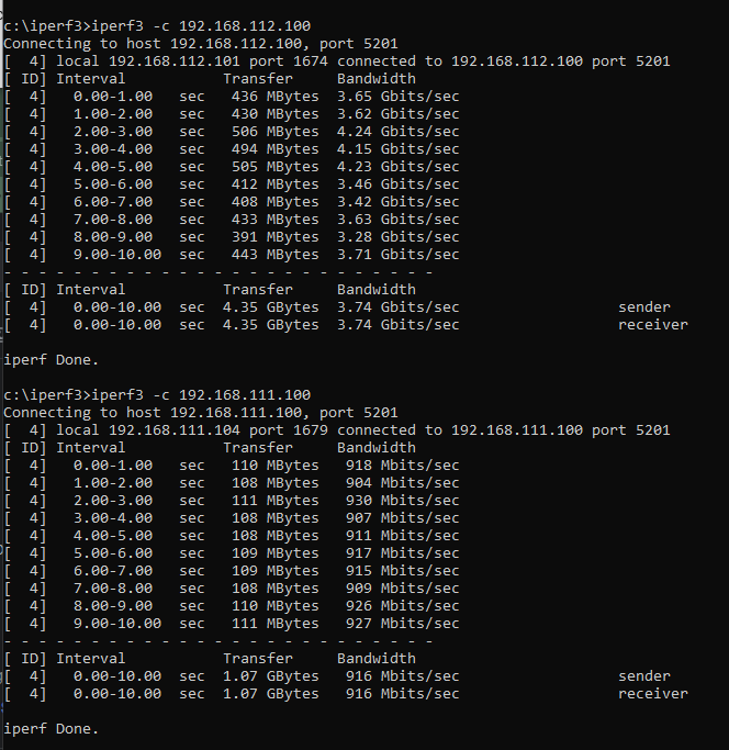

December 27, 20214 yr Ok, I am hitting this topic BECAUSE several people here have Dell HN10N cards and have reported good results. I actually happen to be using other dell hardware, but that is irrelevant. Dell Optiplex 7010 (Windows 10) to a Dell Precision T7500 (UnRAID) over the HN10N cards... believing I had everything configured properly with the 1gb nics connected to my switch in the 192.168.111.0/24 subnet and the 10gbs directly connected using the 192.168.112.0/24 subnet. I am averaging in the 110MB/s no matter which ip I transfer files over, and things I have changed in windows trying to simplify it down (like going bare bones with just Client for MS Networks/file & printer sharing/ip4 protocol only) made things worse, not better. I have pulled the plug completely from the 1GB line just to make sure it was using the right wire... and actually replaced the 10GB cat7 cable too... that seemed like it could have been it... it was not. Really, I thought it was Windows trying to use bonding or bridging to something to "help" but it's just not making any sense at this point. SO, can anyone suggest and troubleshooting techniques to "see" what is going on? In both UnRAID and Windows, the connections are "reporting" at 10GB, and I am reading from SSD to SSDs... so I expected to get better than the exact same throughput I was getting over 1GB... (max 120MB/s but average 110-ish... and heck 72 to my un-cached media share) And here is what I am getting to the to ip's from iperf... Any and all insight/help would be appreciated, and if there is somewhere else I should look or post please advise! TIA -g Edited December 27, 20214 yr by Garbonzo added image

December 29, 20214 yr Thanks for the response (I had already typed this yesterday, but wanted to make a couple additions before I posted, and then lost the tab) Anyway, that -R is interesting... I had overlooked that, and when I tried to make the windows run in -s mode and the -c from unraid I kept getting this : iperf3: error - unable to send control message: Bad file descriptor So the -R switch let me see that I am getting between 15-50 re-transmissions when going that direction. I am not sure if that is real or if the windows ver 3.1.3 just doesn't have that info and the ver 3.9 on unraid does (II haven't googled it yet) Anyway, in my other (lost) post, I mentioned that I wouldn't be able to move the card from my windows pc to another machine OR boot to a linux usb until this weekend, but I think I can take things down and do it overnight tonight (wed/thr). So hopefully some file copies from that will tell me a little more, I will plug another ssd in as well to perform the copies from... So if you have any other tips for testing things they are VERY welcome! Thanks again! -G
