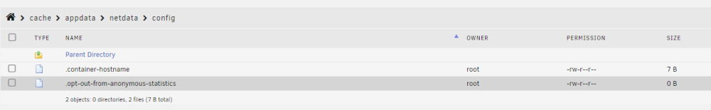

I installed the netdata container a few weeks ago, and it appears that the collected data isn't persisted prior to my most recent reboot of my server.  Where is the database supposed to be stored? I don't see anything in my `appdata/netdata` directory except the `override` folder, and all the subfolders inside are empty
The only thing mapped to appdata in the docker image is
/etc/netdata <-> /mnt/cache/appdata/netdata/override
Edited by veri745

On 5/10/2023 at 11:58 AM, veri745 said:
I tried mapping both
/var/lib/netdata
and
/var/cache/netdata
as specified in the Docker Compose instructions to my appdata folder, but neither would let the container start
You happen to install right before some significant changes to the template and image. I would suggest removing the container and reinstalling from the community app store. Afterwards, you can copy configuration files from /mnt/user/appdata/netdata/override to /mnt/user/appdata/netdata/config.
These are the new folders for persistent data
There are also now environment variables to enter a netdata cloud token and room ID. Let me know if you run into any trouble.

I reinstalled and used those default mappings.  There does not appear to be any write activity to any of those mapped directories.
The config directory remained complete empty.  I copied over the data from my "override" folder, but that doesn't seem to make any difference.
I would just go ahead and use the official netdata docker, but the template for that image is completely empty, too
