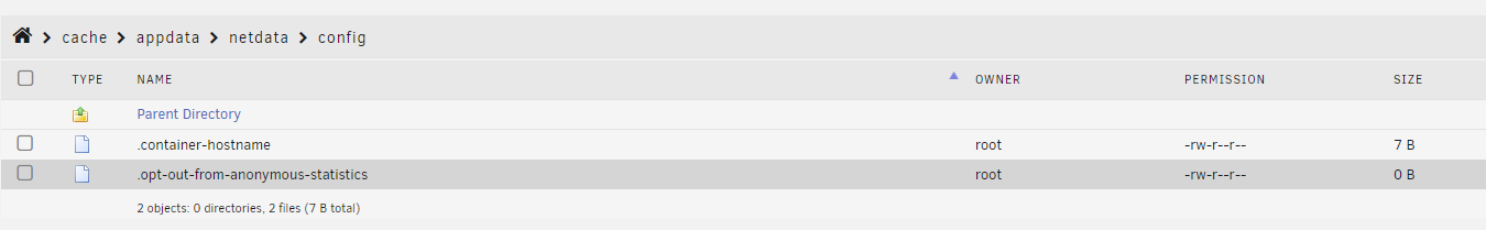

25 minutes ago, D34DC3N73R said:
/mnt/user/appdata/netdata/config will be populated on first run with the following folders & files:
The only files created are `.container-hostname` and `.opt-out-from-anonymous-statistics`
I did get a bunch of folders and a `netdata.conf` when I installed the `stable` version, but not with `latest`
I moved my entire netdata appdata folder to netdata.bak and started from scratch, but I'm not able to reproduce that with the latest or stable images and the current template from CA. Do you have auto-updates enabled? Is it possible you're using old images? Can you confirm it's running netdata v1.39.0?

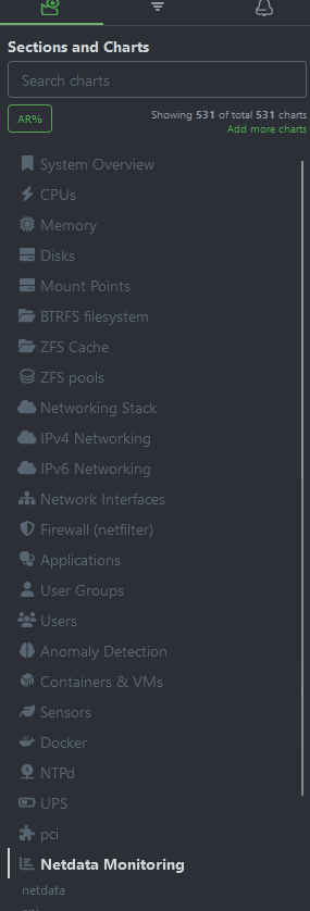

Ran through this without any noticable issue, but still not seeing it in the dashboard after rebooting Netdata. I can run nvidia-smi from inside the container and get results, but nothing on the dashboard.
Edit: after waiting about 5 minutes, its now showing in the dashboard!
